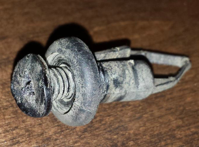

    So I've searched this forum and the interweb and cannot find what I need.
    So thanks in advance for the help.
    So what is this called? and where can I get some replacements?
    They hold the bumper cover to the upper retainer.

    you can find them at almost any auto parts store. If you google "auto parts store push clip", you will find tons of pics, suppliers, ebay ads, etc....
    edit: now that I look at your picture closer, it looks like yours has a philips head screw top. replace the google key words above with "auto part store screw clip" and you will get some results. Looks like NAPA carries them.

    Thanks. The local autoparts store had some...but not the right size. : (

    Stuff like this can be pretty cheap. It's a plastic clip, so maybe you'll need to buy a pack of ten. It will do the best job fitting snug and lining things up, I'll bet.

    Had some on the bottom mount tabs strip out. They get filled with gunk,,and when you turn the screw to back it out, it rips the threads trying to force the crud thru the threads,,or it burns the phillips socket off the head.
    Found the same style plastic anchor/metal screw setup at the local Ace Hardware. Well, I swapped out the plastic screw that it came with, for a metal one.
    The ebay deal is better, but I only needed 2.
