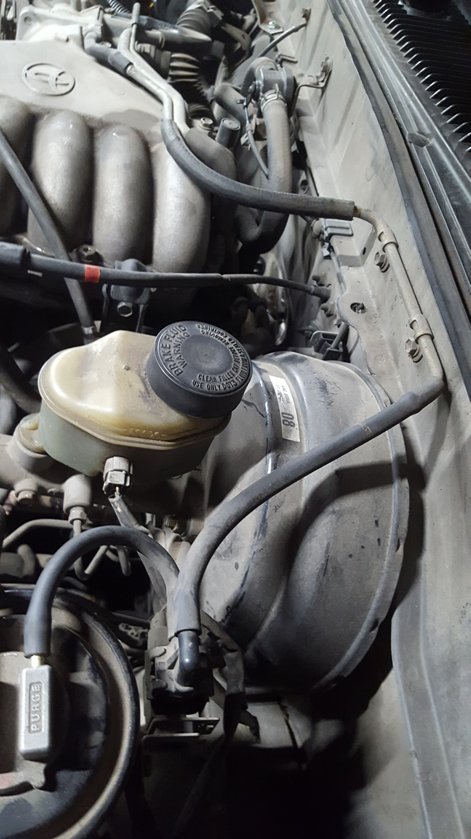

    So when I popped my hood to start replacing my fuel filter yesterday, I noticed this hose had disconnected (see photos, I had reconnected it in the first photo). Looks like the pipe comes from the air filter box and the other end goes to an unknown (to me) box. I had to run to store to grab some flanged m8 x 1.25 bolts and grabbed a replacement hose as both ends had split and the one had come loose.

    Looks like part of the evaporative emissions system.

    Um... yeah. I believe that's part of the EVAP system. Which will throw codes and a check engine light. Someone correct me if I'm wrong.

    I have now googled what an EVAP system is... makes sense. It hadn't thrown any codes (although the airbag light has blinked slowly since I bought the truck) but It should be right as rain now. Anyone know anything about the fuel filter question?

    That line is part of the EVAP system, but it’s not as important as you think. It is a filtered air inlet into the charcoal canister, which is why the other end of that line attaches to the filter box. It will not cause a check engine light by having that line removed.

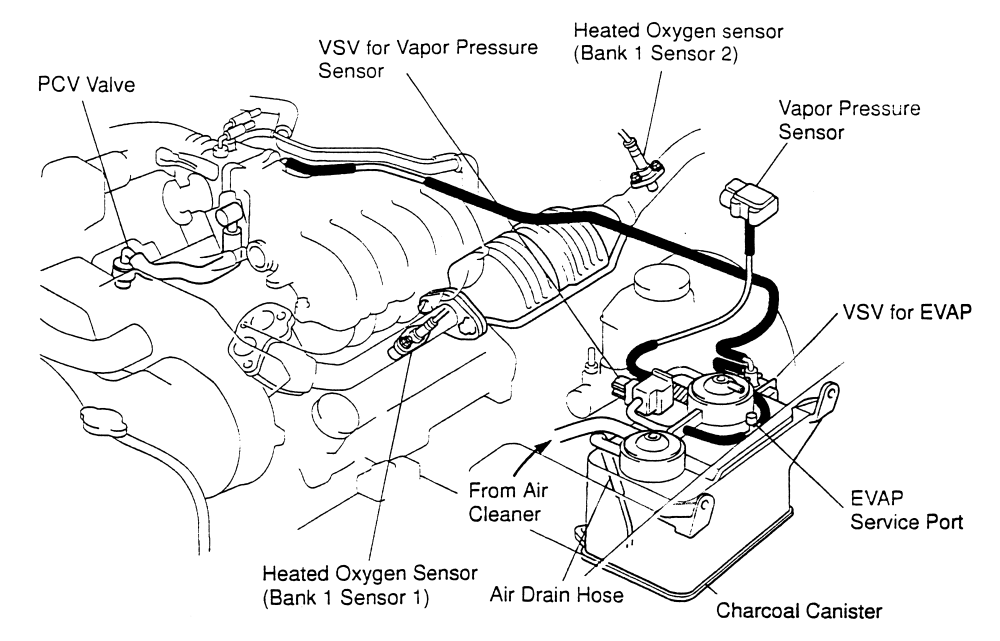

    There may be a hose diagram under the hood. As you can see, one end terminates at the evap box, the other end might be at the air filter box.

    Evap line, just buy a replacement from a hardware store.
    No special procedures after a fuel filter. Some people cycle the key a few times, but it will start just fine.
    It's the "from air cleaner" line. This sticker might be on your hood.
