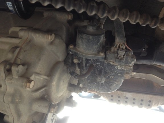

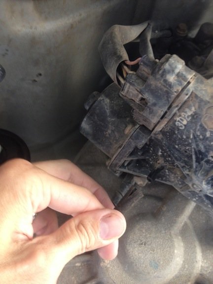

    My truck is a 5vz-fe. I was under my truck today changing my fuel filter. I looked over at my T-case and saw this hose hanging off what I think is the motor/actuator. The hose is old and cracked and slipped off. I chased it with my hand and it seems like is connects somewhere on the top of the T-case.
    In the pic I am holding the hose right by where it connects (male end on right). What is it for? Is it vacuum? I haven't had any problems with my T-case lately, but it looks like the hose has been detached for awhile, so I would expect something?? Thanks.

    Hmm. It doesn't come directly off the T-case, but the actuator instead.
    But since I haven't had any trouble, it probably is the breather? I'm attaching a better pic.
    It's the curved hose in the center of the page, that is wrapped with tape on the left side. Comes off the black part, goes above the T-case and attaches again either at the front of the T-case or the back of the trans, at the top.
