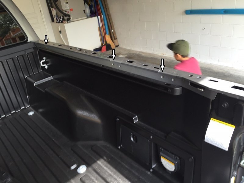

    Saturday when I picked it up I found out my factory tonneau cover bed rails will need to be replaced. I can only get 3 out of 4 clamps to work. The shell sits on 2 of the little arms that sick out near the tailgate. The clamp for the passenger side front doesn't line up for the tonneau cover bolt :frusty:. So I'm rolling with 3 clamps currently which would still work. Maybe I can put a thicker weather seal around the bottom of the cap to prevent from sitting on top of two little arms.

    You can unscrew those little arms out.

    Here is a picture what it looks like under those plastic rails. Yes you’ll have to remove your cap. Then pull up on those plastic rails. Then you’ll see those two screws to remove that post.
