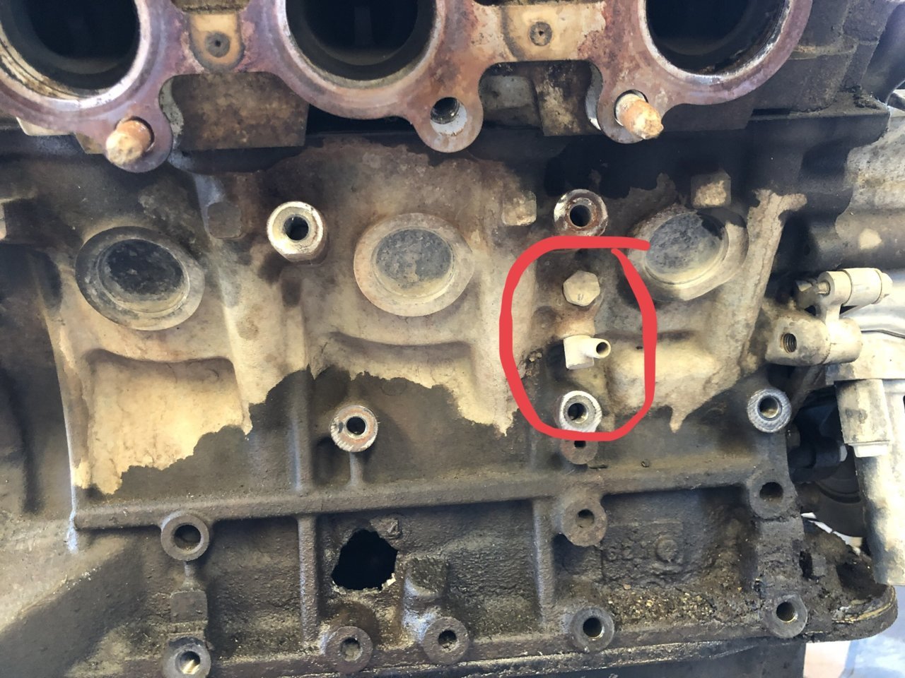

    I spent the afternoon moving over brackets, sensors, etc from the old engine to the new longblock. I came across something I'm not familiar with. What is the function of this tube on the right-hand side of the block?
    The tube is not present on the new engine, but the bolt is there and also the hole where the little tube is on the old engine.

    Can it be a coolant bleeder? There’s a bolt above it.

    I think you're correct! I googled a bit with similar terms and found it mentioned when draining coolant.
    Thanks!

    Yeah thought so. The Honda I just worked on had something similar to drain the block of coolant.

    block drain for coolant.

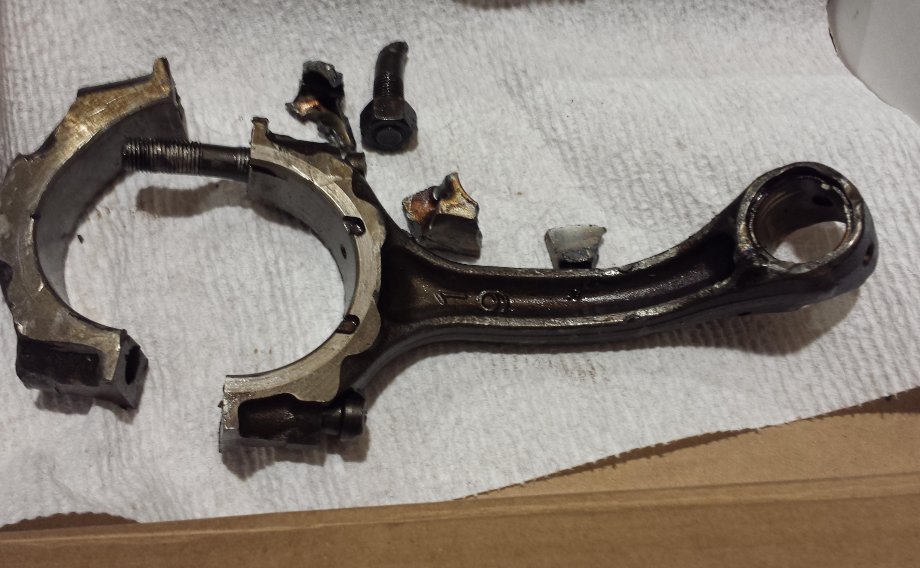

    Out if courosity. What were you doing or why did it vent the block?
  9. Jul 28, 2019 at 8:48 AM
    cruiserguy
    cruiserguy Well-Known Member
    Jul 31, 2016
    #193416
    19,000
    Elijah
    SEKS
    2000 ext cab, 2.7L, auto, 4x4
    I think he had a rod go through his block so it looks like he's just swapping engines
  10. Jul 28, 2019 at 9:26 AM
    mechanicjon
    mechanicjon They call me "Jonny Stubs"
    Dec 2, 2016
    #203828
    10,149
    Jon
    Scottsdale Arizona
    04 Taco SC 4dr SR5 TRD Prerunner
    Supercharged, AEM FIC/6, Meth Inj, ION Alloy's, Radio & Phone steering Wheel controls,Fabtech AAL, Billie's wrapped with 880's , Tundra big brake conversion, bully bars and Pioneer DDin Stereo/dvd with exterrnal usb ports. 290K and going strong.
    That's obvious. I was wondering if it was over revved or what.
    cruiserguy[QUOTED] and CS_AR like this.
  11. Jul 28, 2019 at 9:33 AM
    CS_AR
    CS_AR Well-Known Member
    Apr 3, 2019
    #289019
    12,919
    1999 Tacoma PreRunner TRD
    Everything but the driveshaft. B03A - 410
    I've seen this happen along with hydro lock on another engine. I'm sure the OP will pull the heads to do full look to see what happened.
  12. Jul 28, 2019 at 9:34 AM
    dankgus
    dankgus [OP] Well-Known Member
    Jun 16, 2019
    #296543
    179
    Dan
    2002 3.4l Tacoma
    Not really sure what happened besides the obvious. We bought the truck for my son, he drove it for less than 2 weeks and it had a catastrophic failure. It had 217k miles on it. I'm no expert, but the engine sounded fine in the days leading up to the failure. I must have heard the truck startup and leave the driveway 30 times. I was not present when the failure occurred.

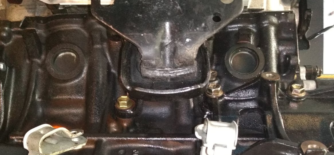

    I tried removing the old bleeder fitting, but it must be a single use press fitting. It's not coming out without destroying it.
    It's definitely not threaded because it can not freely spin completely.
    I'll live without having one on the new block, but it would be nice if it was complete. It's a part that would need to be installed before the engine gets installed in the truck, the engine mount and AC bracket will prevent it from being installed later.
    Any ideas on a part number or substitute? I'm considering just getting some brass or aluminum tubing and making a part myself just in case I ever want to use the drain.

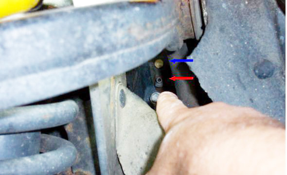

    Here's a photo of the block drain on my 1998 V6 engine...
    I tried to turn the bolt head but didn't have any luck, and the little pipe coming from below the bolt head was too short to attach a hose. I don't really worry about it though, for the amount of coolant still in the engine it's just not worth it.
