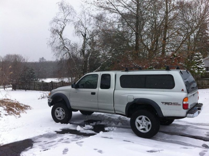

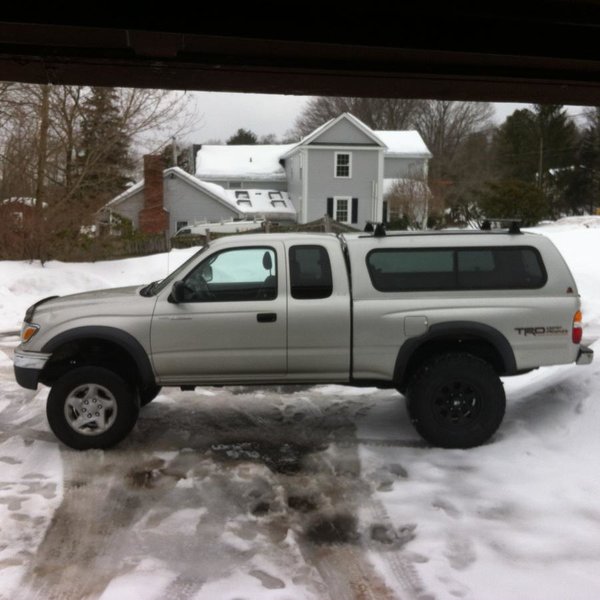

    So, anyway, here's how it stands as of 3/23:
    Here it is bone stock (bought with 163,000 miles from a dealer), hanging out with one of my other rides:

    This is a 2002 Toyota Tacoma 3.4l V6 4x4 SR5 w/TRD offroad package, 5 speed manual tranny. 178,423 miles as of this morning.
    Following is a list of the mods/maintenance I've done so far along with some commentary/pictures on/of each one that I hope will be helpful to those just starting out on a 1st gen Tacoma build. I will also be estimating the number of expo points each mod adds so I can have an ongoing assessment of the overlandiness of my truck.

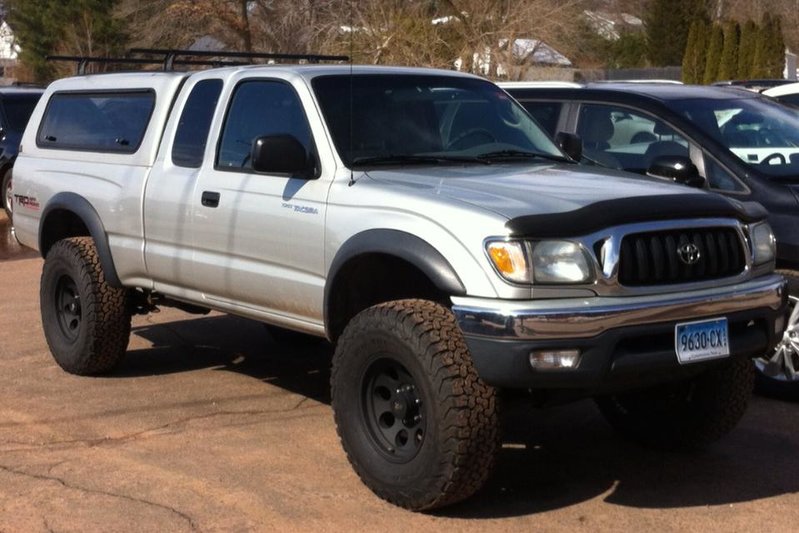

    -Bilstein 5100s set to 0" w/Eibach coils (167,xxx)
    Do not fucking set these things at anything other than 0" with the Eibach coils.
    I repeat, do not set Bilstein 5100s to anything other than the manufacturer's recommended setting for use with the Eibach coils you get from toytec.
    DO NOT SET BILSTEIN 5100s TO ANYTHING OTHER THAN THE MANUFACTURER'S RECOMMENDED SETTING FOR USE WITH EIBACH COILS YOU GET FROM TOYTEC.
    Ask me how I know, haha. I figured I'd push it a bit and install them on the middle setting when I first got these parts in. I was still starry-eyed and overzealous from buying the truck, and I was acting irrationally. With these coils on the middle setting, you might as well not have any front suspension. Hitting a pothole feels like your front end might get destroyed. It also nets you some reverse rake, which is dangerous and looks fucking stupid.
    With my lack of a big spring compressor, using the jack under the LCA method of compressing these springs (will never do again, I felt like I was seconds away from being nominated for a Darwin award the whole time I was working on it) this mistake cost me at least 12 hours of work and left me feeling like a moron.
    With all that in mind, I highly recommend these coilovers. They're reasonably priced and you can install them yourself if you're determined enough and have the right tools. The latter part is important, though. If I had to do it again I would either pay a shop to do it, find someone with tools willing to help me out, or invest in the right tools for the job.
    Honestly, I would probably go with the first option. Hell, you need an alignment afterward anyway.
    Speaking of alignments, mine are in spec with this lift. I've seen some people on here have trouble with that, and I think it's down to finding a capable alignment tech. Don't know for sure though

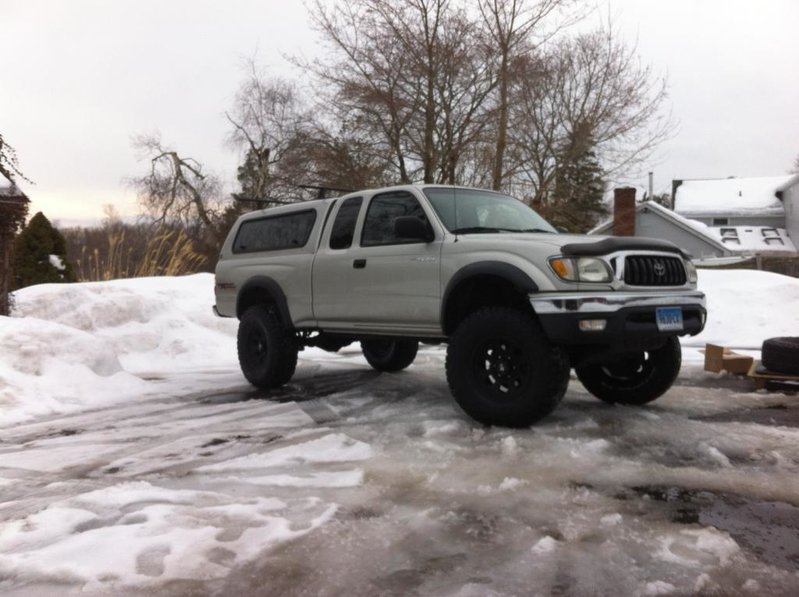

    -BFG KO2 285/75 R16 (+3 expo) wrapped around ProComp 7069-6883 Alloys (-7 expo) 177,xxx
    I almost went with 265s. Don't get the 265s. You'll just drive your truck until they wear out wondering what could've been. Bigger tires have been the single greatest modification to my truck that I've done. I couldn't fit them without a lift, and I couldn't afford them for close to 9 months after I lifted. I fell in love with this truck all over again when I put these on. Night and day difference from road tires offroad, and these aren't even mud tires.
    My only qualm with these is that they only come in load range E. They're heavy. They're tough to put on if you're working alone. They make starting out in first gear more difficult.
    Honestly I would've gone with a 285/75 R16 in a lighter load range from a different company if I hadn't irrationally known since I was 20 that someday I would own a lifted 1st gen TRD Tacoma with BFG all-terrains on it. I've loved these tires since my teenage days of riding around in my good friend's 1980-something bronco. Just one of those things.
    Back to some rational points. The ride is noticeably stiffer but it's not as bad as some people say. I think the people who complain about the stiffness of this load range are old with aching joints and things :D I wouldn't put ride stiffness as a con for these.
    I lost about 2 mpg in stop-and-go miles. The jury is still out on highway mileage. I don't think these have negatively impacted my highway fuel efficiency. I drive like a grandma, though. If you like to go fast I'm willing to bet on my grandma's life that you'll see a big drop in fuel economy.
    Personally, I drive slow and watch all the traffic around me like a hawk. Driving is fucking dangerous and people are fucking morons. I see at least one person on the road every time I drive somewhere that I might shoot in the face in a moment of weakness, given the chance, for their sheer ignorance of the risk of death or serious injury they're placing their fellow human beings at with their driving.
    A positive for me with a heavier tire is the gain in angular momentum. The additional coasting torque this nets you at the axles makes for a smoother time of driving a manual transmission on roads with small, rolling hills. Lots of that in New England.
    For those wondering about having to trim inner fender material, yes you will have to do some trimming. It's nothing that can't be accomplished with a sharp pocket knife though. Don't let this hold you back from running this size tire.
    As for the wheels, I went with alloys to save some weight. This is a DD/weekend warrior build, or I'd be running 37s with steel beadlocks.
    Note that in these three photos I hadn't yet fixed the setting on my bilsteins. Only photo I have right now with them corrected is the first one in the post.

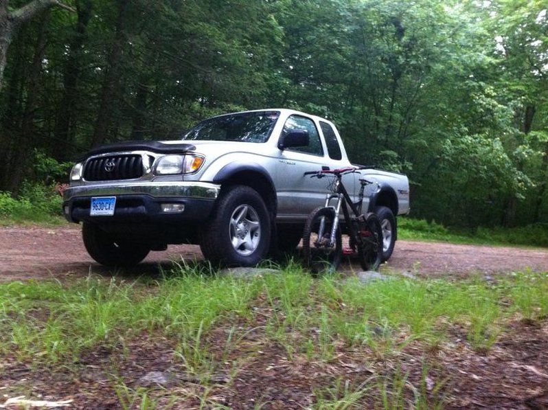

    -Leer clamp-on bedcap w/Yakima rails (173,xxx) +8 expo
    Bought this used for $400. Great deal in my opinion. I plan on sleeping in the back of this truck a lot, and wanted something to secure my gear in the back or I'd have gone with a soft topper. I just bought a welder/spool gun and have a design for a sleeping platform with drawers in the works.
    I'm also working on a way to get some more headroom under the hard topper when camping that I haven't seen done anywhere, but I won't say anything more about that just yet :spy:
