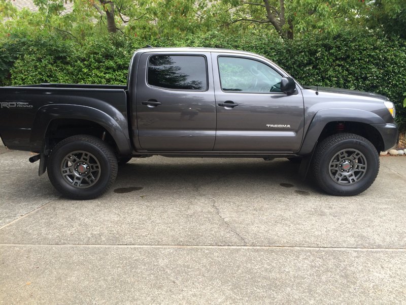

    086.jpg So the brakes on my 2012 DCSB 4x4 are the most grabby/touchy i've ever driven. Been to the dealer twice and they say all is normal...something to do with the TRD offroad crawl control RAC? Think they said Electro hyd assist-VS-numatic assist brakes? anyone have the same issues and if so is there any remedies to this? Its most noticeable at slow stops or sudden braking in parking lot stuff. thinking of changing brake pads and or rotors to help? Thanks for any info.
