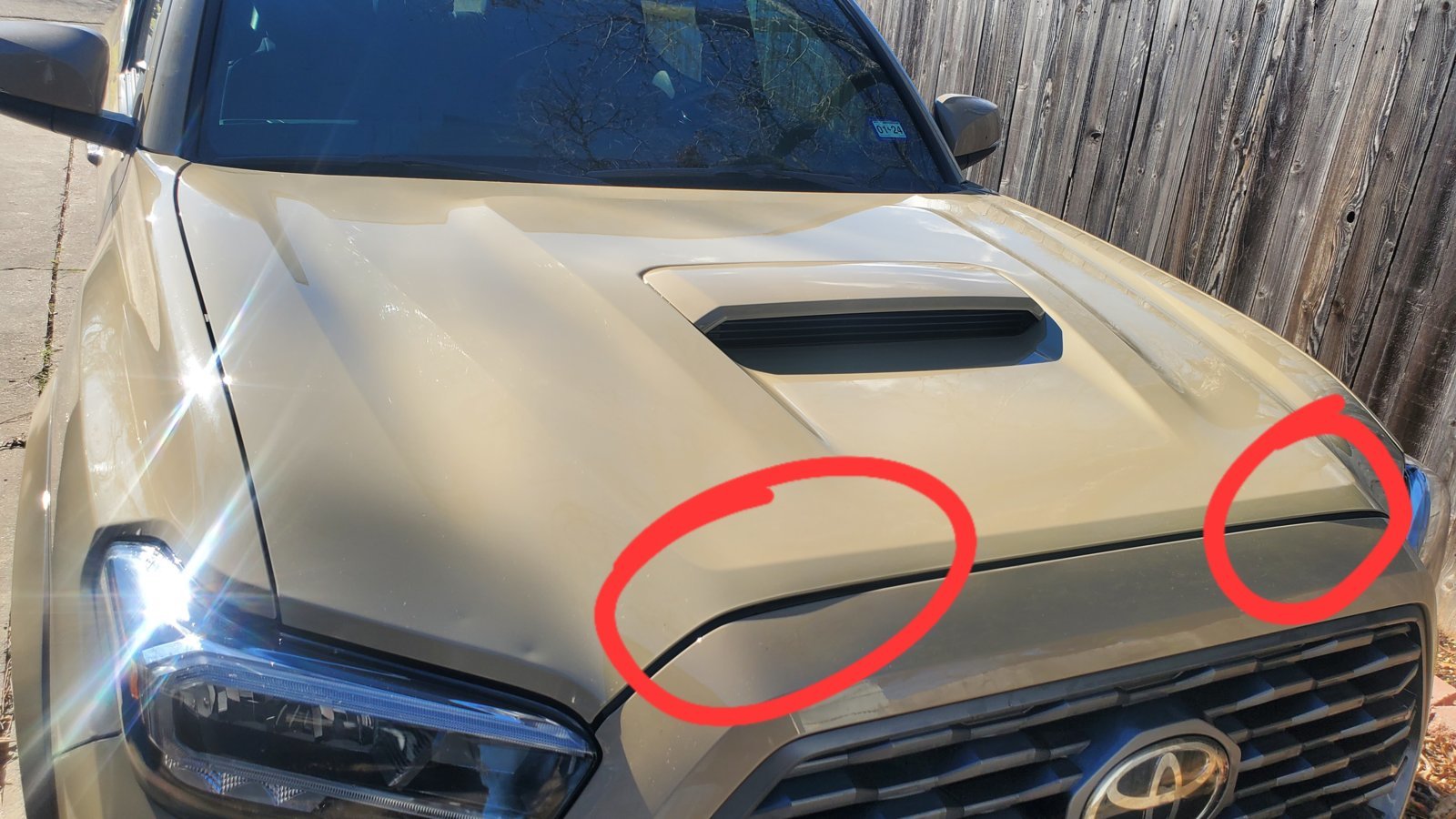

    Took this pic and noticed the hood is slightly raised at both sides of the center part of the hood. I can barely feel the transition, and I can't see it unless a really bright light (like the sun in the pic) is behind, so they're not raised much.
    AFAIK, the truck has never been in an accident (bought a year old with 12k miles). I played around with the rubber adjusters, but I couldn't get it any better. I'm not a body guy, but nothing seems off to me with the inside of the hood or the core support.
    I'm thinking maybe it's actually the grille surround? Any ideas? I realize this is probably smth you'd have to see in person, but any ideas or suggestions would be appreciated.

    that doesn't look right, almost like someone bumped something

    Other TW members have had issues with warped grille surround. Here is the link to the discussion.

    Was this here when you bought it? If not, what caused this?

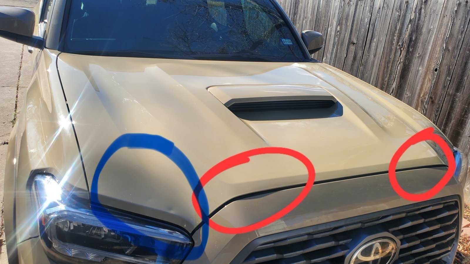

    No, those two small dents were recent at the time of the pic. I have another pic from a month and a half before, and those aren't there. I'm guessing a couple of rocks got kicked up on the road

    Ok……would suspect it’s the grille surround warped

    Someone bumped into your truck, or someone bumped your truck into something.

    Warped plastic grill bezel or whatever it’s called.
