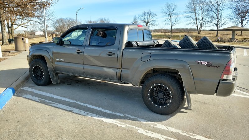

    Went with Taller Tire ......steering went sluggish 265/65/17 to 265/70/17. Steers fine on lift. Alignment? Rims have been changed

    Wider offset on wheels? You could notice a difference on steering leverage I suppose.

    Came off a newer Tacoma .....IDK Sh**

    Is the tire the same style/type? Or did you go from a OE type to something more manly?
    Are the new wheels wider? More offset? Heavier?

    just taller Tire.

    Cooper Discovery AT-3 to Nitro Grapplers. Steered fine after mounted...

    Checked fluids, steered Great. Now acts Like Im steering on flat tires.

    Pull one of the new wheels and weigh it, and weigh one of the old.
    Get the specs of one of the new wheels. They may have come off a newer truck, but what I'm seeing is not an OE wheel. So specs will be different.
    When was the last alignment performed? It could be that you've been off for a while, and a new spec (offset/width) has exaggerated the flaw.

    How do your tie-rod ends look. If it's really that bad they might be a bit on the dry or on worn out side.

    Did you use a tie-rod as a lift point for changing the wheels? Is this happening when driving or just parked? Are your tires low on pressure?

    Wider wheels, bigger heavier tires will do that, especially replacing the stock tire/wheel combo.

    Took In to Midas they Looked it over and didnt find any steering issues. They think just the tires. seemed better after leaving there. They thought fluid was fine.They drove and said nothing about alignment. Rear brakes needing adsjustment to slow down the Taco better.
