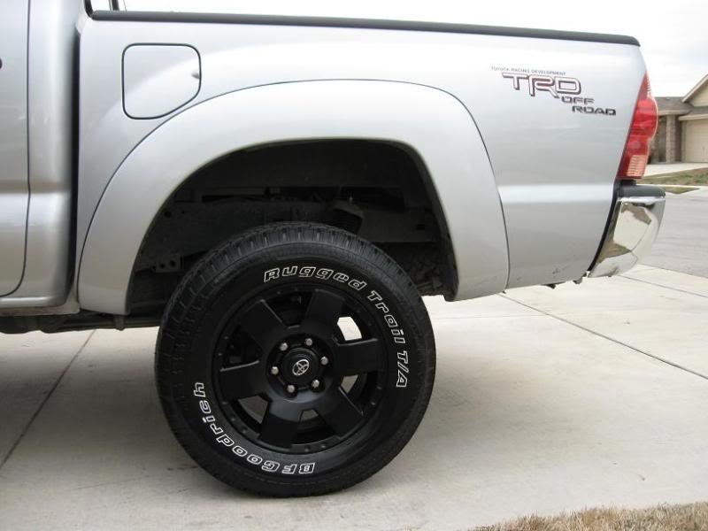

    To some this up I had them do an AAL and 5100's on all four, fronts set at 1.75 and they basically left the u-bolts hand tight. A weeks worth of driving 3 of them worked there way off. Damn glad I caught it!!:eek:

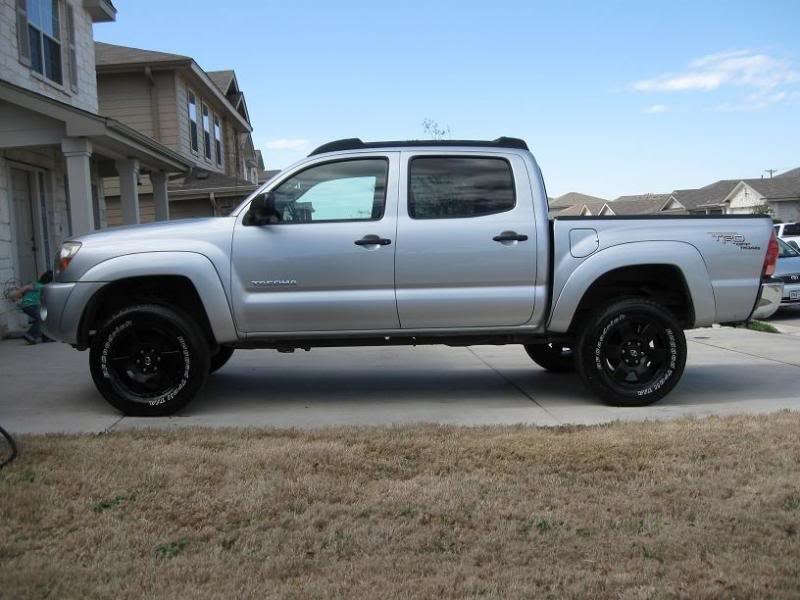

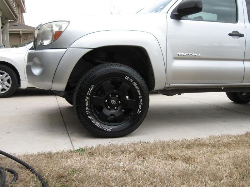

    Hey i know this is completely off subject but did you use your stock springs with your front shocks? Glad you caught the screw up by those idiots before something worse happened. Truck looks Great!
