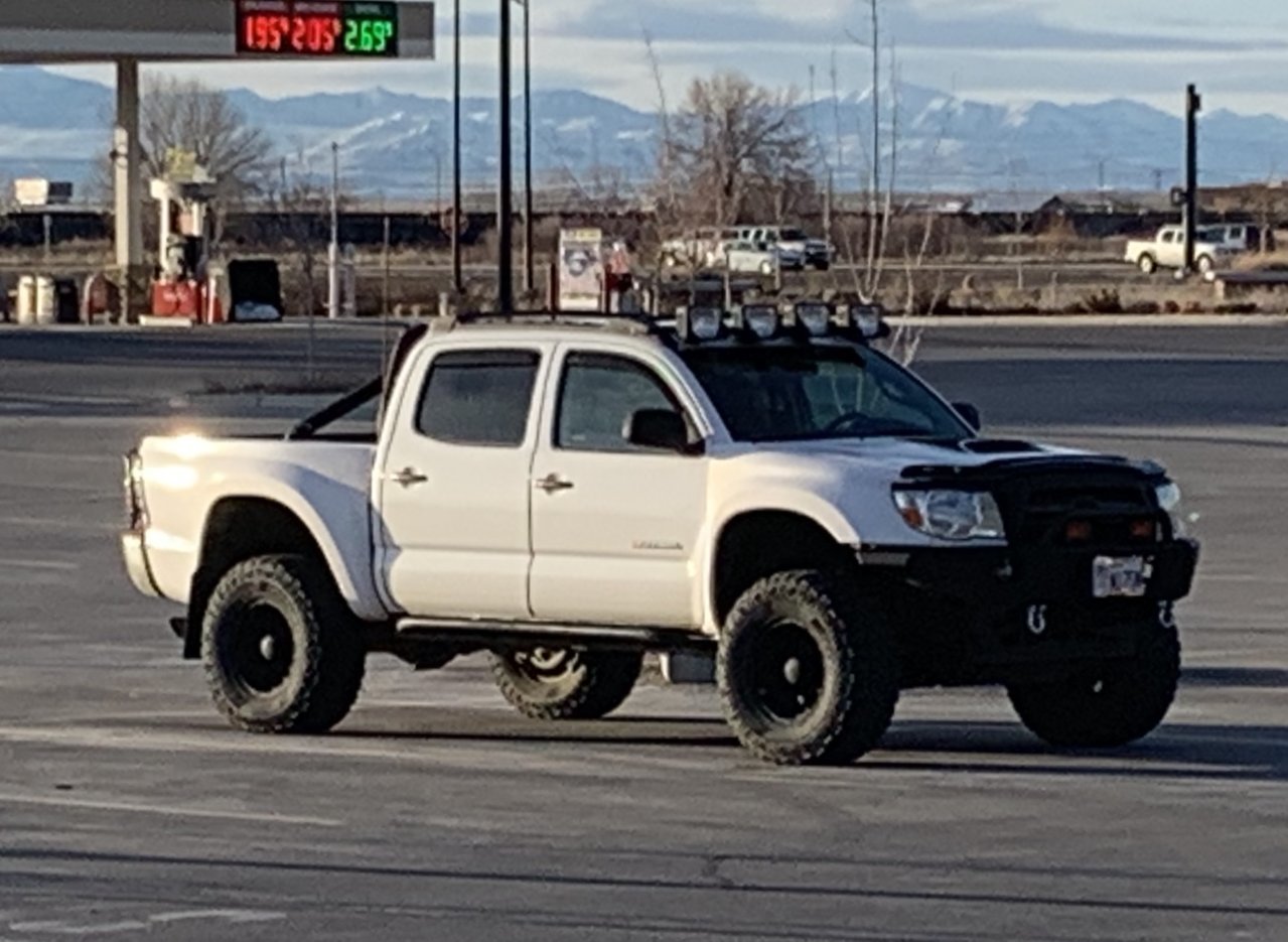

    Definitely doable!
    Best way? Probably not.
    Does it work just fine? absolutely!
    I already had 16x8 -11 so I added 1.25” spidertrax otherwise I would prefer a -38 or more(less?) wheel. 4” ADV fronts and 4.5” ADV rear.
    I was in a similar boat. I would love long travel but I use my truck for a lot of daily driving and for me the cost vs usage wasn’t what I’m ready for just yet. I have owned the truck since new in 2007 and wanted to mix things up without buying a whole new vehicle. For me it’s perfect!
    You are correct with the pivoting of the tire, a proper long travel kit would minimize issues.
    I first had 305/70r16s and with a heavy CMC I was fine. When I moved up to 315/75r16s I had to beat the crap out of my pinch weld and firewall. Alignment can affect how much you rub as well. You will not be able to use your old fender liners when you go to fiberglass, best bet is to make your own.

    nice, that is exactly what we are looking for, flush with 4" glass. Does that pic have 305's or 315's? So no more rubbing since you "modified" the pinch weld and firewall? What are you running for suspension/lift?

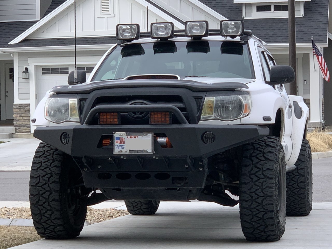

    Pic is with 315s.
    Here is 305s:
    I have bilstein 5100s front and rear, stock offroad coils set at 2.5” with Dakar medium weight leafs. Also SPC UCAs.
    On 315s I can bump the inner fender at the top on full compression but I haven’t had an issue with that as of yet, 305s never touched. I still touch the bottom of the pinch weld on a reverse turn, I gotta finish it off with a sledge, but it does not hinder drivability
