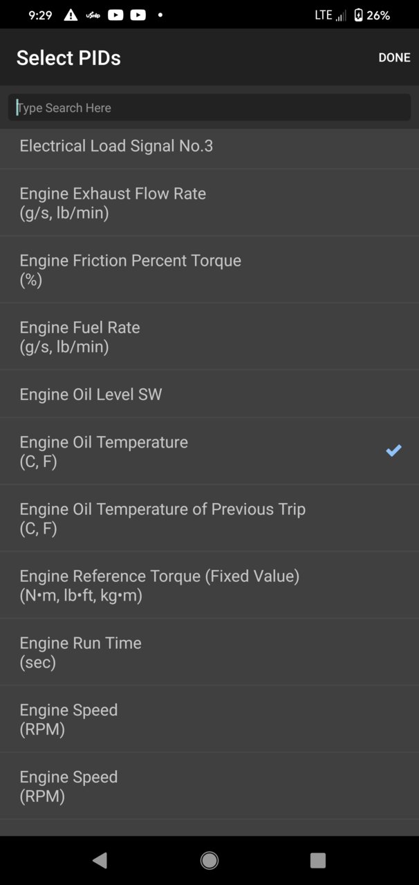

    I'm wondering if the reading is correct as it does seem to fluctuate quicker than I would expect. Here is the PID I'm using:

    Are u sure it's engine oil temp? Kinda sounds like torque converter temp.

    The screenshot I shared shows that it is Engine Oil Temp. I'll triple check today on my next drive.

    Yeah that's the same pid I used.

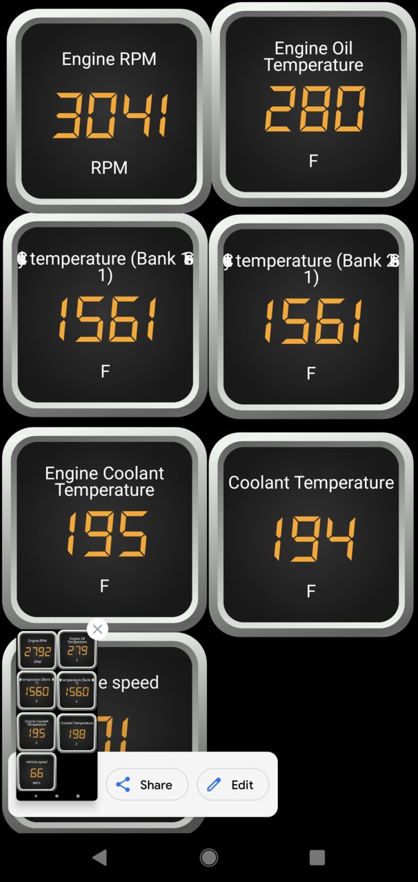

    I just hit 280 on a test run. In my opinion, this us much too hot for a low grade climb on a 38 degree day with no weight in the bed and while not towing. This vehicle also has the towing package with the extra oil cooler.Screenshot_20210103-151640.jpg

    The traditional approach is to try to hold oil temperatures between 230 and 260 degrees.Aug

    The oil temp is caused by cylinder temp. Above the piston is over 500*F. 280* is not crazy hot for engine oil, but does seem high. I believe 305* is getting close to Thermal breakdown for the Synthetic Engine oil.
    I'd think the sensor is feeding a false temp.

    I've owned many cars, trucks and sportscars in my life. My last high performance car almost always stayed below 240, even on an afternoon of hard cornering and long straightaways. Most of the time the oil temp stayed below 220-230 and on a track day you might may see 250 briefly. With Mobil 1 full synthetic, the techs never wanted to see the car anywhere close to 280. I'm wondering if other manual Tacoma owners are seeing engine oil temps above 250 on a cold day on mountain climbs? What does your oil temp look like while towing on a hot day?

    Time to verify if the info is good. Another form of measurement is required... have access to an infrared temperature gun?

    I was thinking the same. I was wondering if I can add an addition sensor on the coupling of where you might install a traditional external oil cooler ....right off of the oil filter. Where might you shoot the oil to get an accurate reading? I don't think the pan is going to provide an accurate enough reading.
