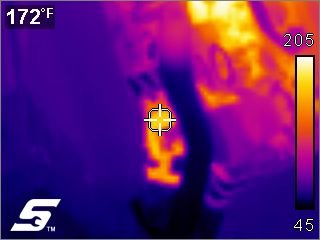

    172 deg, regular driving, engine idling, on the oil cooler looking thing at the front of the engine.

    the oil cooler is underneath of the truck. Seats on top of the oil filter assembly.
    Part # 157100P020.

    Ha my bad. It looked just like that part though, front/lower part of engine, but visible from the top.
