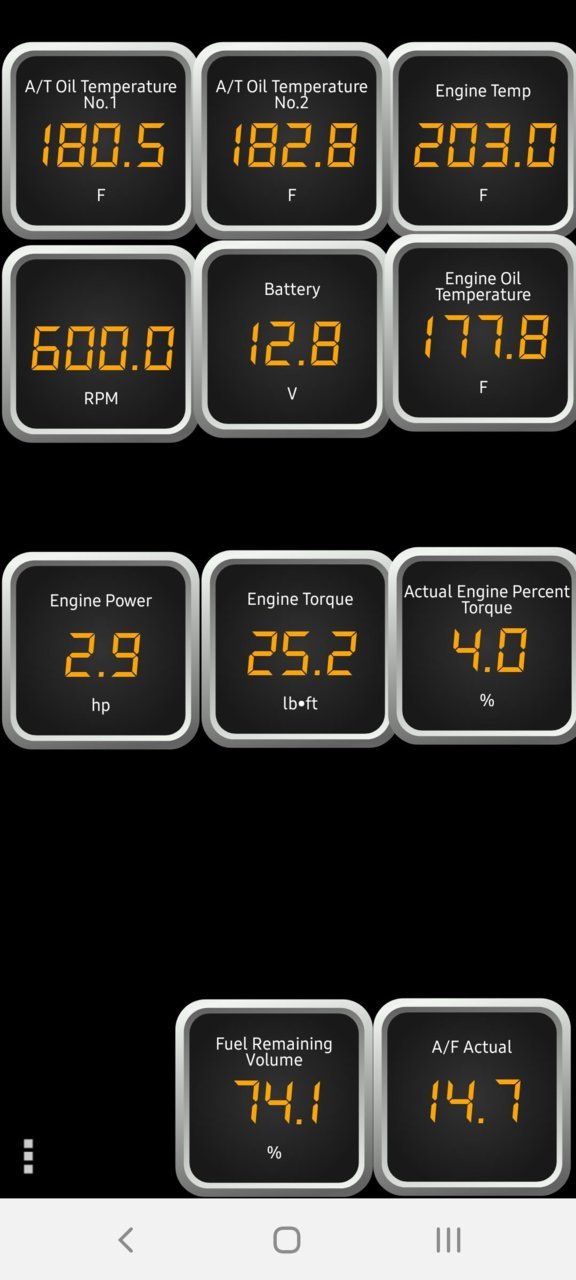

    I have the 2021 Pro with OBD fusion. This was from a drive around town and came to a stop at a red light. most of the sensors were BS as i had just gotten obd fusion .

    I've dug around in Mitchel and I can't find any reference to an engine oil temp sensor on any Tacoma so it must either be calculated or an unused PID that is just there.
