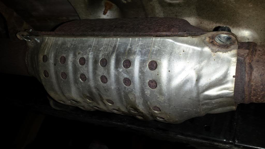

    My newest rattle is coming from my exhaust. Its only at certain RPM's but there's definitely a "buzz" sound. I've checked the heat shield on the 2nd cat and its secure so I'm not sure where its coming from.

    For the exhaust rattle, I found the heat shield on the 2nd cat to be missing 2 screws allowing it to rattle so I put 2 bolts in their place. Exhaust is now rattle free :D

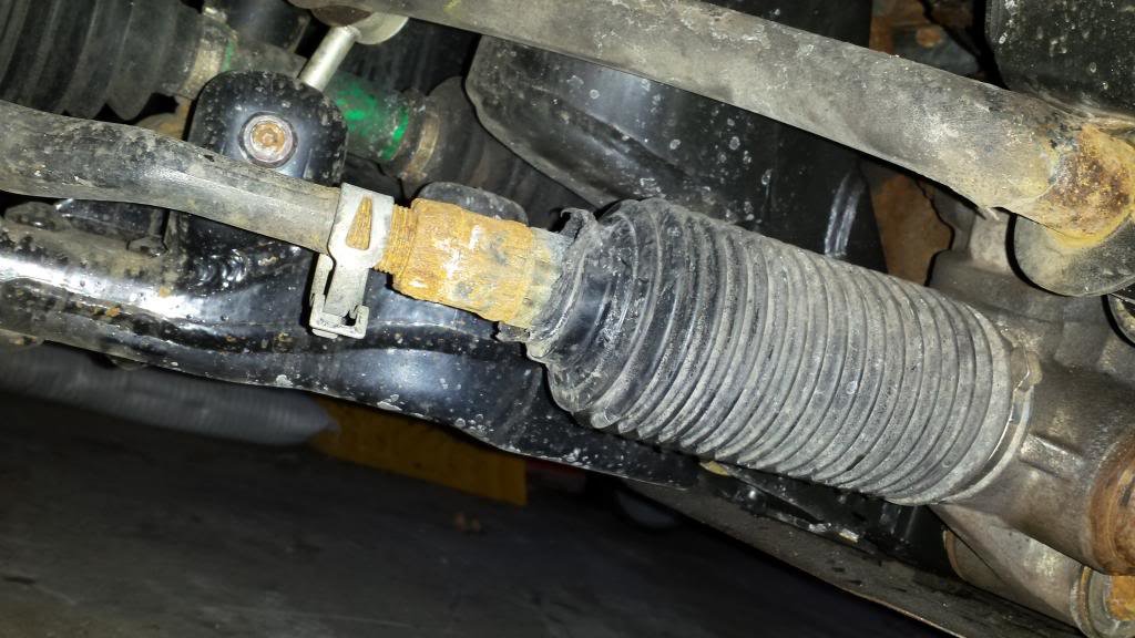

    On a separate note, since I was under there, I took a look around and found this on the drivers side. The boot is torn away and the retainer clip is hanging free:mad:
