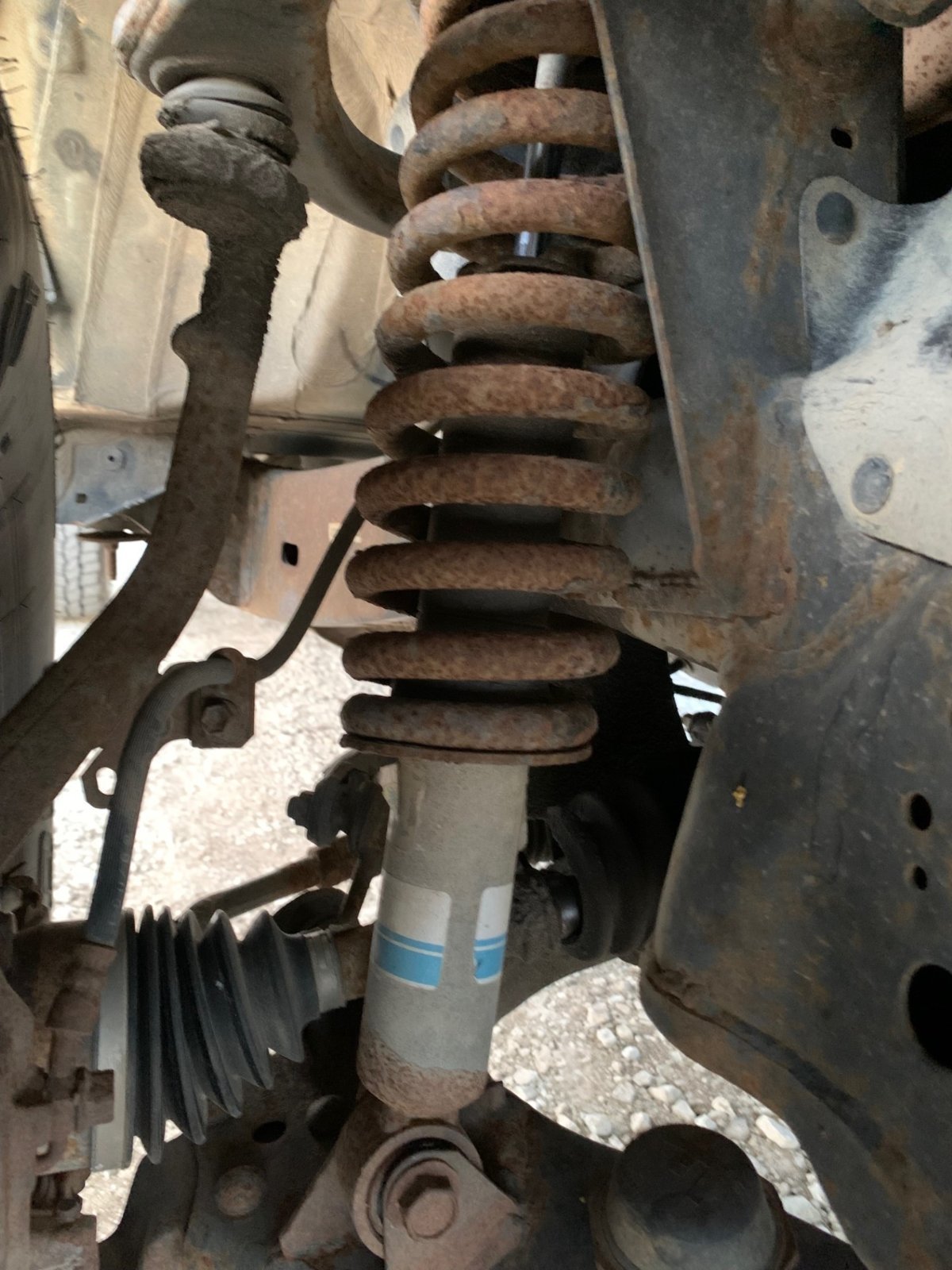

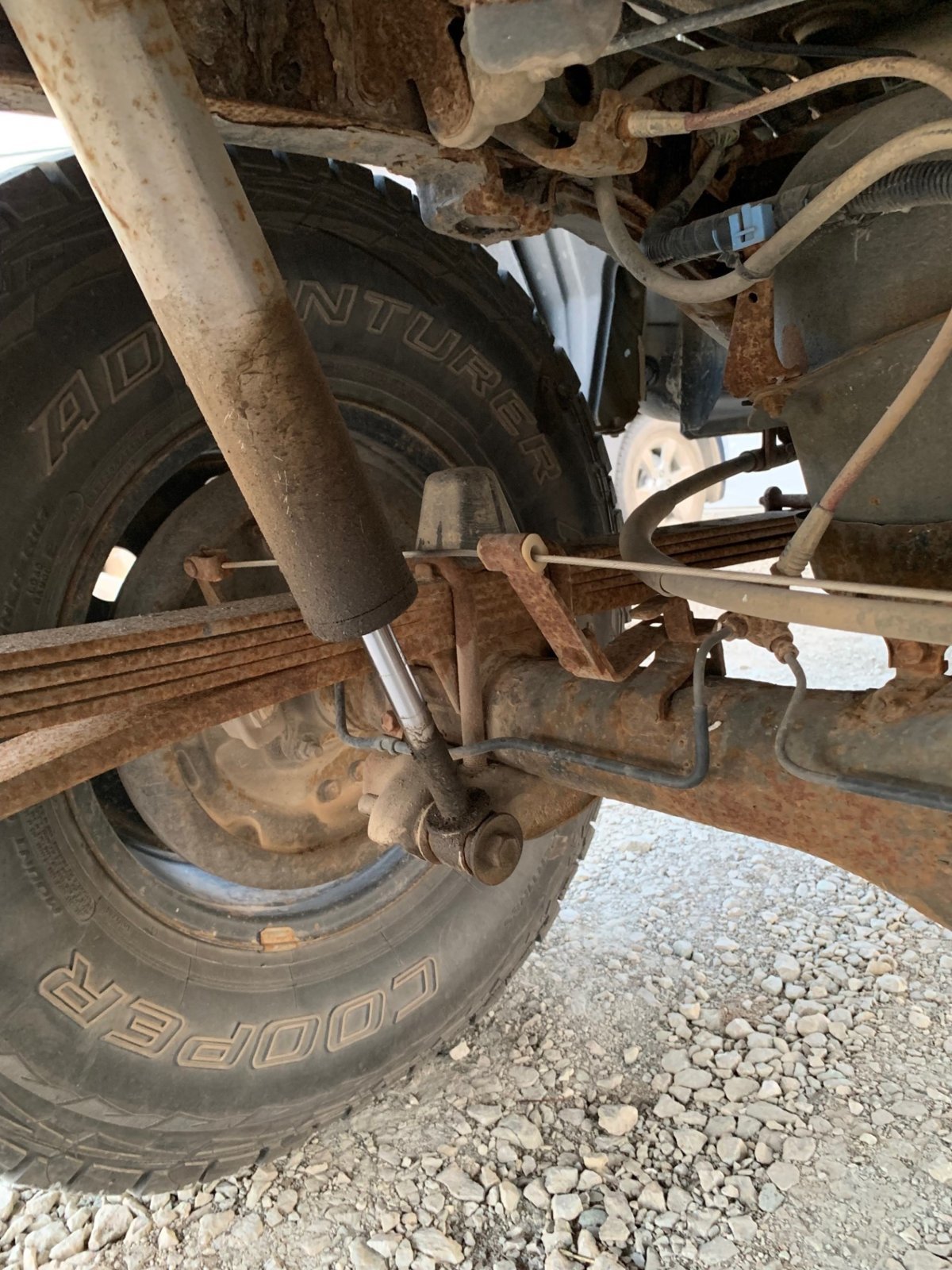

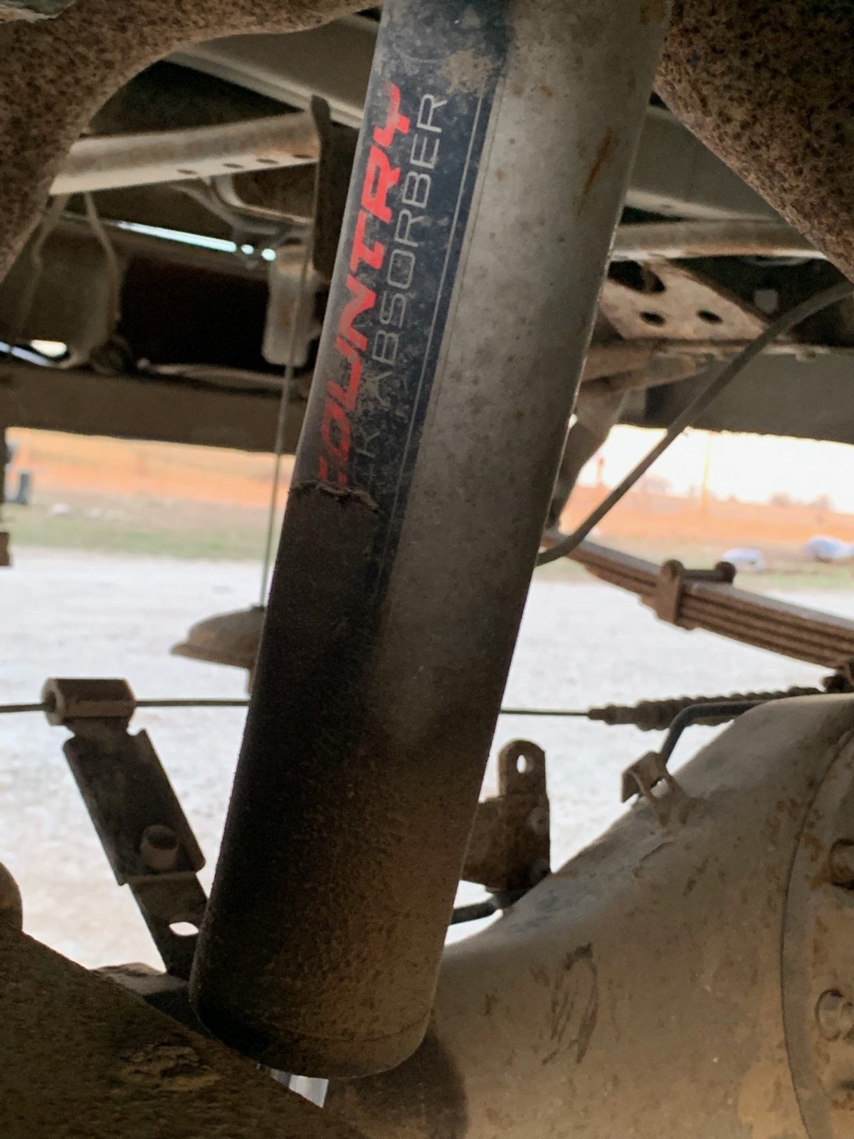

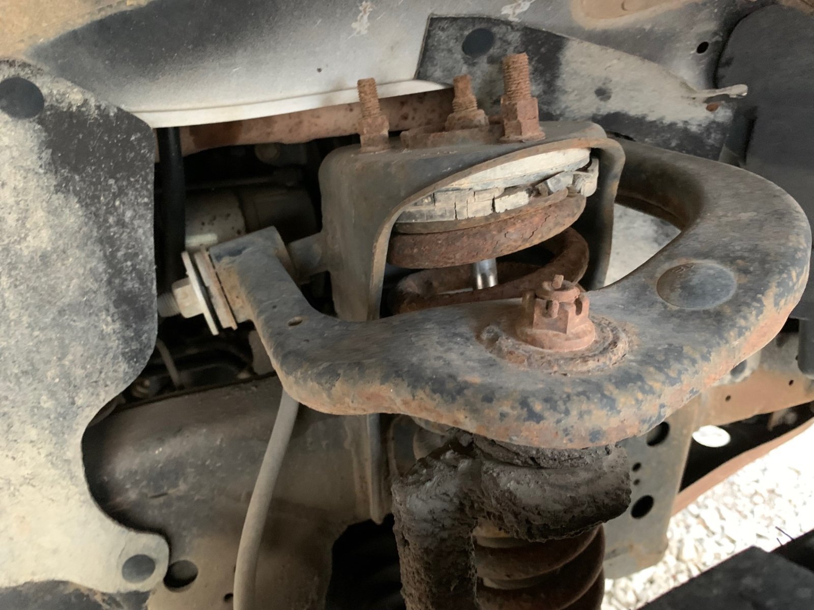

    Here are the pics. I am aware of the frame rot, which you can see in the first pic. I also found out the front shocks are Bilsteins, but must be super worn out, or the rear ones are so bad, that's throwing the front feel off. I don't know. I just was wondering if you guys can tell me what size lift this is, so I can get the correct length of shock.

    Yeah I don't see a suspension lift at all on that truck (no drop brackets anyway). If someone told you that had a 6" lift, they lied.
    I would treat that as if it were a stock truck. In other words, a 2" lift replacement shock & spring will net you two inches lift, a stock replacement shock, 0" lift.
    Judging just by the angle of your CV joint, I would guess that is what you have, a 2" leveling lift (lifted via the front shocks). Rear looks stock (0" lift).
    Is there a part # visible on those Bilstein shocks? I'd say maybe just replace them with the same (Bilstein shocks are generally regarded as quite good, at least when they're not worn out lol). For the rear, you'll likely want stock application Bilstein shocks to match the fronts.

    That truck's suspension definitely needs a good bit of refreshing... New leaf springs, new coil springs, new shocks front & rear, new inner CV joint boot (if it's been driven around a lot with the boot ripped like that (looks like it has), the joint itself may be toast as well, so new CV half-shafts). Couldn't hurt to do ball joints, tie rods, and also the front control arm bushings (new leafs generally come with their own bushings). Might as well do the universal joints too while you're at it (assuming they're in similar condition as everything else under there). And of course stopping all the rust on that frame.
