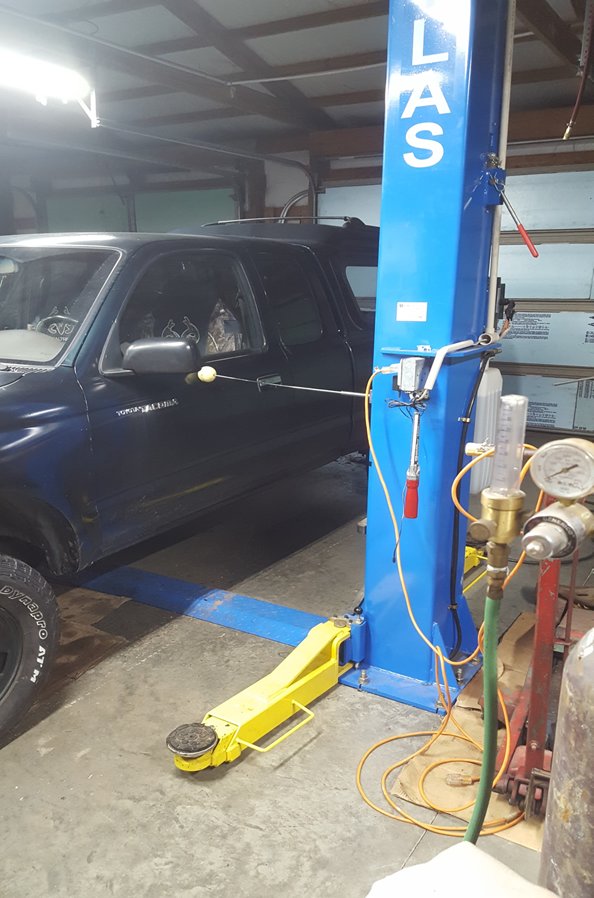

    Not gonna brag about having a lift. See the Harbor Freight trailer hitching ball touching my truck? I have the distance for each of my vehicles written on the lift arm. I pull the ball out so it brushes the door of the vehicle as I drive in. I am very anal about centering the vehicles so the lift arms get loaded equally. Saves me a lot of time getting out and measuring, getting back in and trying to move the veh over 3 inches, then back again,...

    Not a bad idea.
