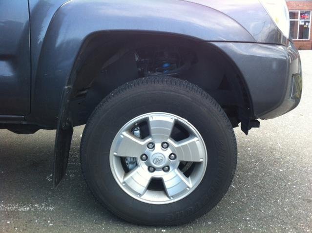

    I am looking for some help for finding my new set of wheels. I'd like to give you a little bit of information on the way I like to drive / driving environment and the truck itself.
    Truck Specs:
    2012 v6 sr5 (2wd)
    truck leveled off at 3 inches
    currently all stock wheels, tires - 16x8 i believe.
    Driving Specs:
    6 miles to work 1 way. All streets. Nothing special. Truck will obviously never see dirt or anything of the likes. Is very street queenish.
    My two cents:
    I really like how my truck feels right now but i hate how it looks. I want bigger wheels now that I got the lift this week - but I dont need super unnecessary offroad tread (for obvious reasons).
    Suggestions? Thanks everyone!

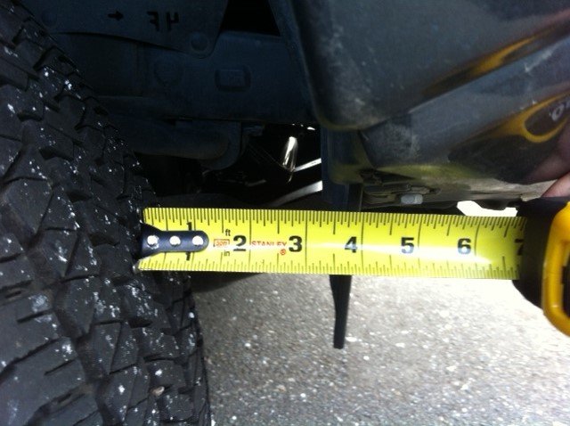

    Sorry to jack ur thread...Hey KPT I have a 3" lift and 265/65/17's stockers on my truck now...I want to fit 285/70/17 with 17x9 wheel and a -12 offset...It looks like I have 3-1/2" of clearance on both sides of wheel well and lots of room above...I will remove the front guards and flaps...do you think I can get away with minimal triming and not have to do CMC...this is my daily driver and hardly sees any offroading...Thanks for your advice...
