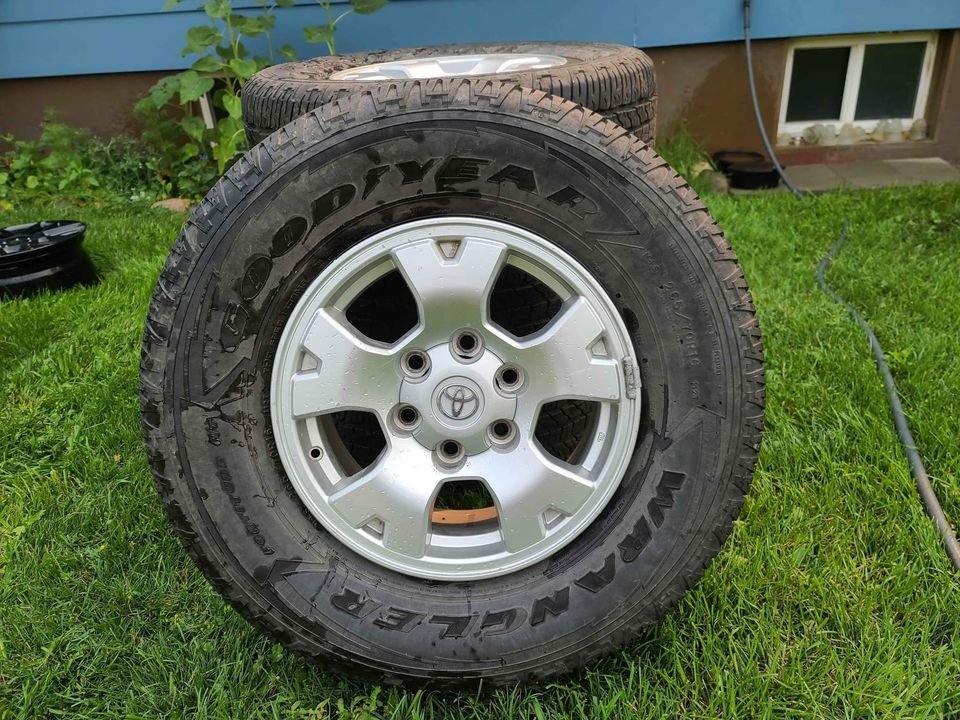

    Found a set of alloy wheels (+tires) on FB for $300. Taken off of a 2011 Tacoma at 7,000 miles (seller only bought the car 3 years ago so the wheels probably have many more miles on them). I am looking to replace my 2021 steel wheels with something lighter - is this a good deal? Do I have to worry about non-compatible pressure sensors?
    219591292_5009771762371886_7056722405483_746718fe7e6ceb63ab81dd6f1ec4854759cb058b.jpg

    There is no TPMS on that wheel in the photo.
    Check the DOT date codes on the tires to determine how old they are.
    You will likely need new lug nuts as the steel wheels usually use different one from alloys like these.
    Otherwise, the wheels will fit fine and the 265/70R16 tires on there should not rub - even with no lift or any other modifications to your 2021.

    Same w tpms. Afaik, sensors for steelies won't work on the alloys and vice versa.
