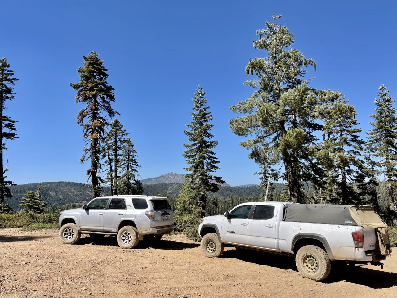

    Kings 2.5” front and rears from Accutune / ICON RXT LEAF PACK black badges doors and tailgate / method 315 / 255/85/16 Yokohama G003 / magnaflow exhaust , axle dump / meso int delete kit / meso led map lights / dome lights / wheelers front super bumps / accutune Flip kit with spacer and new bumps / Cali raised fog light pods / Cali raised ditch lights / RCI FULL SKIDS / SLIDERS / RCI rear bumper / rigid backup lights / tuned on 4.88’s
    I have set up you are looking at. Great IMO. On and off-road. For reference method 16x8 0 offset 265/75/16. Still look good. Also have more room for Articulation when off-roading with this tire size. My Buddies 4Runner with 285’s for reference.
    Good luck OP

    Awesome! Looks great, Based on your experience with your setup, do you think an extra -12 offset would have enough room?

    You may end up needing to do a little trimming

    Thank you appreciate it. With that offset you might have to trim a bit
