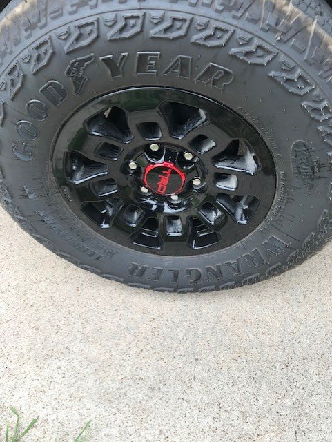

    Cheapest option would be to upsize to a better A/T tire and keep the steelies. Or you could buy TRD Knockoff rims, like I did, and save a ton.

    Which wheels did you go with? Yours look great. Want the OEM PRO wheels, just don’t like the price.

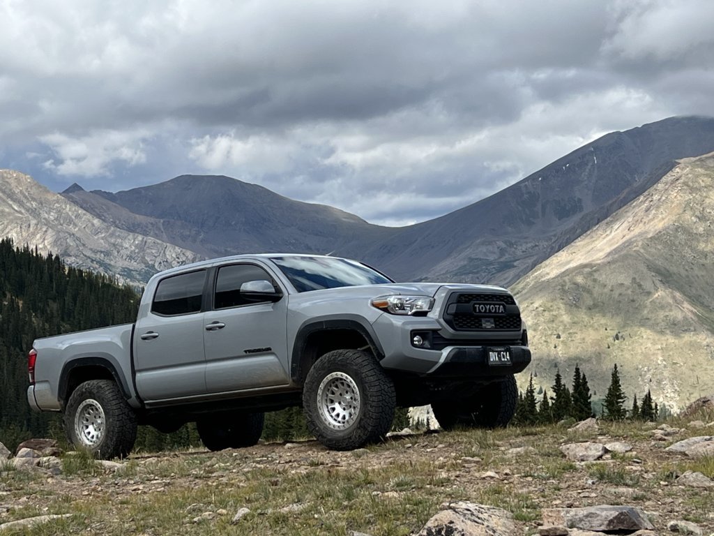

    Bilstien 6112 front coil-overs with Dobinson billet aluminum fully adjustable upper control arms, Bilstien 5160s with reservoirs and Icon multi-rate rear leaf spring packs. LT285/70R17 Falken Wild Peak AT4s on 17 x 9 Black Rhino Primm mirror faced wheels.
    Falken Wildpeak AT 4Ws LT 285/70R17s (33 x 11.5) on Black Rhino Primm wheels. Bilstein 6112s with 1/2” RSG spacers and Dobinson billet aluminum fully adjustable upper control arms up front. Bilstein 5160s with Icon multi-rate leaf spring packs in the rear. It equates to a 3” lift. I happen to like the way it looks but the improvements not only make it better off-road, the overall ride quality improved on paved roads as well. My goal was to improve the off-road capability and to try to minimize undercarriage damage on the occasional surprise obstacle. Maybe a little more coin than you want to spend, but to me, it has been worth every penny.

    They look great, what they run?

    They are called Replika and they go for less than $800 Canadian, with free shipping. You get the center caps too, but not the TRD logos. Bought vinyl inlay's separately.

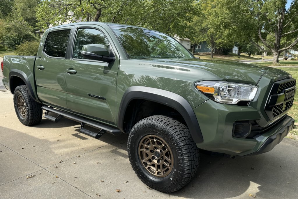

    Can’t help with the wheels, but for tires, just replaced the OEM Wranglers with Pirelli Scorpion All Terrain Plus. (The plus is important as the first gen version was crap, apparently.) purchased via Walmart interface, from simple tire. Installed by Walmart with road hazard and lifetime balance & rotation for $750 total. These tires look amazing, grip the road very well, and reduced cabin road noise by at least 50 percent. I’ve got about 3,500 miles on the Pirelli’s and couldn’t be happier. IMG_9705.jpg

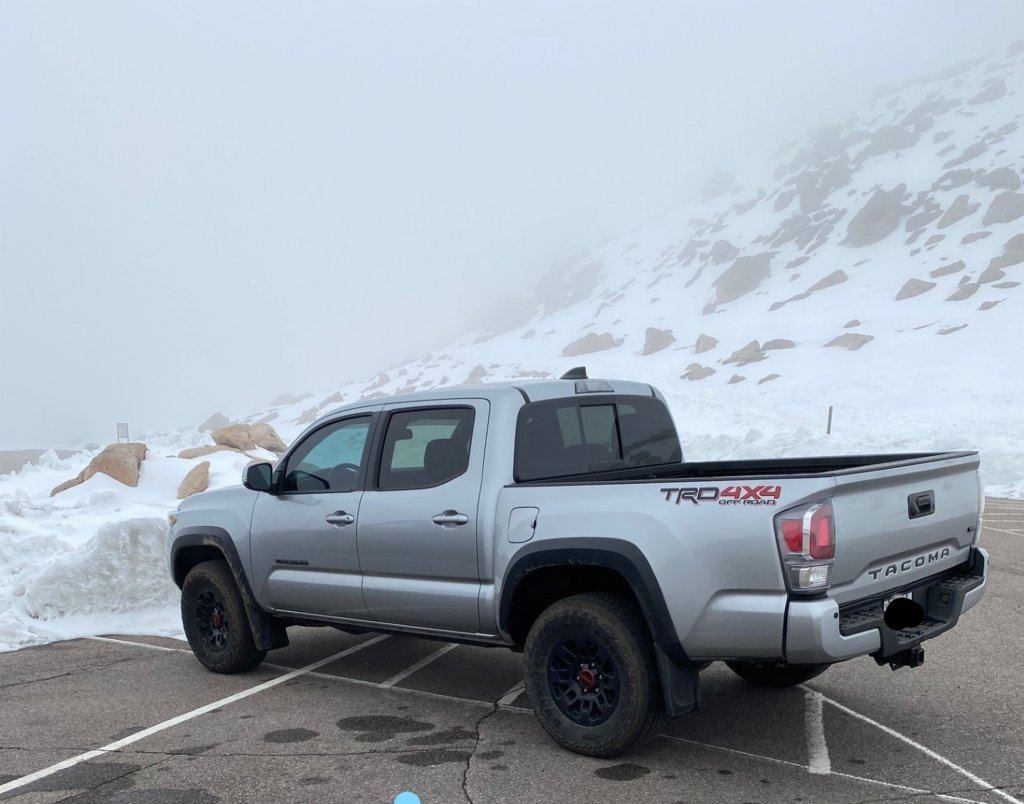

    oem pro wheels
