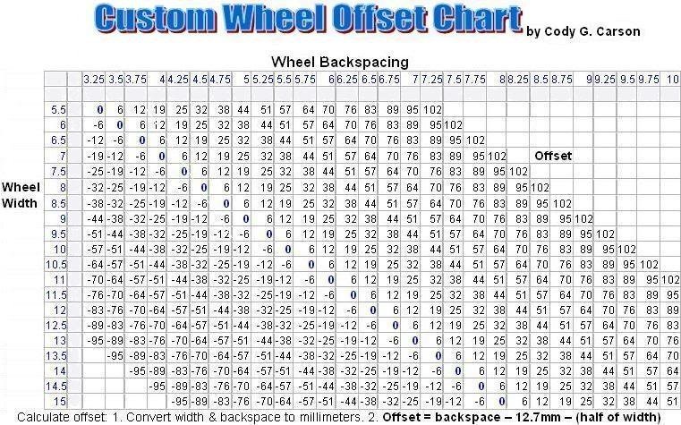

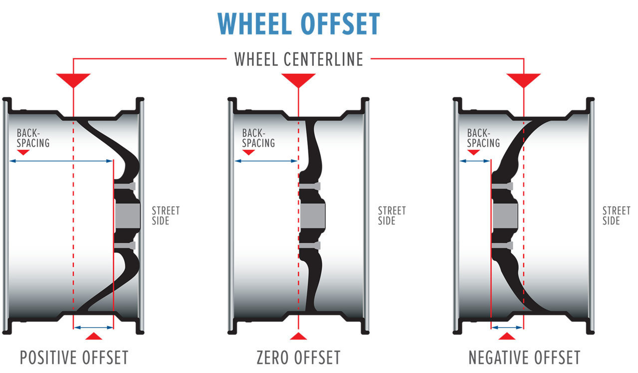

    OK, as I said the other day, newbie to Tacomas and newbie to all this tire math. I started to nerd out a bit on all of these calculations regarding wheel width/offset/backspace.
    I’m trying to determine fitment on an ‘18 TRDOR using stock suspension and stock tire which is the Wrangler Kevlar 265/70R16. The factory wheel was 16x7 with a 25mm offset which should give it a backspace of 4.98/5. The new tire I want is 16x8 with a 0mm offset which should give it a backspace of 4.488/4.5.
    Here’s the rub (no pun): that original tire has a listed width from Goodyear of 8 (range of 7-9) and I’ll be transferring it to an 8” wheel, so what’s the most exact way to determine the backspacing?

    The tire has no effect on the back spacing, that's a spec only on the wheel. You are correct, an 8" width with 0mm offset correlates to 4.5" back spacing.

    I guess the nerd in me is just trying to wrap my brain around these calculations. Tire size must play some roll in the backspace calculation because an inch is added onto the size of the wheel to account for the tire when determining backspace, no? Meaning shouldn’t a factory 8” wide tire which is crammed onto a 7” wheel still maintain more of the 8” shape especially by the time it gets to the tread?

    Haha I follow you, but the tire has no effect on the wheel specs. You are correct in that your tire mounted on a 7" wide wheel will "fit" differently on an 8" wide wheel, however it has no effect on the back spacing of the wheel. The tires you have will have less sidewall bulge due to the added inch of width, the tread will still contact the road just the same.
    For example: I have 16x8 wheels, 0mm offset and 4.5"bs with 285/75R16 tires
    You're looking at 16x8 wheels, 0mm offset and 4.5" bs with 265/70R16 tires
    Even though our tire sizes are different the wheels themselves will fit and be positioned exactly identical.

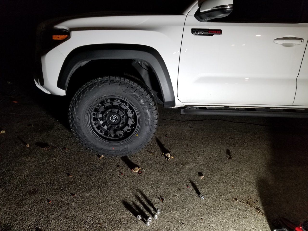

    Towards the end of this month I will be attempting 285/70R17 on 17x9.5 -18offset 4.5 bs Black Rhino Arsenal wheels.
    Still on stock pro shocks for at least a couple more months. I expect a lot of trimming.
    I'll post my mess as I progress.

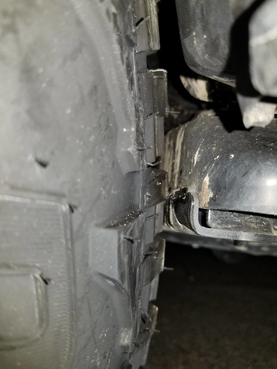

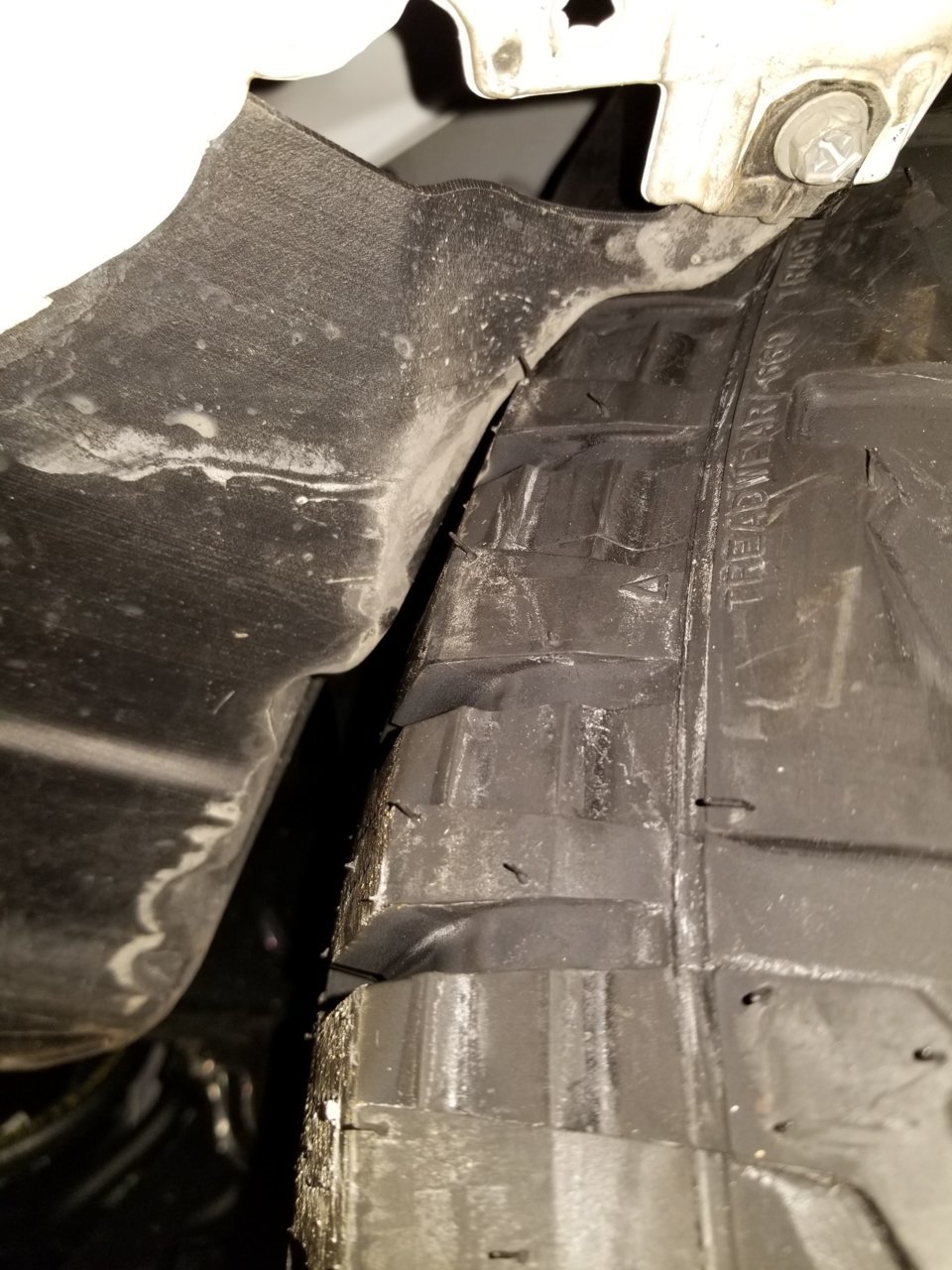

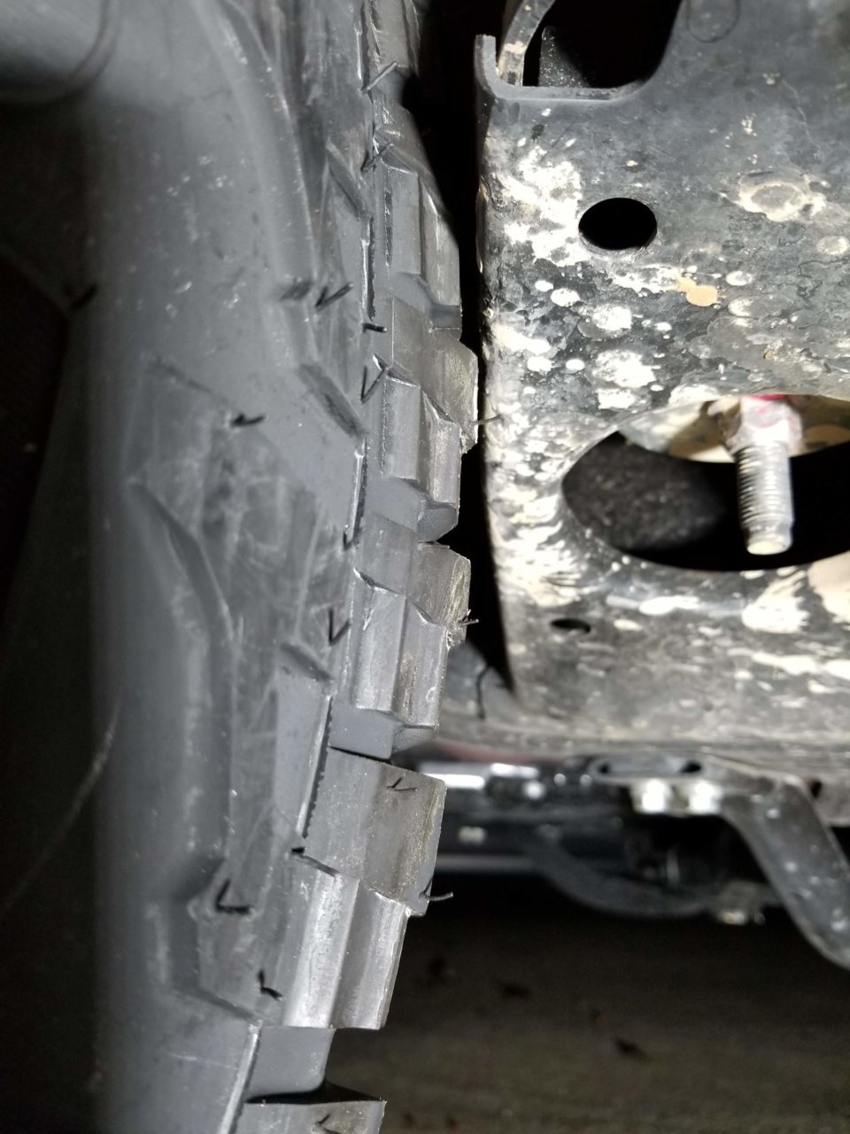

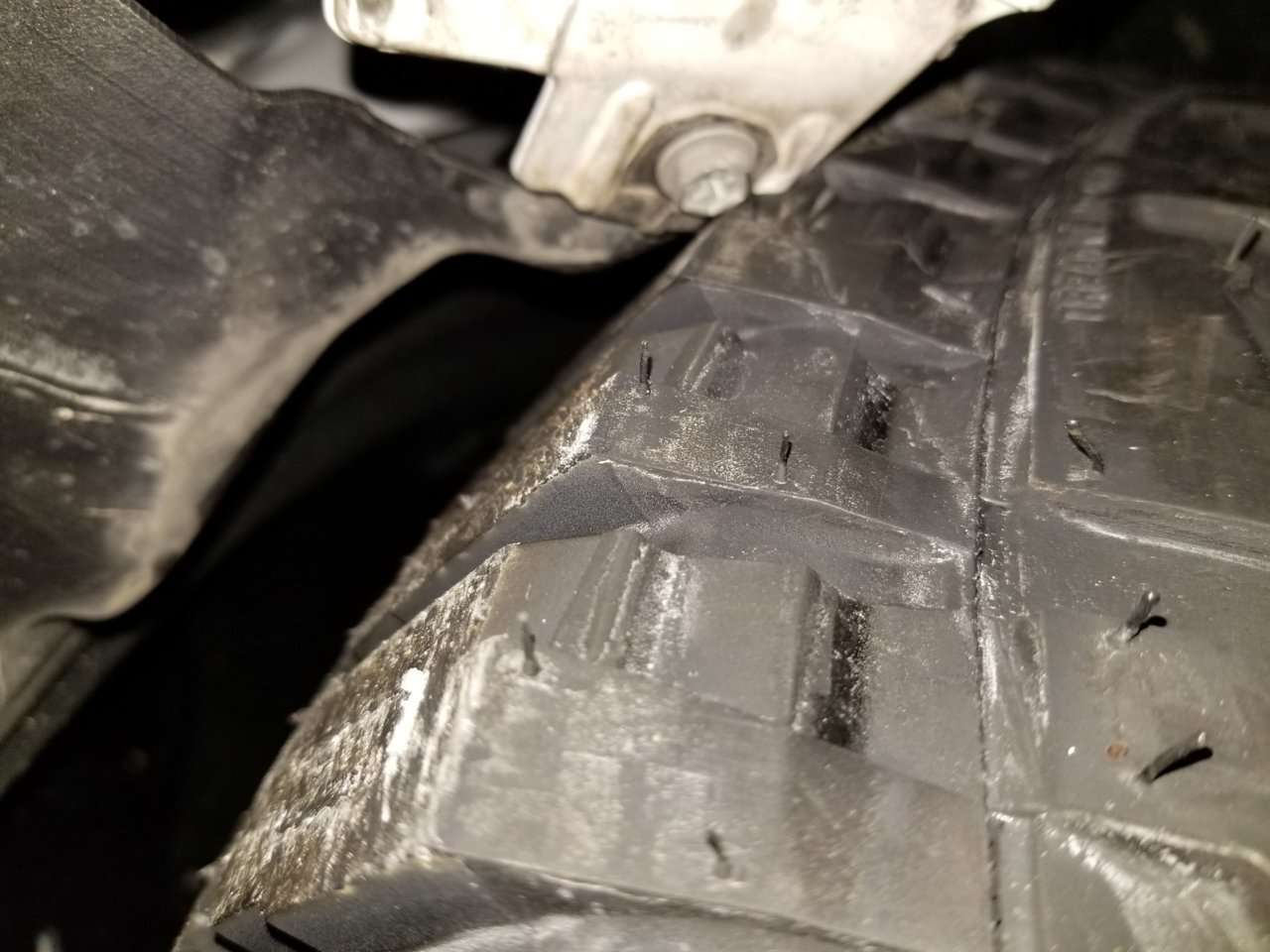

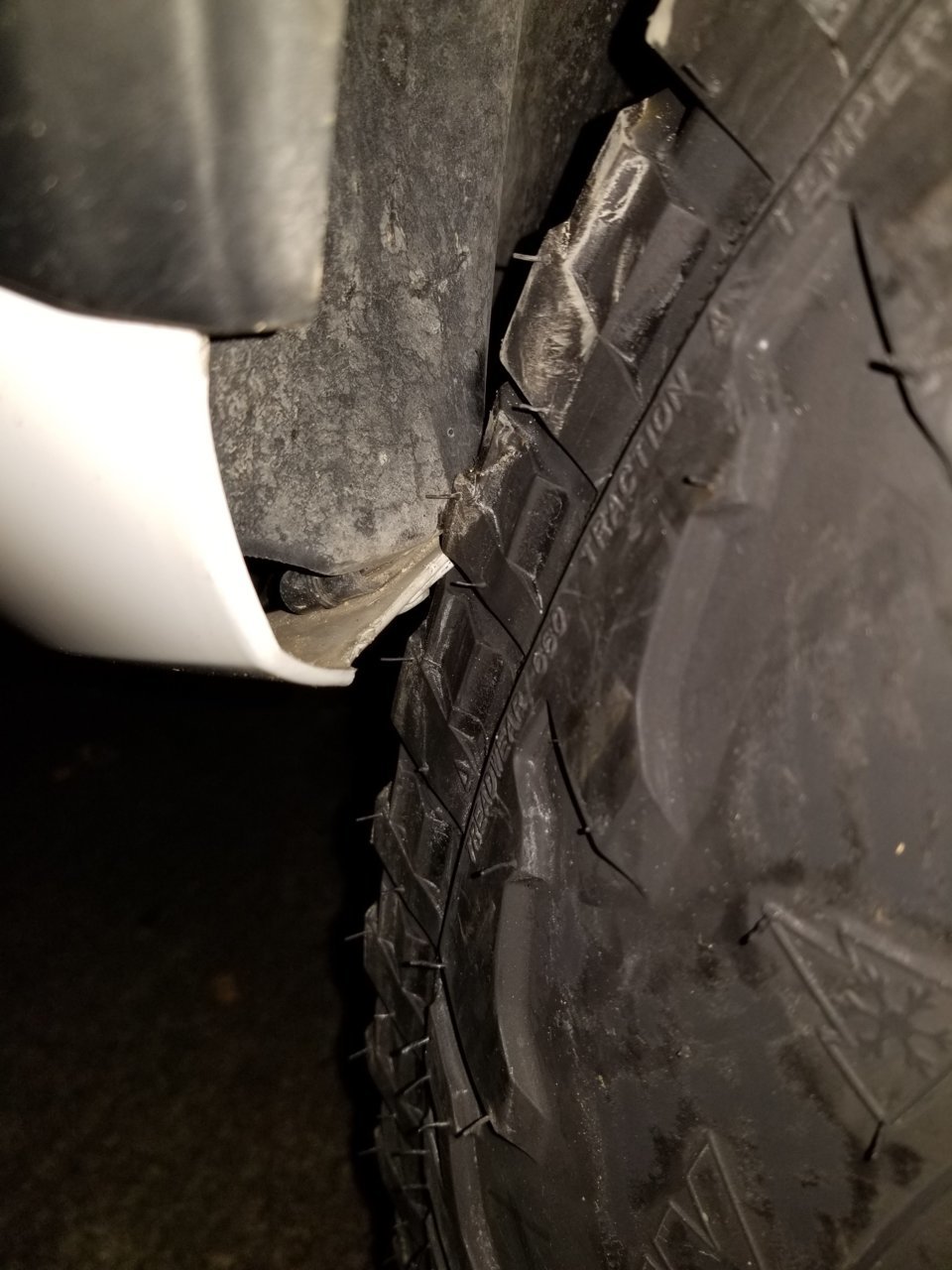

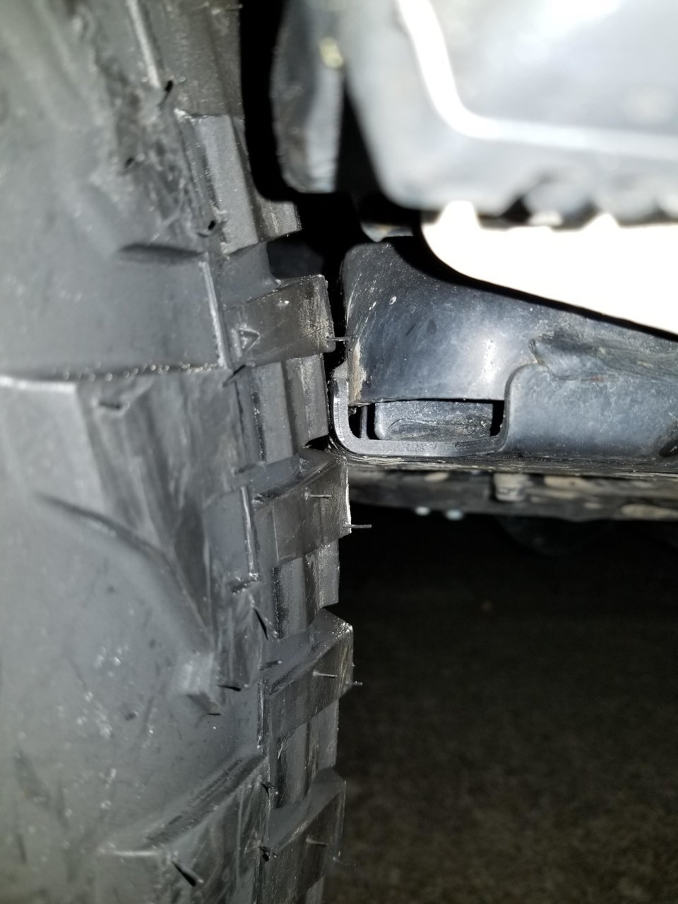

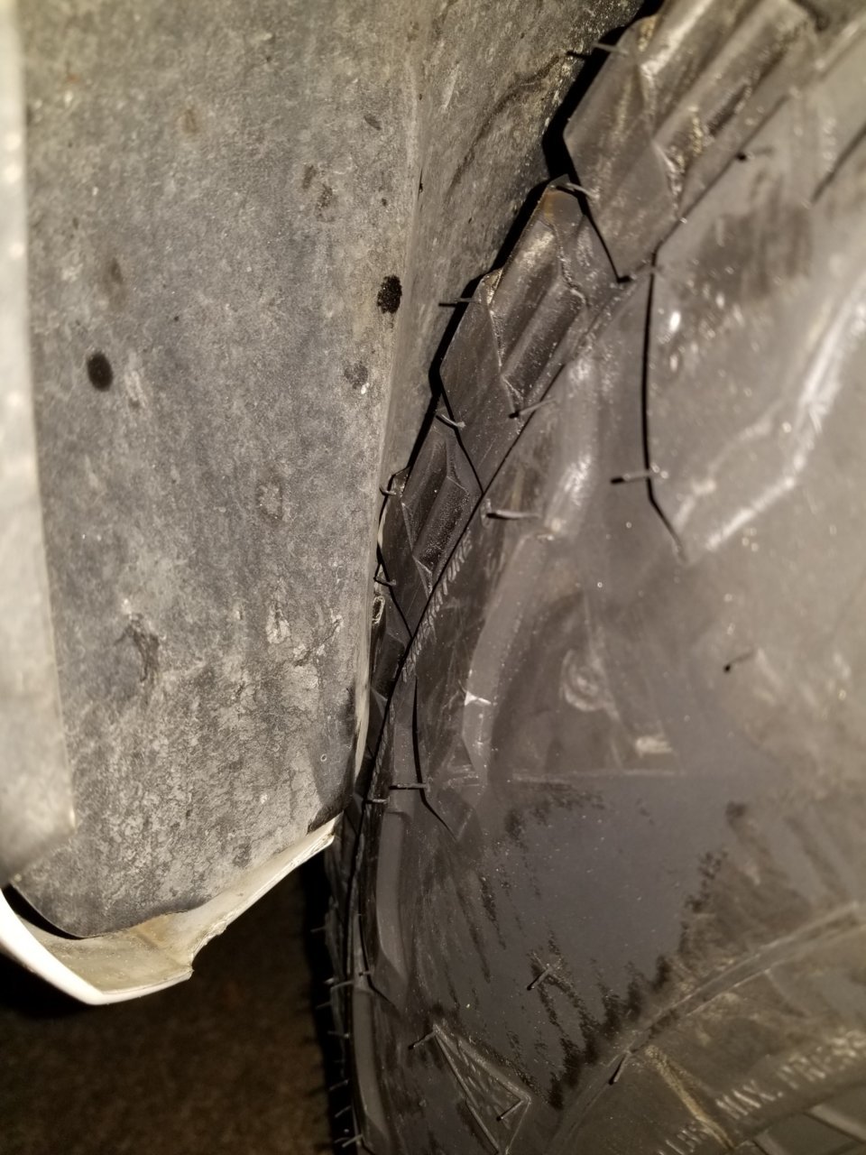

    Well I just put one 285/70R17 set on to test fit and get an idea of where I'll need to trim.
    These are 9.5" wide wheels with -18 offset (4.5bs).
    I'll definitely want a CMC and a large portion will need to be cut from the forward outside of the plastic fender. I'll be ordering a front bumper soon so I'll be cutting way more once that gets in.
    Here are the pics - closeups taken at full lock and a couple just under full lock.

    1mm offset on a 16x8 wheel... isn't that basically 0mm... i mean 1mm... so it would be basically a 4.5" backspace... Right?

    Correct
