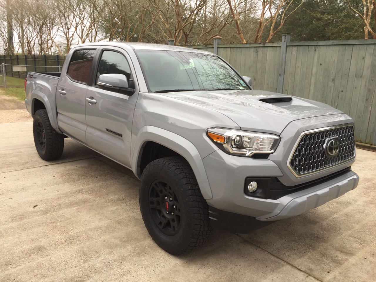

    #231
    CarverLB
    CarverLB Who Dat?!
    Apr 9, 2012
    #76579
    1,145
    Bryan
    Long Beach, Mississippi
    2021 Trd Sport 4x4

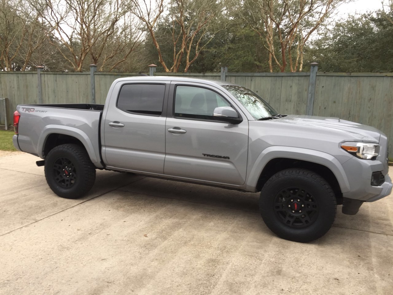

    3rd Gen. with 1" leveling kit from HeadStrong Off-Road, 17x8 FN Fx Pro Wheels, 265/70r17 tires and no rubbing at all.

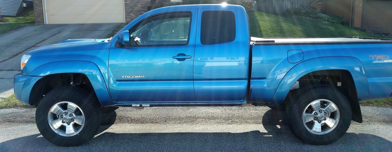

    2006 Access Cab on 275/70/17 Kumho's, Billstein 5100's, OME 887 springs up front and add a leaf in the back. Ended up with a perfect 3" lift ll the way around. Stock UCA's
    I want to run 285/70/17's on the next set of tires and I seem to have plenty of clearance. What is the concensus on aftermarket wheels for 285's so I dont have to chop the cab mounts? I have been thinking 17x8's with 4.5" backspacing.

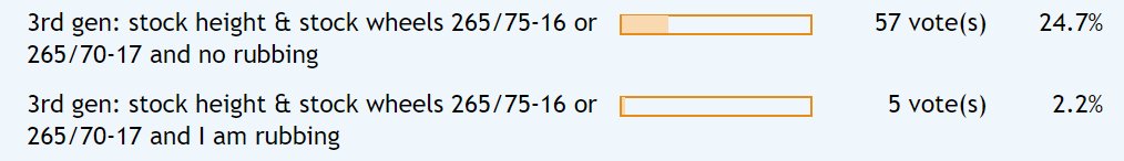

    Will it rub? 57 people didn't have an issue with your set up and tire size while 5 people did. Chances are very slim you'll have an issue with rubbing and if you do it's most likely on the mud flaps.

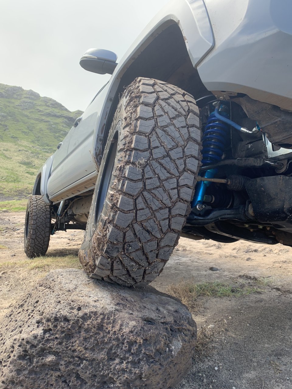

    scary_xp
    scary_xp New Member
    May 21, 2018
    #254196
    4
    Oahu
    18 Cement TRD Sport 4x4 dcsb

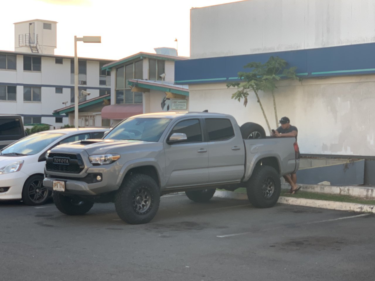

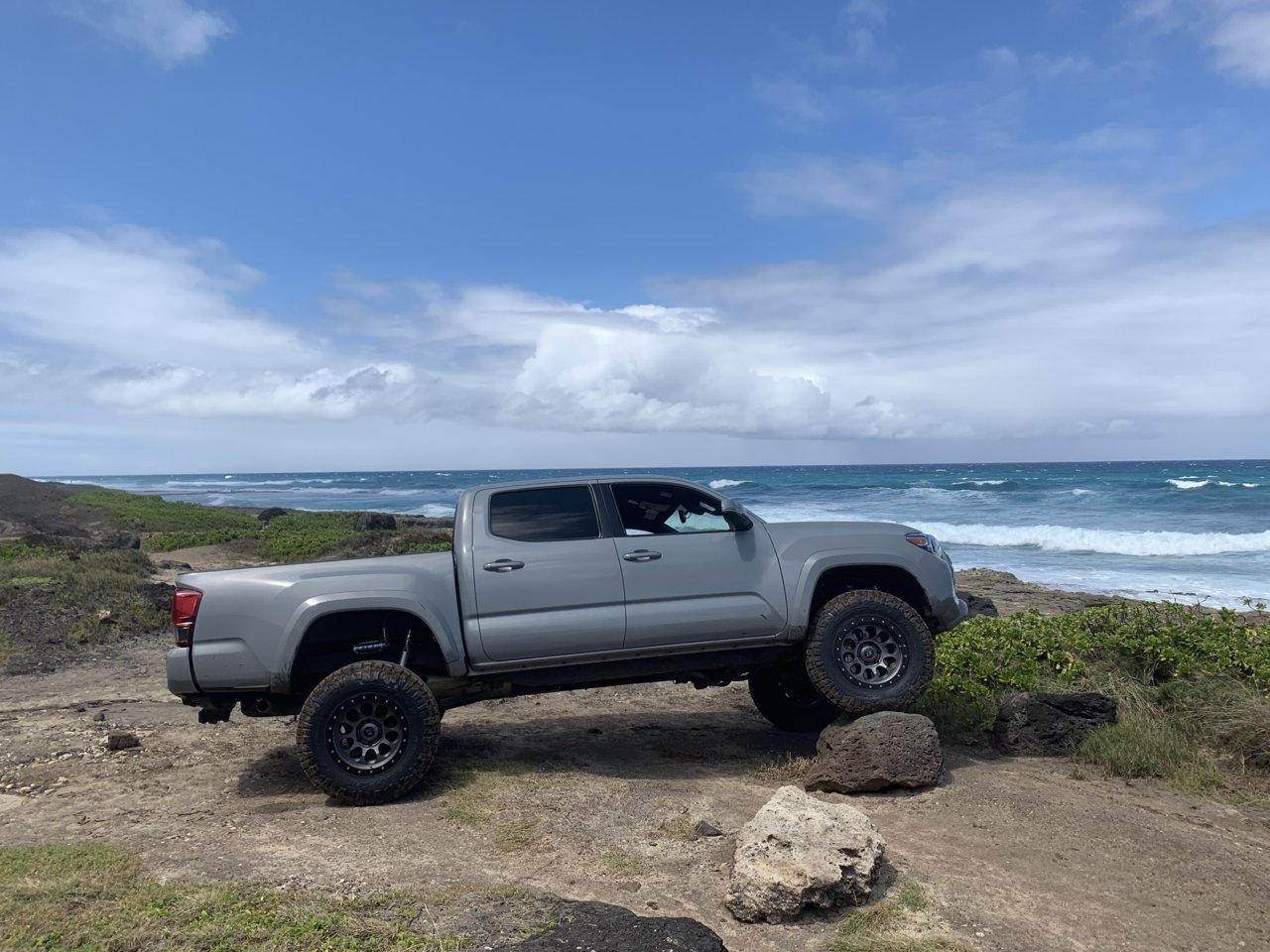

    King suspension, deaver j66 leafsprings, ray10s 17x8.5, nitto ridgegrappler 255/80r17, TRD pro grill swap, Wet okole seat covers, tint. ARB lockers is on my to do list, I’ll probably mess it up.
    Third gen running 255/80r17 on scs ray 10s. Got about an inch of lift on the front from king coil overs, I rub at just about anything past straight. Lol I’m going to adjust the preload and try to lift it 1.5” more then take it in for an alignment.

    scary_xp
    scary_xp New Member
    May 21, 2018
    #254196
    4
    Oahu
    So I adjusted the preload I don’t rub anymore, I’m not sure what my lift is at but fender to hub is 24” all the way around the truck. I got some rub with the suspension flexed but normal driving around is fine. 730272FA-2400-4C89-B4FD-1A927D507341.jpg
