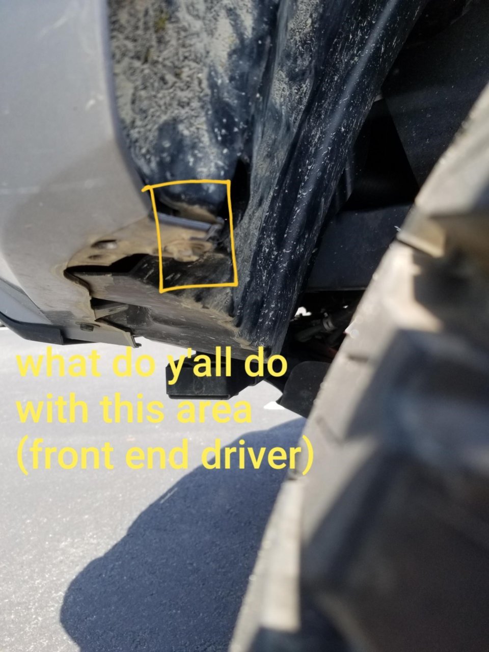

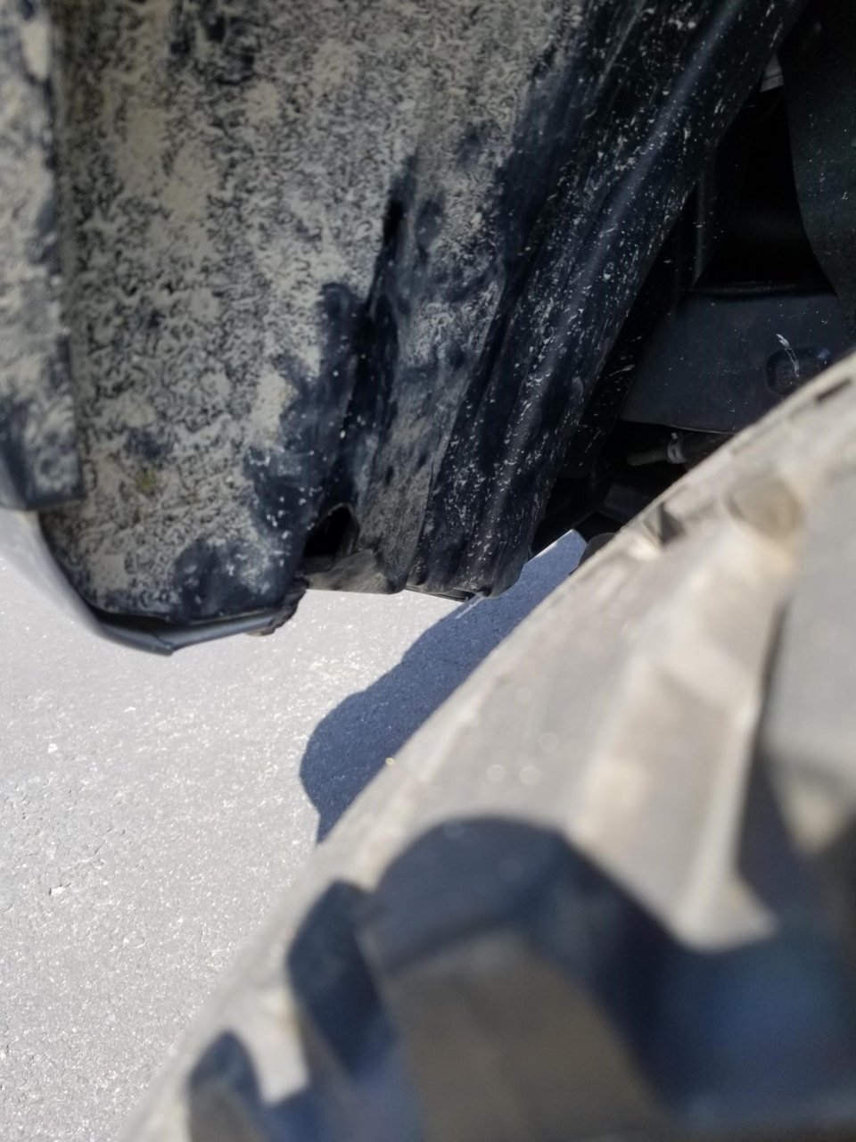

  5. May 28, 2019 at 12:35 PM
    #245
    Greg.Brakes.Tacos
    Greg.Brakes.Tacos Don't Feed the Animals
    May 24, 2018
    #254446
    3,703
    Greg
    Between Richmond and Virginia Beach
    2017 Taco DCSB TRD off road
    wanna be mods
    Background:
    • I went from 275/60r20 (20x9 -12offset, a 4.5bs) with a 3-n-1 pro comp leveling kit (this was part of the “Pro Comp” packaged that was on my truck from dealer).
    • I just jumped over to SCS S6 17x8.5 w/ -10offset and 4.3bs and wrapped them with 285/70r17 Goodyear Wrangler Ultraterrain ATs. Running stock UCA’s without any rubbing/interference.
    Normal daily driving on the new setup has produced no rubbing, however, when taking right turns uphill it appears that I've got rubbing on the front driver side liner (again at front of wheel well), and no apparent back of the liner/cab mount rubbing. I did trim off the obvious part of the liner on the front left (driver side) where it produced rubbing with those right turns on an uphill (and again when going down the incline).
    Since I’ve had the new setup on for 4 days, I haven’t had many opportunities to troubleshoot/produce more/other rubbing spots with various articulation/stuffing at various wheel turn angles…but don't have many easy and close areas to practice flexing.fender side view trimming caption circled trim spot.jpg
    Am I missing something here with folks trimming up and/or heat modify technique for this area where it appears the wheel well exterior trim (plastic grey on OR models) anchors to the actual bumper...are you guys chopping this off, too, or just bending/heating it to tuck up/under?fender underside screw aspect caption boxed.jpg
    QUESTION/FEEDBACK from Similar Setups (I know it ultimately comes down to each individual rig)
    Have you guys had any success using the jack stand and floor jack to get full droop and full stuff testing while turning the wheels? My neighbor has a big auto shop at their house with a two post vehicle lift, and was wondering if that would be the more secure/efficient & easiest way to try and see where trimming and how far back the CMC should be done?
    Here is the side/top-side view (left side of photo is the front end/actual bumper orientation) on drivers side.
    I presume almost all of the rubber liner would need to be molded for when suspension is stuffed, and I foresee getting my neighbor to do the CMC (and likely fab the plates in his shop) and might as well knock out the pinch weld while in there, but didn't know what folks have done with the area where the plastic fender attaches to the actual underside of the front bumper.
    So far the UCA clearance looks great...but once I am in a position to upgrade suspension (~2.5" lift up front, dakar medium rear leaf pack and upgraded rear strut likely), I'm sure adding the SP/LR UCA would just make life easier over all with alignment, etc.UCA w_Ultraterrain 5-27.jpg
    I have read through numerous threads and see most of the cutting pertains to CMC or the rear well liner area.
    Appreciate any and all feedback or insight you all might have!

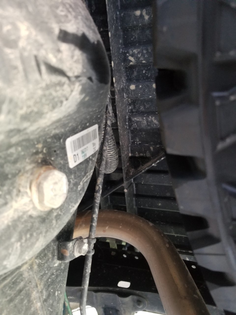

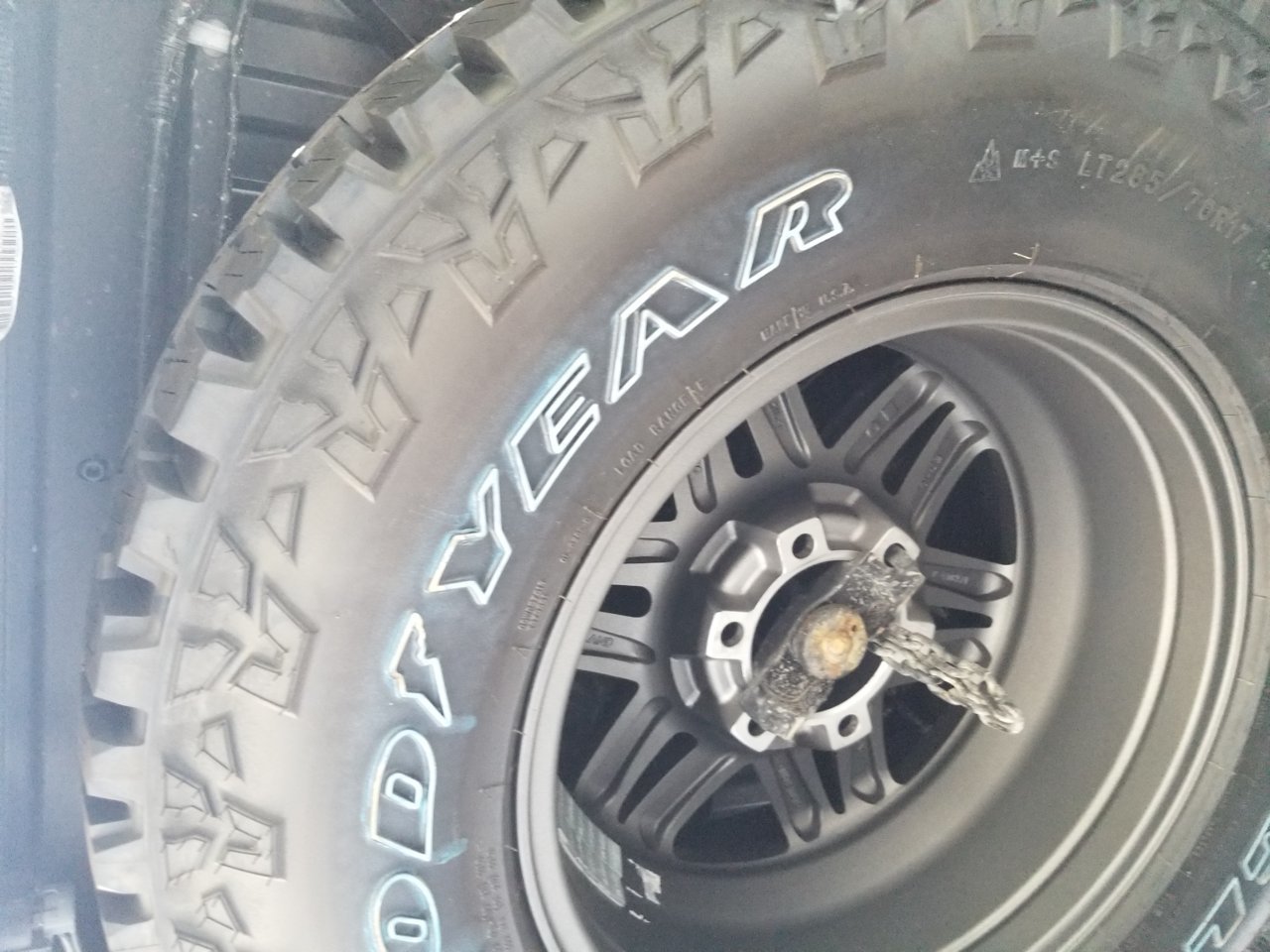

    as a side note... got the S6 17x8.5 with Goodyear Ultraterrain AT 285/70 up under the bed in the stock location... or I should say my Discount Tire manager got it up there without bending/banging on anything. 20190528_170932.jpg20190528_171212.jpg 20190528_171154.jpg
    20190528_171057.jpg rear diff clearance

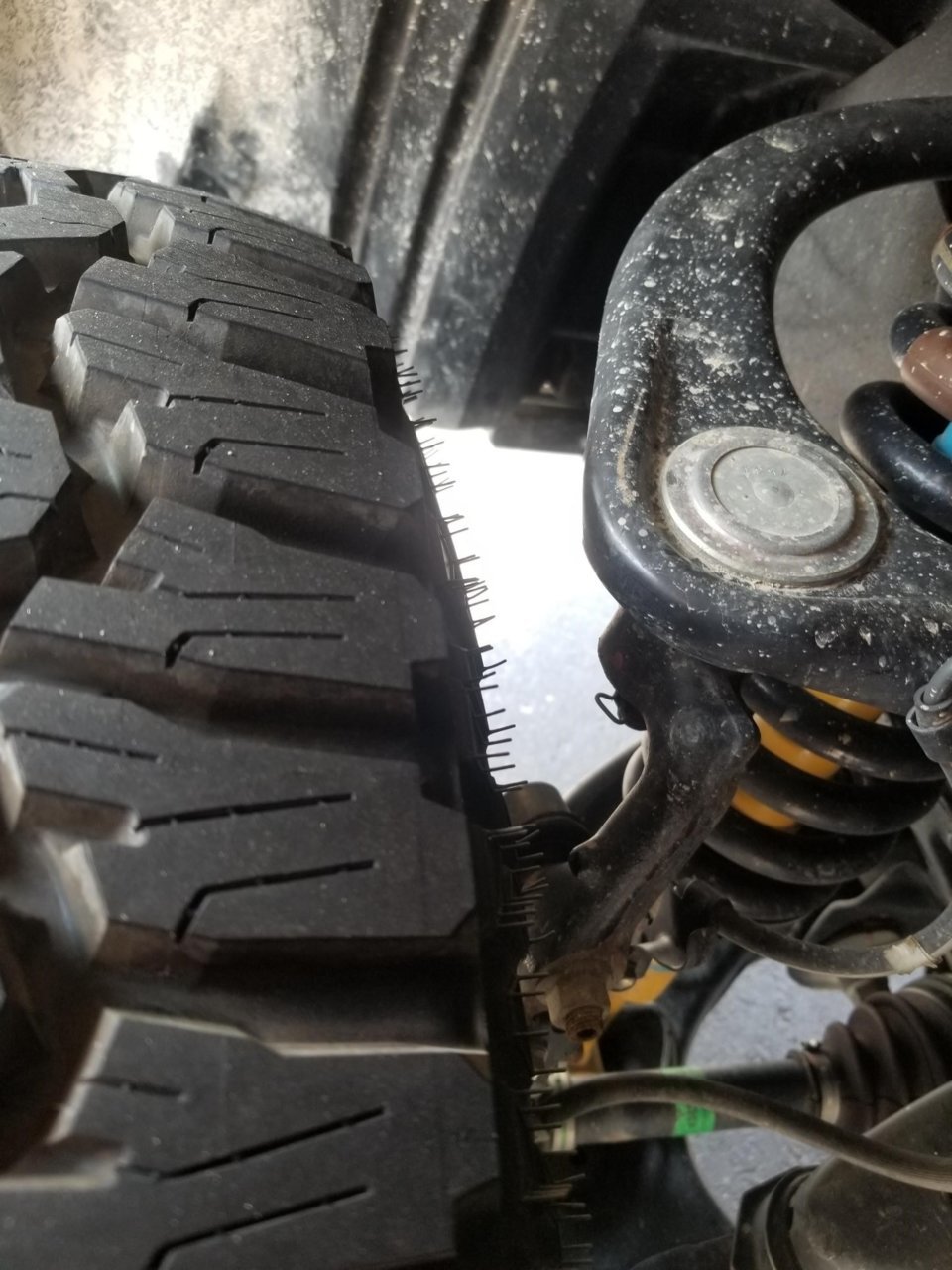

    285/70/17 and 275/70/17 will rub the upper control arm on stock wheels.
    Your best choice would be 255/80/17 which is a 33” diameter but narrow enough that you can use your stock wheels without rubbing suspension components.
