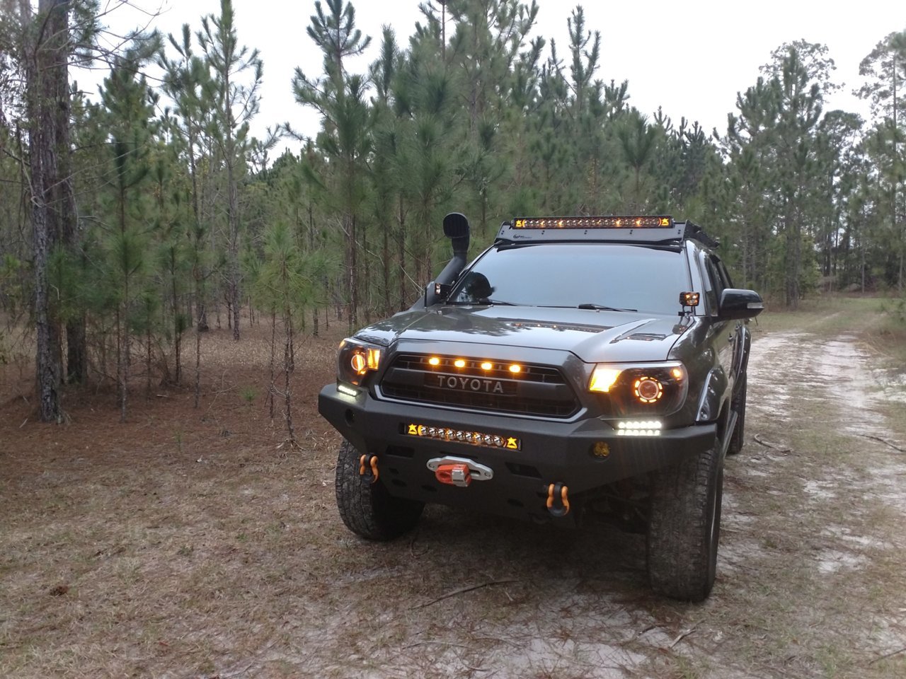

    Does anyone have any feedback here? I have
    2.25 Ironman full lift with UCAs
    17x8.5 -10 offset SCS Ray 10's
    I'm considering 285/70/17 or 265/70/17 Maxxis Razr AT's. The weight on these is amazing (43 and 39lbs respectively)
    I do not have a Cab Mount Chop and I have a clearance front bumper. Will I be good to go? Thank you! I'm currently running 2657516 Cooper AT3 4's.

    If you’re traveling and not rock crawling why add lockers? A rear locker would be wise, but lockers aren’t needed and you’ll likely not use the rear just overlanding.
    9.5” wide would be a poor choice. For one, likely too wide for the recommended mounting width on your tires. 8” wide with 0mm offset would be best, the 8.5” width would be next best.
    Are you looking at p-metric tires? Those weights are awfully low. Likely not LT rated which runs the risk of puncture or slash on rocks.
    265 will clear without CMC. 285 will more than likely need CMC.
