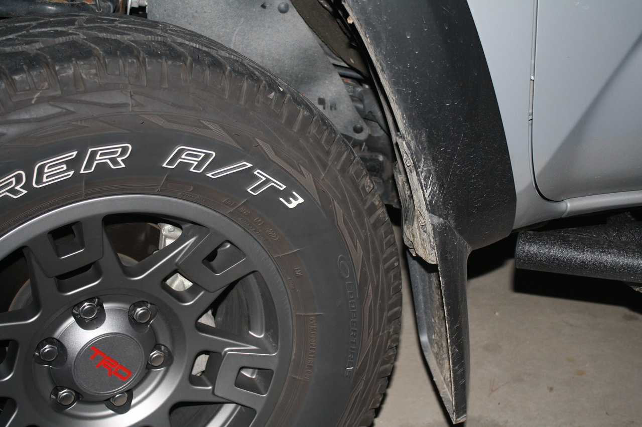

    275/70/17 stock suspension on mine.. no rub, room to spare... dont forget that tire size, and my truck is stock..

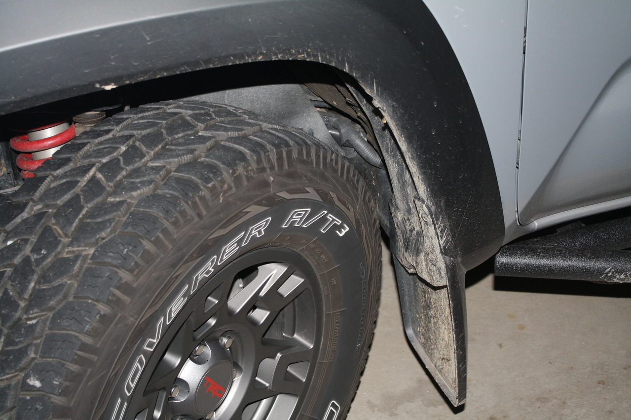

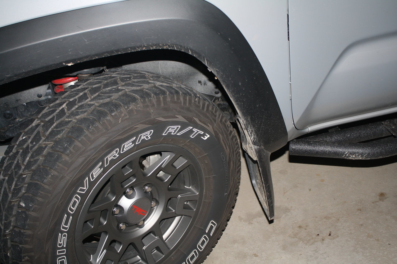

    Any chance you could share some pictures, show your wheels turned to give an idea of how much clearance there is between your tire and fender liner when turning?

    yes i can...there would be even more clearance with the flaps off,, they arnt much smaller than 285/70's.. but from the corner to cab mount there is still a 1 1/2 in of clearance,, they are cooper at3's 6 ply. but then again it is a Pro,,lol.. got IMG_5165.jpg IMG_5167.jpg IMG_5166.jpg

    Just what we need! Thank you for sharing the pictures. Hopefully will help a lot of people :cheers:

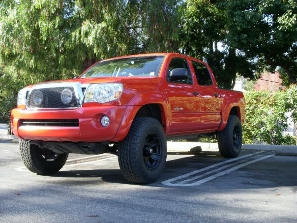

    @hammertaco11
    Here's an old pic but should help show what that set up will look like -
    17x9 -12mm offset 285/70-17 tires will bilstein 5100s at 2.5" and stock rear.

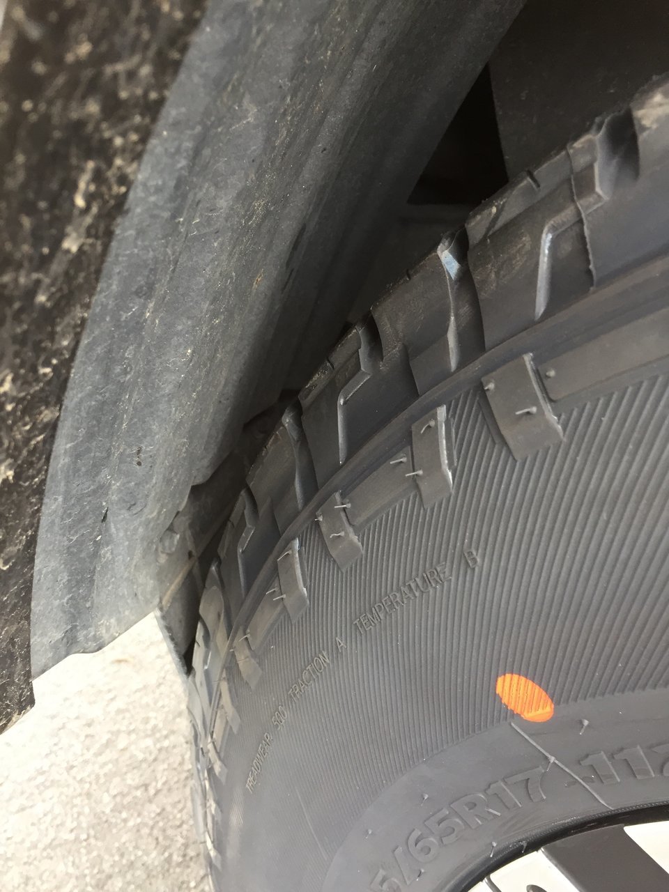

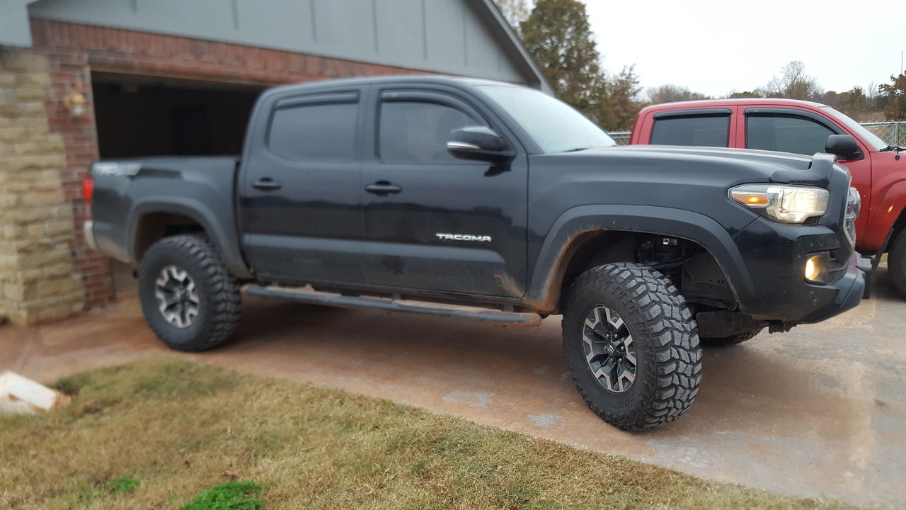

    I put ICON Alphas 17 X 8.5 BLK 6 X 5.5" 4.75" 0MM 106.1MM 2500 LBS and BFG KO2's 285/70/17 on my truck two weeks ago and dig the look but my truck needs to perform in the desert and mountains so I am having Jason @speedfreek do my CMC and pinch welds next week.
    I have already done a little trimming and have heard a little liner rub so I need to trim.
    I will update when done.

    Those wheels look great man!
    I assume you meant 285/70-17?
