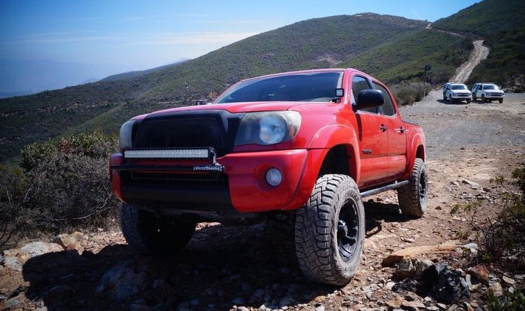

    I'm one rim size up from you, I have 295/70-17. Toyo RT.

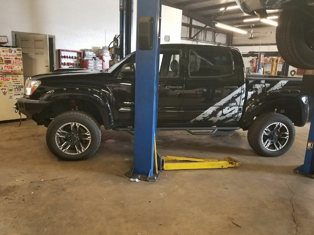

    Got your message about the potential sizes of tires. THANK YOU!!
    To be clear as mentioned, I know there will be no rubbing issues on the front . its the rear of the tire near the cab that I really do not want to get into cutting.
    The coilover springs with new shocks have all been installed that was supposed to be a 4 inch lift but due to the nature of adding the new heavy bumper and winch it settled down about 1/2" so I gained 3 1/2 inches in true lift but the wheel wells look like a huge area that needs to be filled but the clearance area to the rear of the tire towards the cab looks limited. There is some room for expansion but not much with a semi aggressive tread.
    also I do not have any mud flaps to worry about either.
  8. Feb 5, 2018 at 6:48 PM
    #68
    Ralbright
    Ralbright Member
    Feb 3, 2018
    #243376
    7
    2014 Tacoma XSP
    Toytech 4 inch coilover lift

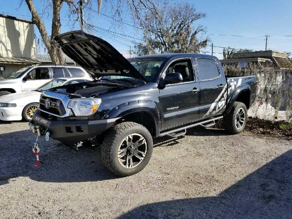

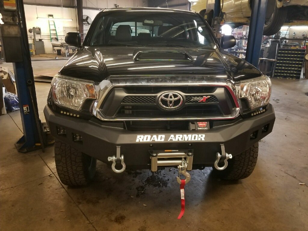

    Please see the attached finished product that I am dealing with.
    NOTE:
    The clearance in the front of the wheel does not seem to be the problem.
    the rear area looks like a lot of room but really isn't.
  9. Feb 5, 2018 at 7:02 PM
    #69
    eccracer104
    eccracer104 [OP] O.G. Member
    Apr 9, 2008
    #5854
    14,170
    San Diego, CA
    2016 Tundra 4x4
    Gotcha! I misread you the first time in regards to the tire clearance, I now understand you don't want to rub/trim/cut the rear of the front wheel well.
    I'd double check the lift specs. It's hard to tell, but it doesn't appear as though you have a drop bracket in the pictures you posted. On a 4x4 Tacoma, going over 3" of lift has a tendency to bind up the cv axles because they're at too steep of an angle. The only real way to achieve more than 3" is via a drop bracket...
    The 285 sized tires would be pushing it... there's a strong chance you'd need to do the CMC to eliminate rubbing. It isn't a major modification but if you'd rather not then we can ditch that size.
    255/80-17 would be a nice choice and a full 33" tire. It isn't as wide which means less chance for rubbing.
    265/70-17 would fit without any rubbing, but may be a bit smaller than what you're hoping for.
    A 275/70-17 might be right up the alley for what you're looking for. It's a good middle ground of height and width and shouldn't rub in the rear of the wheel well. It's a more difficult size to find, but it's out there.
