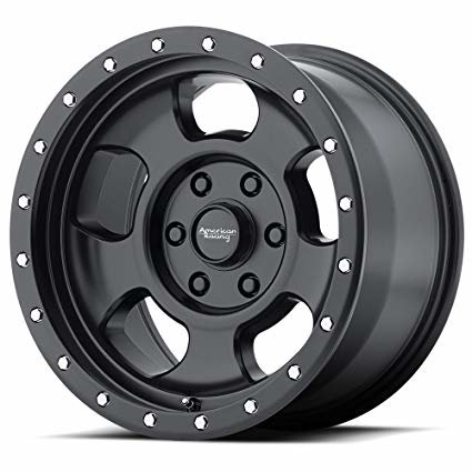

  12. Aug 20, 2018 at 8:58 PM
    #172
    eccracer104
    eccracer104 [OP] O.G. Member
    Apr 9, 2008
    #5854
    14,169
    San Diego, CA
    2016 Tundra 4x4
    Check out www.autoanything.com (where I work)
    http://www.autoanything.com/wheels-rims/Toyota/Tacoma/110A56004A0A0A17A173A1.aspx
    I’ll be out of the office most of the day tomorrow, so look around and if you like anything let me know. I’ll start a PM.
    You might like the American Racing Ansen. Close to the Crager but it does have a simulated bead lock.
