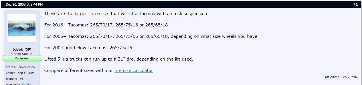

    The first bit of information I'll link over is courtesy of @tcBob
    https://www.tacomaworld.com/threads/largest-tacoma-tire-sizes-on-stock-suspension.67550/
    This is supposed to answer your "what's the biggest tire I can fit with no lift" questions.
    These sizes are tried and true as a reliable baseline to get people started.

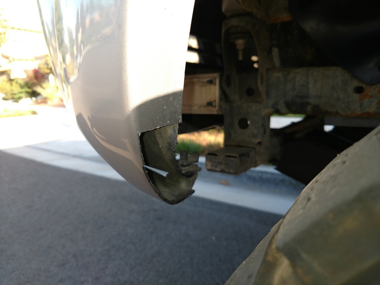

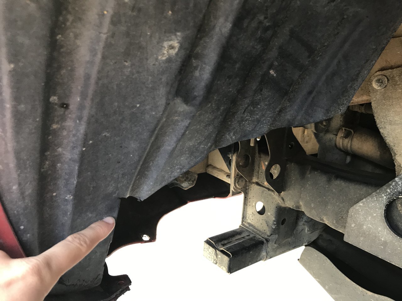

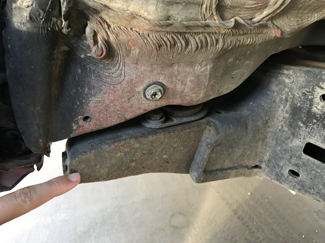

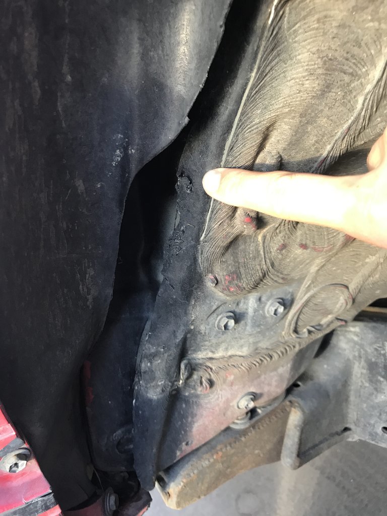

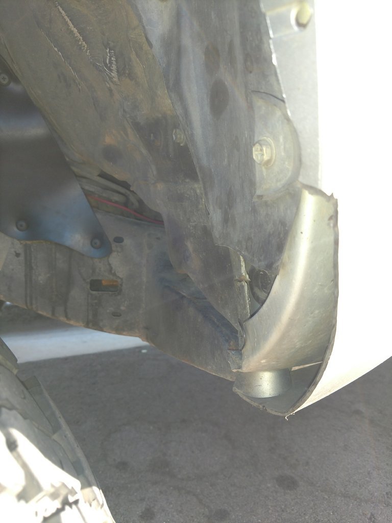

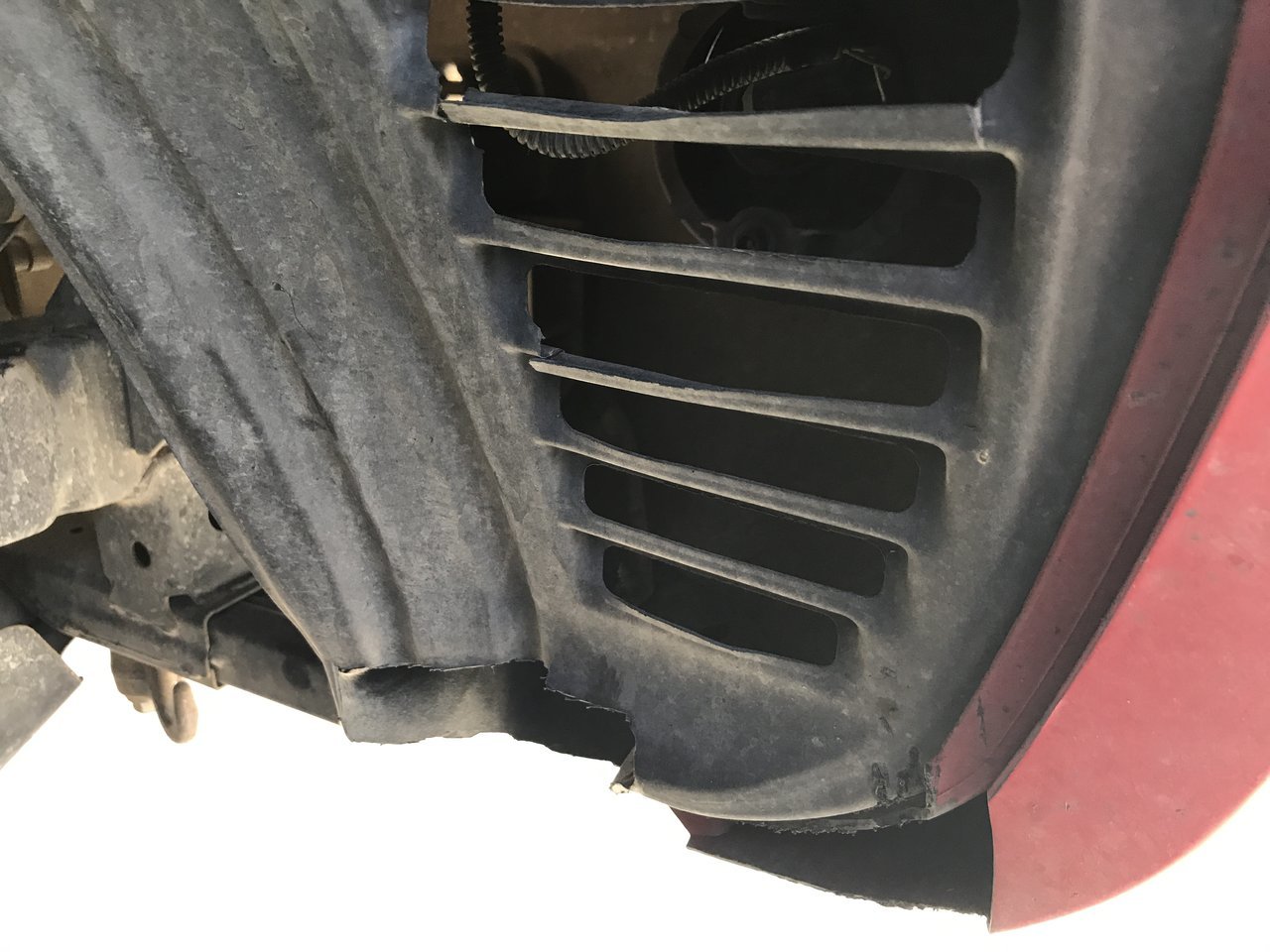

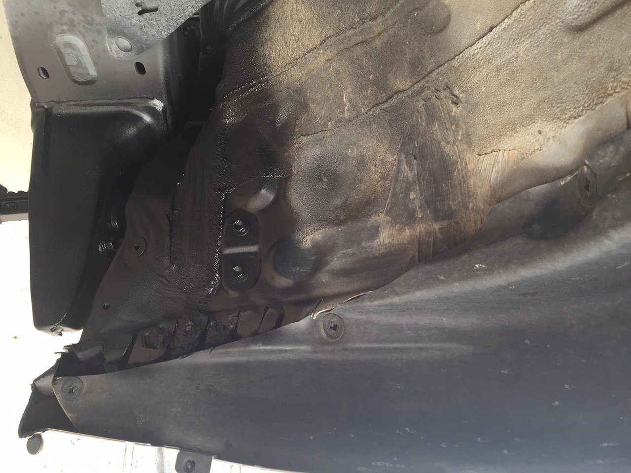

    The spot your tire will rub the most regardless of size or positioning is the black inner fender liner. This thin plastic is easy enough to cut with a pocket knife. Once you have your new wheels and tires on turn the wheel, see where the tire hits and trim accordingly.
    Depending on your tire size and wheel choice you may need to trim the bottom portion of your actual fender. This may be too difficult for a knife, but a dremel makes quick and clean work of this area.

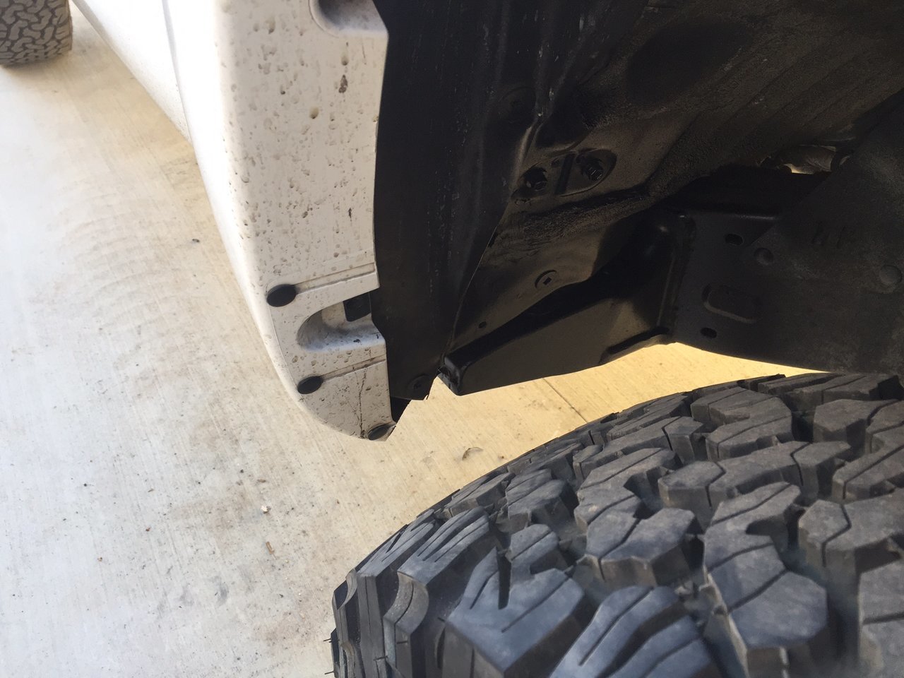

    The pinch weld is a section of metal that sticks out towards your wheel. The pinch weld is nicely tucked away and hidden behind the inner fender liner.
    If you have a large and heavy enough sledge hammer take all that hate from where this stupid pinch weld cut the side lugs on your new tires and beat the snot out of it. Hit it and keep hitting it until it's been folded flat. Apply some paint to prevent rust. Crack a cold beverage and enjoy a job well done.
    Tool requirement to fix this:
    BFH
    Big guns (or a dremel)

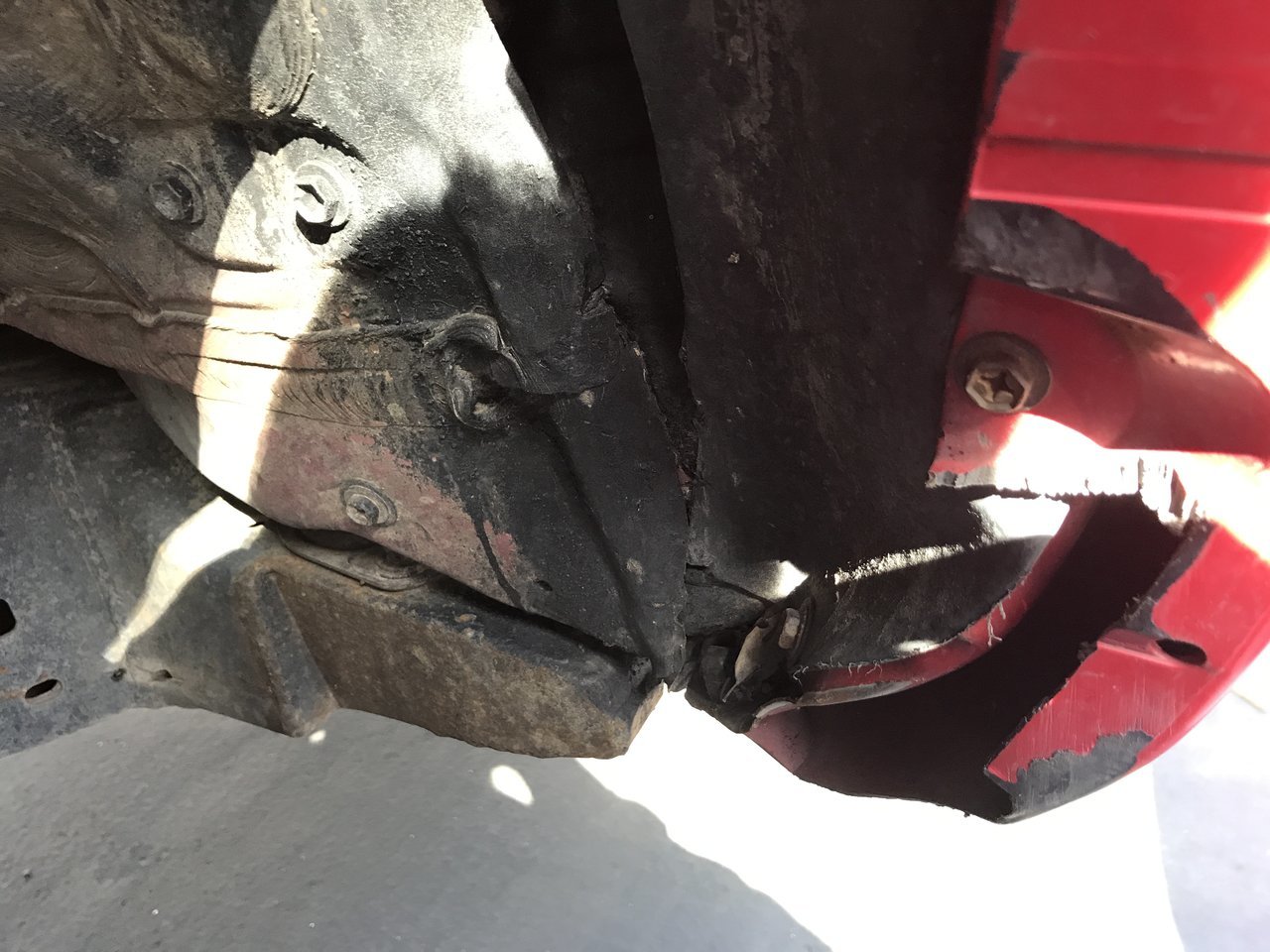

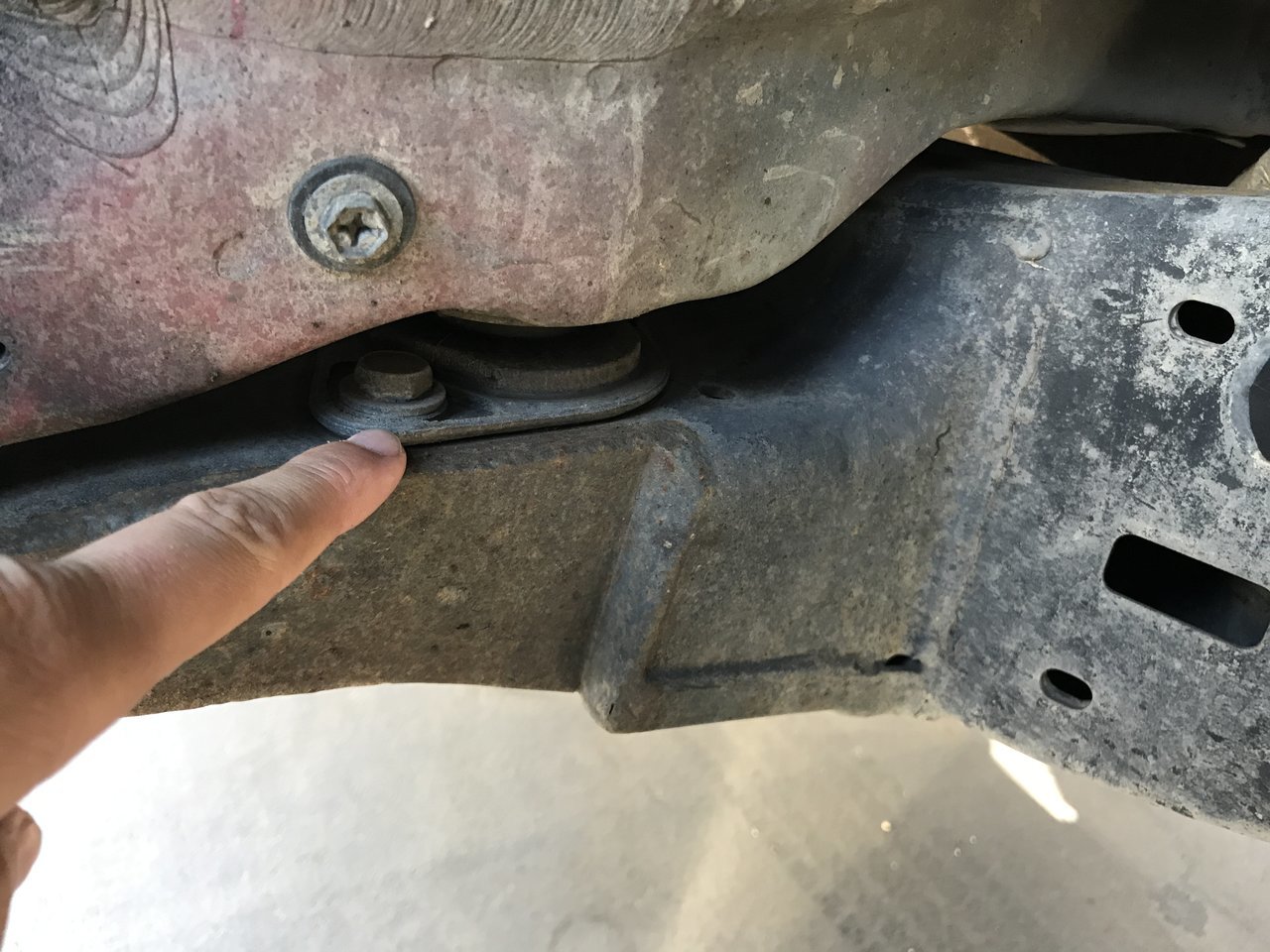

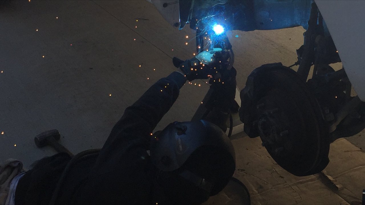

    The infamous Cab Mount Chop:
    *First know the guy who did mine had never done one before. Nor had I seen pictures so we just kind of went for it. There are shops and installers out there who can do a much cleaner job, granted this one looks decent and does the job.*
    CMC location:

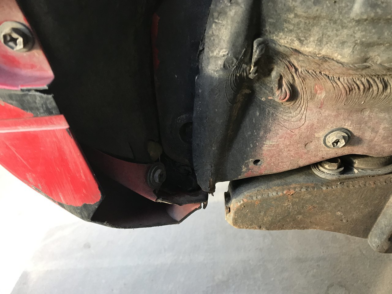

    Look at the back of the wheel well at the other culprit to chopping up your beautiful new side lugs. This is what will be cut and then plated in with new metal. It provides more clearance for your beefy new tires to turn without catching on anything.
    This does require welding, so tackle it at your own risk or recruit a professional.

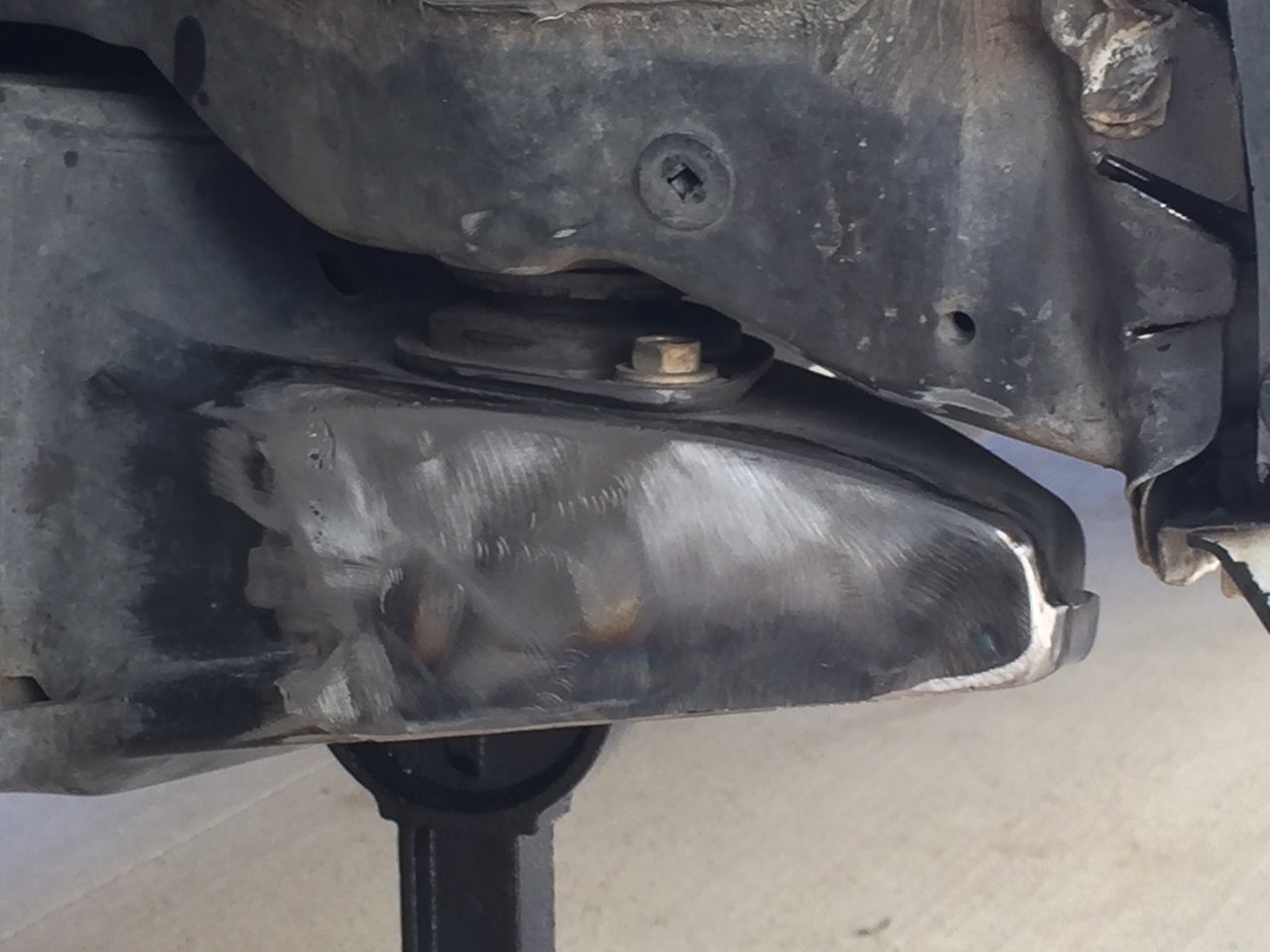

    Stock cab mount -
    Chopped cab mount -

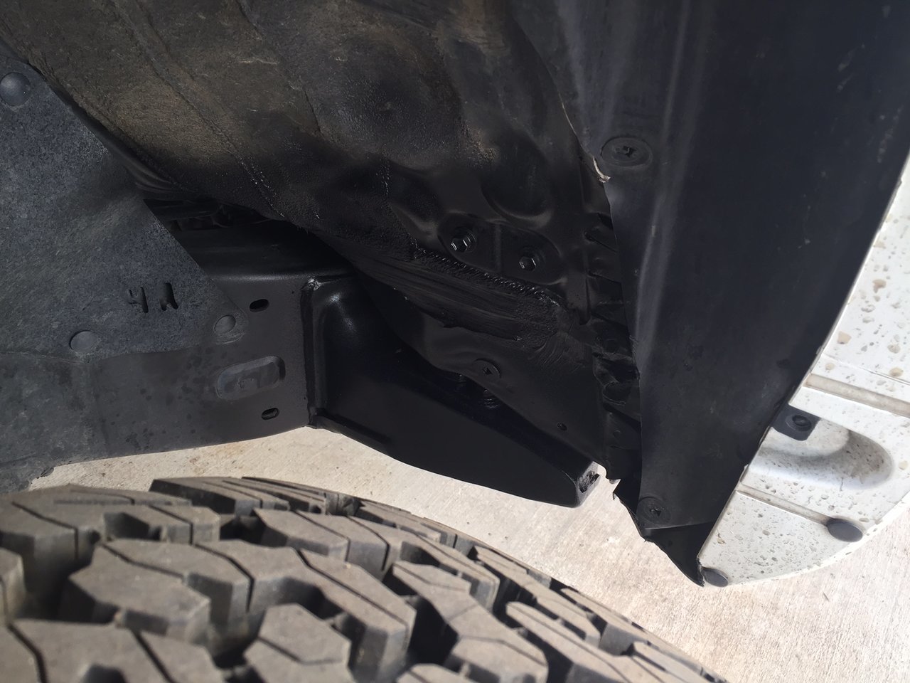

    And just for sport this is the cab mount -
    Ahhhh beautiful clearance -
    Don't fear the cutting and trimming, your IG posts will get more likes with your cool big tires and now you can explore outside the mall without fear of rubbing. Unless your head is in the wheel well you won't really see any of your cutting.
    And from a distance you can't see a thing

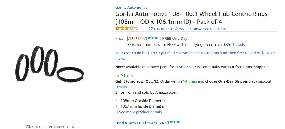

    Hub centering rings -

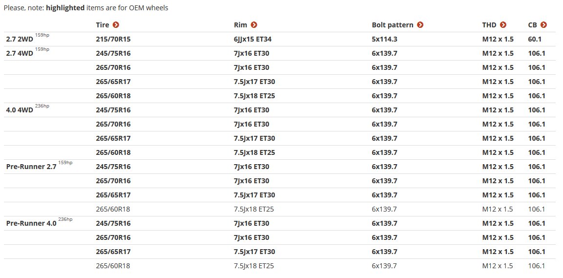

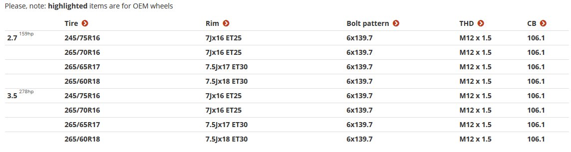

    As for factory wheel specs, here is what is listed per 1st gen Tacomas -
    2nd gen Tacomas -
    3rd gen Tacomas -

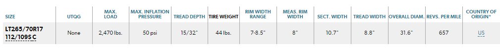

    First thing you need to do is check the allowable specs of your tire.
    Let's start with some KO2's bro :headbang:
    Let's say you went up to a 265/70-17 because you wanted something a little bigger than stock, your truck is stock height and you found these sweet 17" x 9" wheels.
    Quick check to tirerack shows us that rim width range is 7" to 8.5" wide.
    You could still use this, people stretch tires, but you run the risk of your tire popping off the bead because your wheel is too wide for the tire.
    However there's a light at the end of the tunnel so you can use those cool 9" wide wheels you like so much -
    These General Grabber AT2 tires come in a "P" or "Standard load rating" and thus have a more flexible sidewall.
    These tires are the same size, but will mount up to a 9" wide wheel.

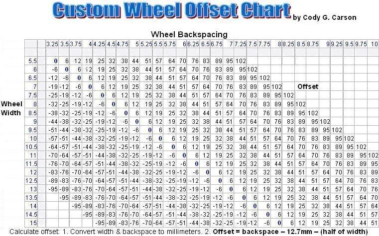

    Back spacing and offset are a measurement of the wheel.
    0mm of offset for example means that the hub mounting location is dead center on the wheel.
    To help better understand this while making it more confusing at the same time:
    An 8" wide wheel with 0mm of offset will have 4.5" of back spacing.
    A 9" wide wheel with 0mm off offset will have 5.0" of back spacing.
    "What that doesn't add up, if it mounts in the middle it should be half of 8 inches? That's 4 inches of backspacing. Who is this idiot!"
    Wheel widths are measured on the inside lip where the tire beads, so an 8" wide wheel is actually 9" wide outside to outside. The backspacing measurement is measured from the outside edge of the wheel and half of 9" is 4.5"
    This also means a 9" wide wheel is 10" wide overall hence a 0mm offset will yield 5.0" of backspacing. You lower the offset down to -12mm to move the hub mounting location half an inch closer to the back of the wheel and voila you have 4.5" of backspacing on a 9" wide wheel (which is 10" outside to outside).
    Something to consider while selecting your wheels is that the wider the wheel and the further it sticks out, the more rubbing you will have.

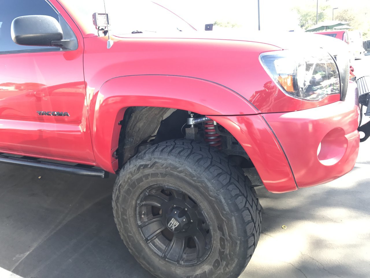

    Please reply with pictures of YOUR fenders cut/trimmed and your wheel and tire specs. I'll update this post in an attempt to cover as many sizes, options and gens as possible.
    @FishingInSand

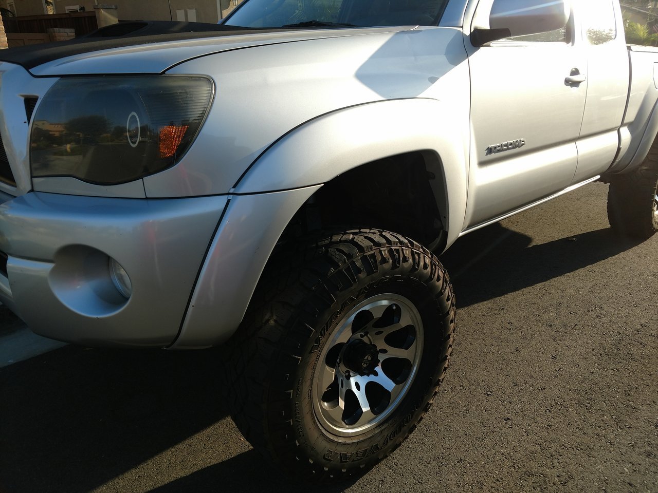

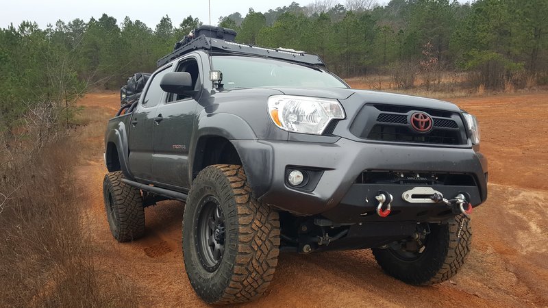

    No rub on body mount. Trimmed some plastic.
    285/70/17 GY Duratracs on 17x9 Level 8 Bully Pro w/ -12 offset. King 2.5 extended travel, 700# springs, Icon billet UCAs up front.
