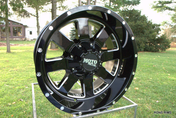

    Ok, I need help in purchasing my first ever set of wheels.
    I have a LR UCAs and a 3" OME lift kit with a AAL in the rear sitting in my garage waiting to be installed.
    This is the wheel I am planning to get:
    18" x 9"
    At that size, it is available in a 0 offset and a 5" backspacing.
    Does anyone know if I would have any issues with:
    265s or 285s?
    Still havent decided on a tire size, just seeing what could be done.
    Please offer suggestions or ideas.

    The smaller number the BS, the more the wheel/tire is pulled away from the suspension..

    Yr good with 265's

    265's no problem...any 33" tire is gonna require some trimming, mud flap removal, and maybe a CMC depending if you have adjustable UCA's which can help you with more clearance..
