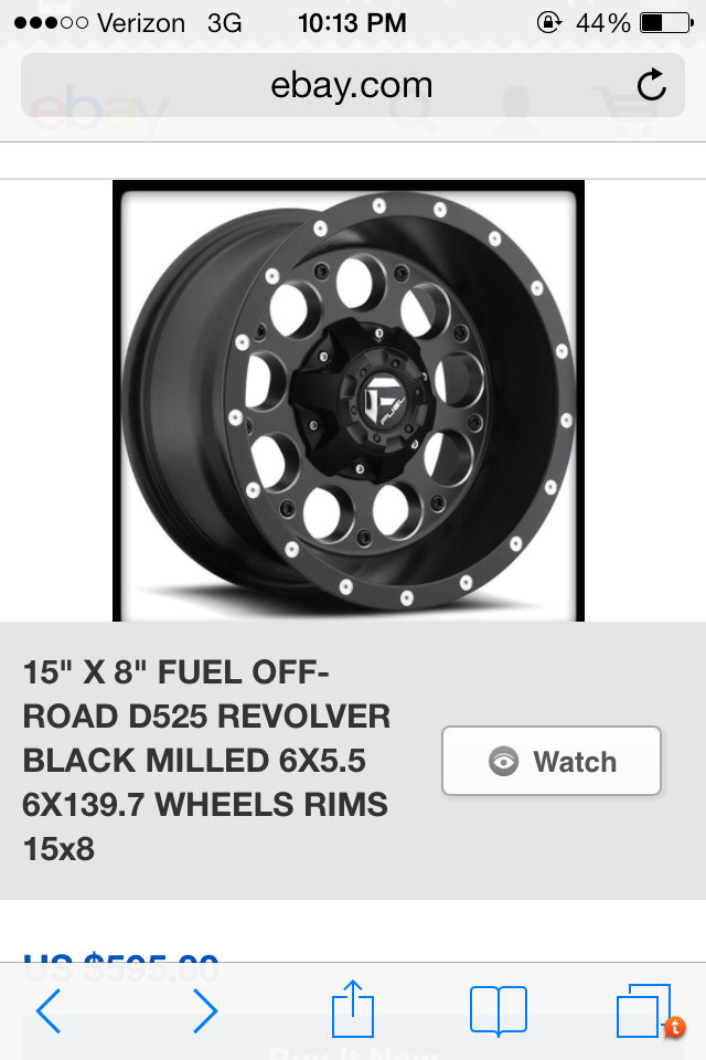

    Hey guys, I dying to put these on my 99 prerunner with stock suspension and I was wondering what backspacing and offset I would need to make these fit! Thanks for the help!!
