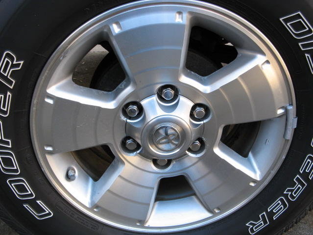

    TRD Sport Alloy Wheels: 17x7.5
    Lug bolt Pattern 6 x 139.7 mm
    Lug bolt Pattern 6 x 5.5 in.
    +30 mm offset
    5.5" backspacing
    108 mm hub bore
    HUB CENTRIC
    28.9 lbs
