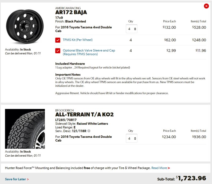

    I spec'd out my wheels and tires for 2016 DCLB OR.
    - American Racing (AR172 BAJA)
    - BFG TA/KO2 285/70/17
    Considering AllPro or ToyTec 3" (2" on 2016) kit.
    Q: With this size, do I need 1" body lift in addition to susp lift?
    Q: Anyone have experience with these wheels? I assume these are hub-centric and I will need an adapter ring for proper fit?
    Q: TPMS - Should I just get wheels and buy tires locally and have dealer transfer existing TPMS to save money? (Will I actually save money ?)
