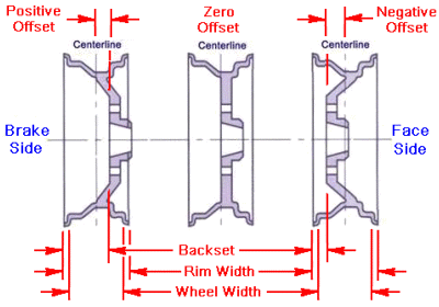

    A stock Off Road wheel and tire is; 16"x7", +32mm offset, 5.25" backspacing, 265/70/16
    Backspace and offset(+ or -), are only indirectly related.
    If calculating backspace when only given the width and offset, you have to account for rim width vs wheel width.
    Typically, rim width is 1" greater than wheel width; we must calculate using the rim width.
    8"/2=4"+32mm(1.25")=5.25"

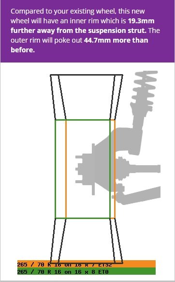

    Stock vs 16"x8", 0 offset w/ 265/7016

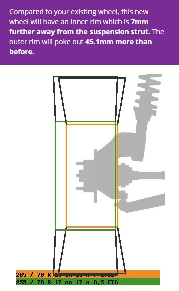

    Stock vs 17x8.5, +6mm offset w/ 255/70/17
    Of your two choices, both will stick out about 1-3/4"(45mm).
    This may or may not affect steering arc clearance; made worse with a larger tire.
    The 16x8 looses 3/4"(19.3mm) of backspace.
    The 17x8.5 looses 1/4"(7mm) of backspace.
    Reduced backspace helps in suspension clearance when lifted to a point, depending on tire size.
    You get diminishing returns as far as clearance, trying to push out a large wheel/tire; it eats into the steering arc. This begets a cab mount chop usually.
    Here's the calculator for the above comparisons.

    I think you're hung up on an offset measurement. Rim width and offset determines what your back space will be.
    OEM is a 7" rim; the one you chose is 8".
    Since offset is based off centerline, a 7" rim would need more positive offset to have the same backspace as a 8" rim.
    Or stated another way, an 8" rim requires more negative offset to have the same backspace as a 7" rim.
