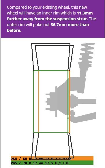

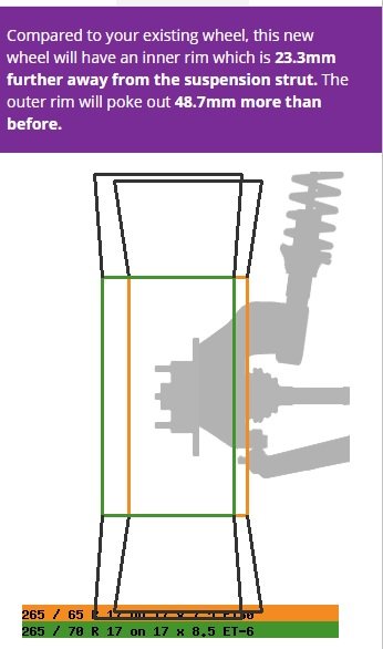

    Splitbolt, you seem to know your stuff. I just joined here and was hoping you could help (or anyone else!). I'm getting a 2" OME full suspension lift on my 2008 4x4 trd sport double cab taco. It seems like the best tire size without trimming even with the lift is a 265/70/r17. I'm also thinking of getting some Fuel Anza wheels that are 17x8.5 and come in either +6 or -6 offset. I believe that means 5 or 4.5 BS? I'd rather my wheels not stick out much, but would the +6(5 backspace) fit ok? Current stock wheel specs are 17x7.5 +30 offset (5.5 backspace). Thanks!!!
  4. Nov 1, 2016 at 6:09 PM
    #744
    splitbolt
    splitbolt Voodoo Witch Doctor
    Mar 7, 2010
    #32761
    7,858
    NW Arkansas
    2016 TRD OFFROAD DCSB MGM
    I would think so; plenty of guys running OME with the stock wheel.
    You gain clearance from the suspension/steering components with less backspace.
    You are correct on all your backspaces.
    +6 offset(5"BS) on a 8.5" will protrude 1.5"
    -6 offset(4.5"BS) on a 8.5" will protrude 2"

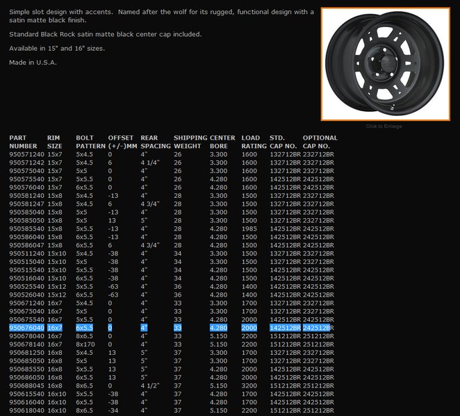

    2012 SR5 2.7 AC 4x4 Manual
    Can anyone confirm these Black Rock Lobo steel wheels fit the 2016 taco? Seems like the one I highlighted would, ty

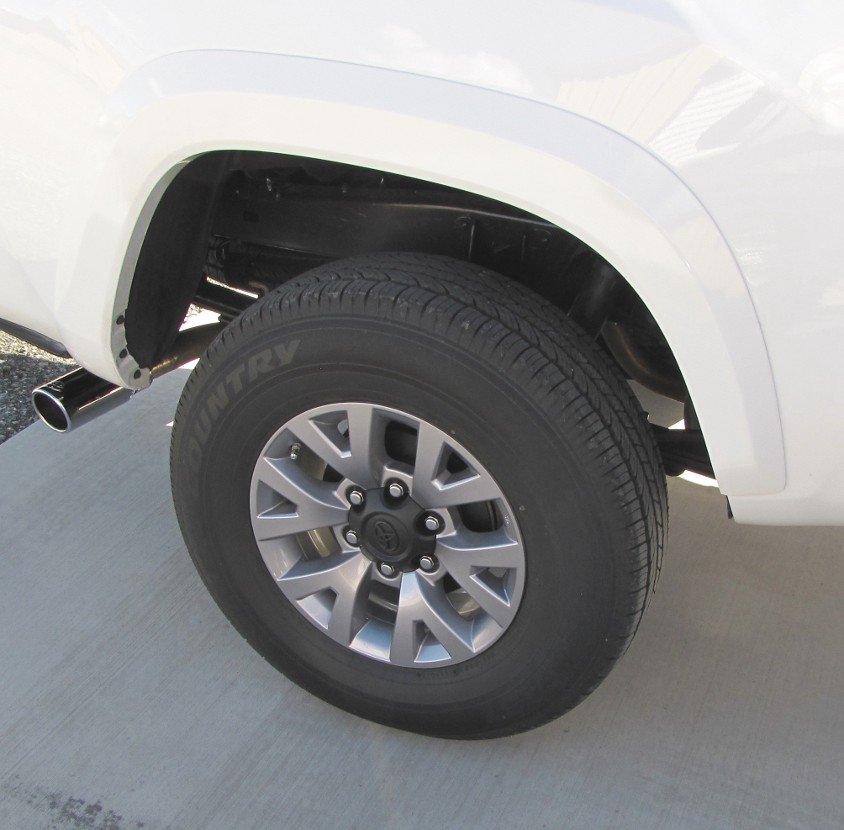

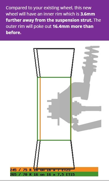

    I’m planning on buying some Trail Team rims for my 2017 SR5, in 16” x 7.5” with 15mm offset which will replace the silver 16" x 7" spoked alloy rims that are on it, and I don’t know what the offset they have.
    I know the 16” x 7.5” Trail Team rims will fit my 2017, but what I was curious about is how much farther out approximately will the face of the rim be compared to the stock alloy wheels, and I assume that the Trail Teams 15mm offset is positive.
    For the time being since the 245 / 75 R16 tires only have 3000 miles on them I’m planning on running them on the new Trail Team rims for awhile, and then going with 265 / 70 R16’s.
    Here is a pic of the rims that are on my 2017
  14. Nov 27, 2016 at 8:47 PM
    #754
    splitbolt
    Mar 7, 2010
    #32761
    7,858
    NW Arkansas
    16.4mm/0.65"

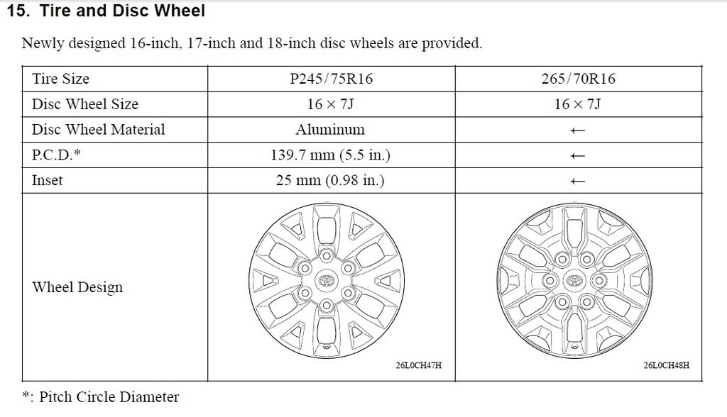

    2017 Cement TRD Pro
    Anyone know the spec on the 2017 Tacoma pro wheels? I think they are 16x7. backspacing and offset?
  18. Dec 10, 2016 at 12:20 PM
    #758
    splitbolt
    Mar 7, 2010
    #32761
    7,858
    NW Arkansas
    16X7;13mm offset.
    4.5" backspace.
