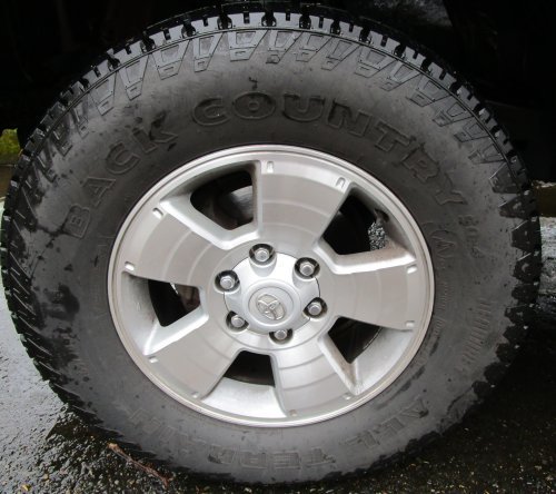

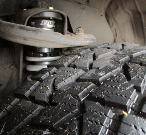

    Exactly my dilema. I have 2nd gen wheels on my 02 Tacoma. From reading this thread the factory wheels I have on now have a 5.5 Backspacing. And wheels that came on my 02 have a 4.6 backspacing. The tires are 265/70/R17.
    I had Fox coilovers installed last week, along with Fox and Deaver (springs) on the back. And now my UCA's are very close to the tires. The installer said if I had stock wheels my UCA's would have more clearance than they do now. They do not rub unless I am airborne.

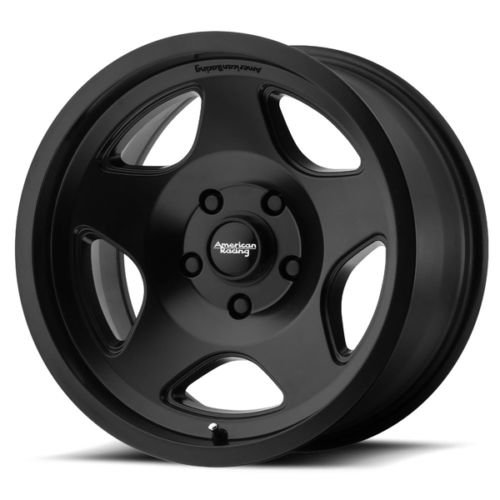

    For me I think the best way to get my tires away from the UCA is to get a wheel with the correct offset. Besides, it is time to get something in black. Searching around the net has been tough. Mainly because I want something without a bunch of bolts running around the rim. Something clean like this: American Racing 17x8- http://www.wheelsforless.com/AR92378060700
    They have 0 offset and a 4.5" backspace, which I believe is what I need. The Stealth 6 and F5 are a couple more I really like. But only the F5 comes with a 0 offset. And it is a 16".
    So I am open to wheel suggestions. Thoughts anyone?

    Original wheels have the wrong offset. After 2005 it changed i believe. Gotta get more clearance between my UCA and tire.

    No I mean the 02 wheels
    I thought you said they have 4.5 B/S
    Edit:16" wheels?? 17" tires??

    Tires are 17" and wheels need to go bye bye.
    I think the ones I have now have a 5.5 backspacing. Changing to a 4.5 should get my UCA 1/2" further from my tire.
    Unless I read 39 pages and missed everything.

    Right!!
    maybe i misunderstood your post about the original wheels
    Here is a handy chart that may help with your wheel decision

    Thanks 303. Think I'll head to Les Schwab tomorrow and see if they can order up a set of these.AR.jpg

    You may want to get some hub centering rings too, because these wheels have 108mm hub bore and are not hub centric.
