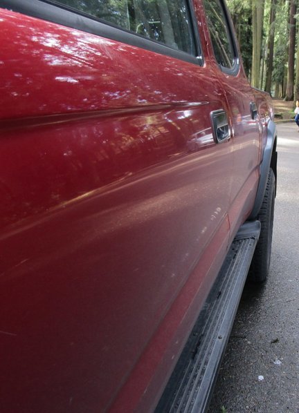

    Got the Level 8 Wheels mounted up last week. Much better than what I had. And with the correct offset the tires are definitely out a little further. But not enough to affect anything. The big win is I have lots of room between the tire and my UCA.Wheel_sideview.jpg Wheel_sideview_02.jpg

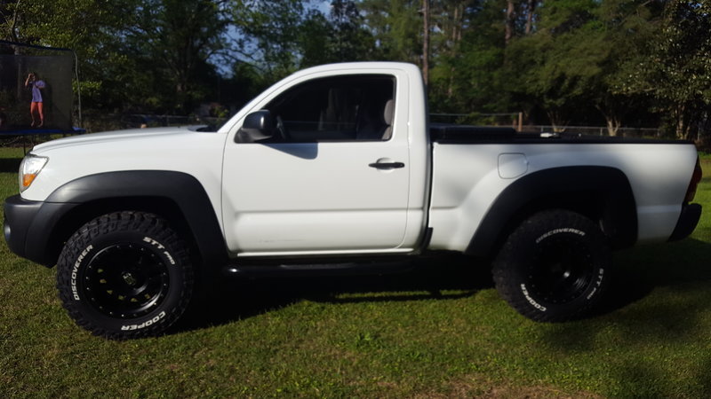

    I just installed 265/70/17 cooper stt pro on 17x9 -12 offset and got a lot of trimming to do.
    Within 1/4 inch from rubbing cab mount20170414_174828.jpg

    wow, i'll be on a 2.75 in front lift 2.5 in the rear, do you think that extra height would make things not as tight? How do the rims sit in the wheel well, do they stick out much further than the stock setup?
