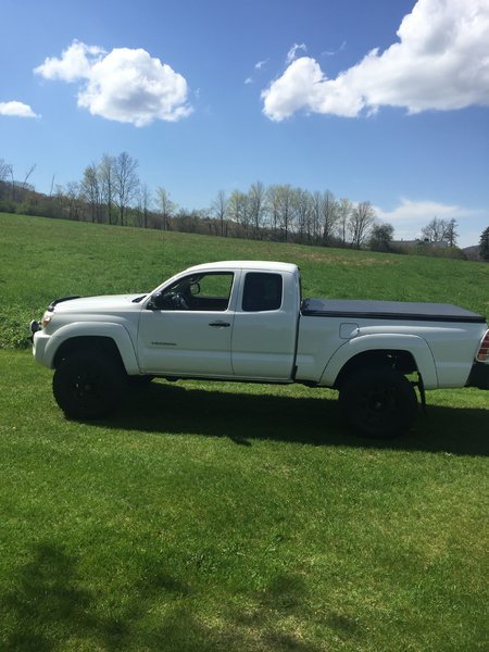

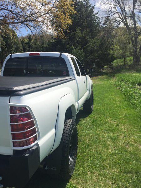

    lynyrd3
    Apr 9, 2008
    #5848
    35,420
    Bill
    East Central Upstate NY
    303tacoma[QUOTED] likes this.

    Looks good
    Did you go with 265/75/16?

    285/70 17 . Just removed front flap . Very slight rub when in reverse , full lock .
