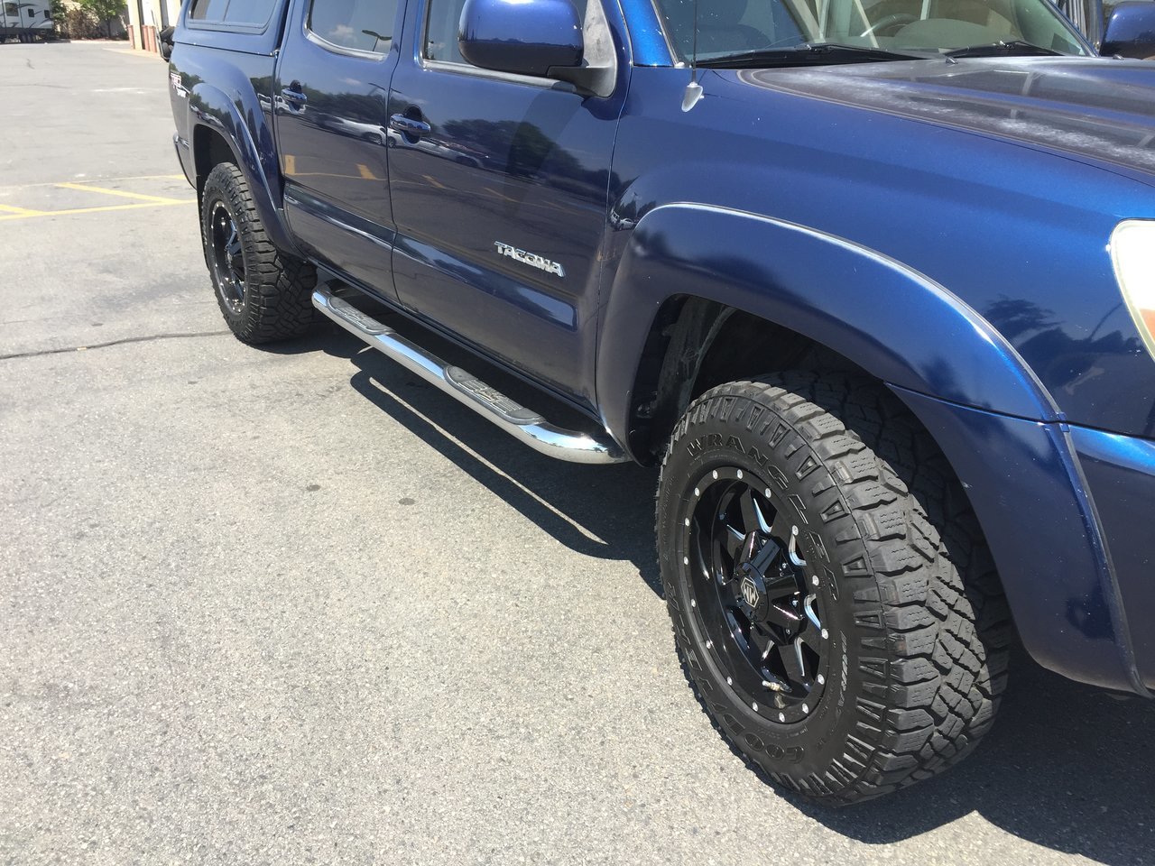

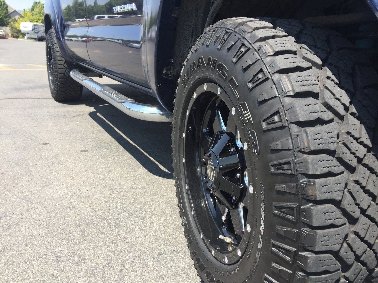

    Ok so here it is. 17x9 +18mm offset. 265/65r17 tires. No rubbing or clearance issues.
    splitbolt[QUOTED] and 303tacoma like this.
