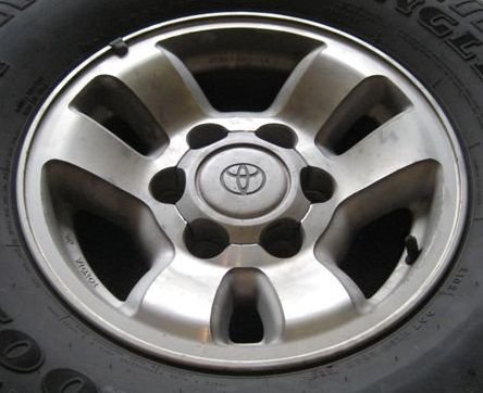

    Assuming the 3rd gen brakes are the same size as the 2nd gen, any 6-lug Toyota wheel 16" or larger, should fit. Only exception is this wheel:
    70269d1213129488-set-4-15-x-7-6-spoke-6-_659409da1223de7eaf025346797925d44292cad6.jpg
    Typically, wheels from a 4Runner, FJ cruiser, 1st gen Tacoma have slightly less back space (less positive offset) than 2nd gen Tacoma wheels. I'm not sure what the typical offset of 3rd gen Tacoma wheels are.
    Given that info. Google away for pictures of the other wheels.
