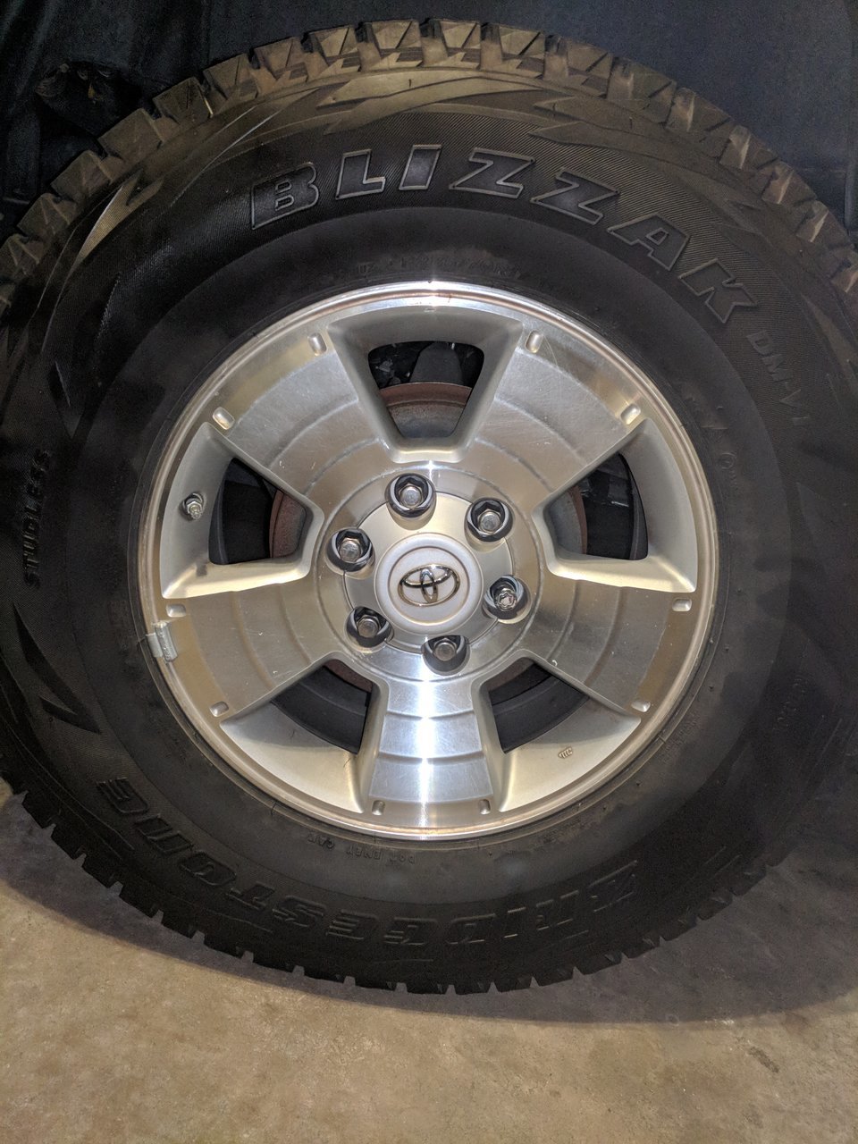

    Just for clarity
    What I have:
    What I am thinking (typically the 17s are from the FJ or 4 runner)

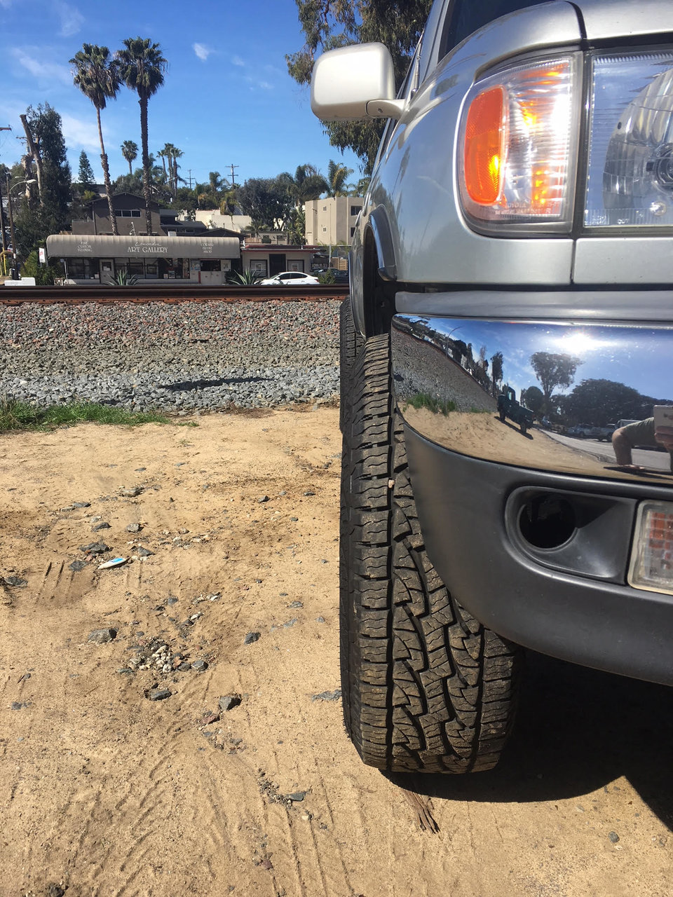

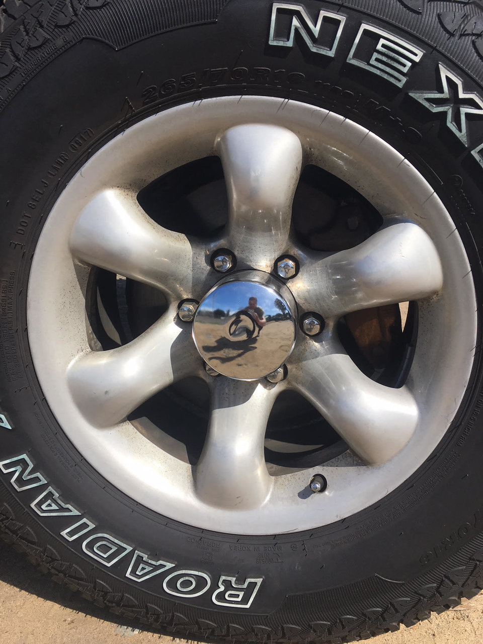

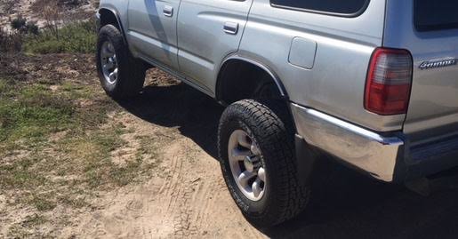

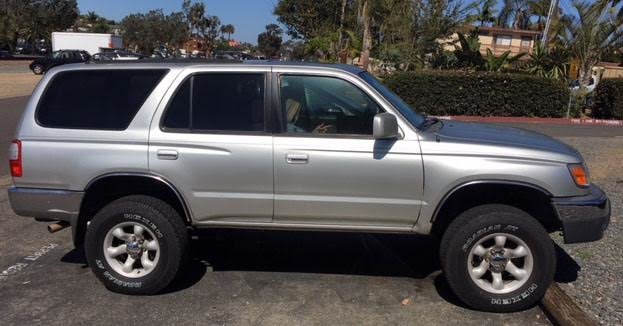

    Not sure this is the best thread, but I'm trying to figure out what brand/style and — more importantly — what offset/backspacing the wheels in the pics below are. I just picked up a '99 T4R SR5 (what can I say, love 3rd gens) and was hoping you guys can help me figure out.
    They have pretty decent stance, especially considering they are only wrapped in 265/70R16 AT's right now.
    Looking to go up to 285/75r16 (and some SCS wheels when they get back in stock) but would love to figure out what these wheels are and what the specs on them are. Honestly, they look pretty good. I might keep as a backup set and paint with some Graphite Duplicolor!
    I figured if anyone knows it'd be the guys on this thread, so please let me know if you have any ideas.
