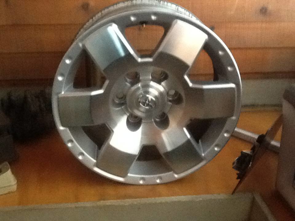

    The FJ wheels that measure 16x7.5 +15mm?
    Are you lifted?

    Yes I have 6112s at the top setting.... so about 2 to 2.5 inches.
    Its these wheels...
    I just powder coated them black. I like the offset with the 1.25 spacer and the 265/70-17s. I'm doing a CMC, and I'm sure they would be fine on the inside at the UCAs. Just not sure about the area above the cab mount.
    Thanks

    Option #3 would clear.
    This guy is running 295/75/16 on the FJ rim without a spacer and 2" lift w/ SPC UCA's.
    It's about 3/4" taller and 1/2" wider than what you have planned.
    He clears suspension and just barely rubs on compressed turns; not enough to justify a CMC.
    https://www.tacomaworld.com/threads/295-75-16s.518783/
    I'd go with option #3...
    -285/75/16 on a 16x7.5 +15mm(without spacer) is pefect, IMO; doesn't change the scrub radius
    -285/75/16 has a rim width range of 7.5"-9"; measured rim width of 8"
    -option #2 only pokes 1/2" more than option #1; not a make or break deal at that point, considering they both include 1.25" spacers
    If you decide you want more stance, because it will poke about 3/4" less than your current set-up, you could always add the wheel spacer later.
    If you do, it will add 1.25" of positive scrub radius; same as your current set-up.
    Whether it would clear or not...hard to say.

    So the stock OR wheels with the spacer should approximately place the tire at the same place as a zero offset pro wheel... Just in a different way. I think I may go with the OR wheels and spacers for the 285s.
    Even though the FJ wheels would work best, I like them better and want to keep those clean and straight for road use. I don't mind beating up the ORs.
