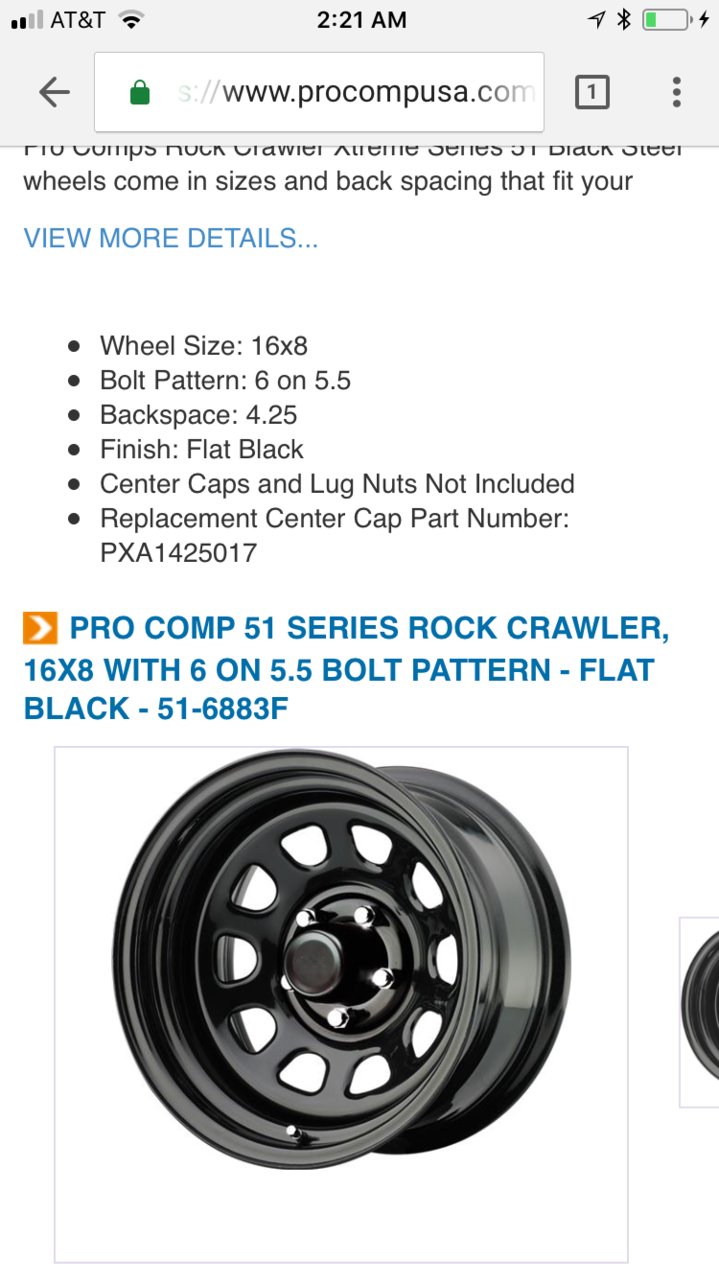

    Anybody know if these fit a 05 Sport 4x4? 8A0FFD44-5EFF-4175-A8DB-0D24F5CCE899.jpg
