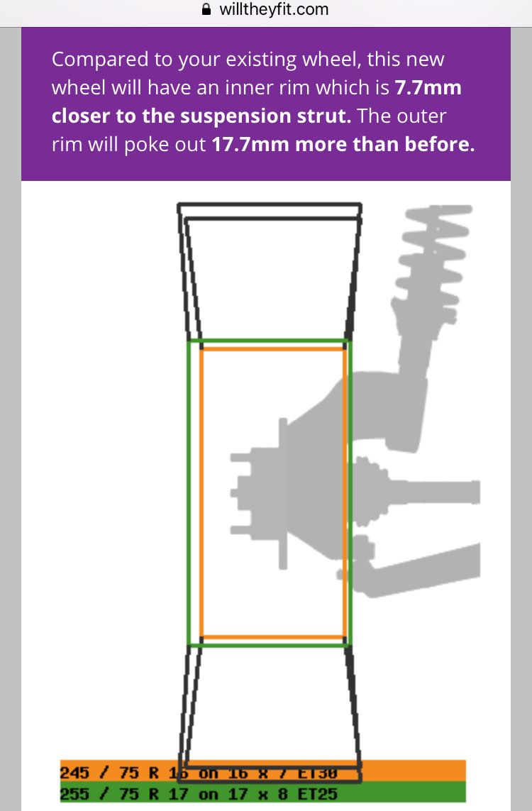

    I am a tire a wheel novice and would really appreciate your help. I have a 2017 Tacoma double cab SR5 4x4 with 245\75R16 tires and want to go to a taller tire and 17" wheels. Will a P255\75r17 on 17X8 with 25mm offset fit on my truck? Will I need a lift? Do I need a wheel with a different offset?

    I’m not sure on the tires, but there are lots of threads indicating what sizes will fit. As far as the wheels, most people go with a 0 offset on 8” wide wheels. The +25 offset will actually bring your wheels closer to your suspension and inner sidewall than your stock wheels. I would suggest a smaller offset. A6EA9031-B126-4724-B27C-1B1A74618101.jpg

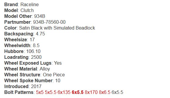

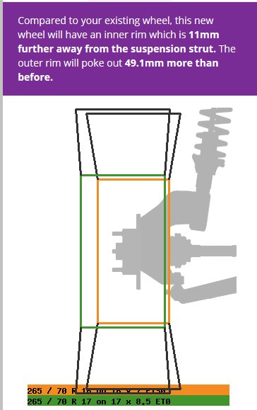

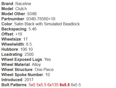

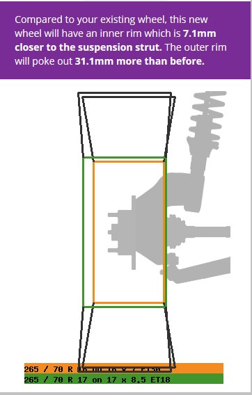

    Would appreciate any input:
    2013 TRD Off Road - Completely Stock, no lift
    Currently Running: 265/70/R16 with the standard 7" Wheel and +30 Offset
    I am only looking to run 265/70/R17 with no plans on lifting or going to a larger tire down the road. Ideally I would like to be flush with the fenders or just a tad outside.
    Looking at Raceline Clutch Wheels, there are two options. Both are 17x8.5 (Specific specs below). Which option would give me the stance I am looking for without worry of rubbing/trimming?
    OR What looks like a 0 Offset
    0 Offset:
    +18 offset:
    To visualize at home would I measure out 1.93" (49.1mm using the 0 offset) and 1.22" (Using the +18 offset) from the edge of my stock wheel to guage where I will be with my fender?
