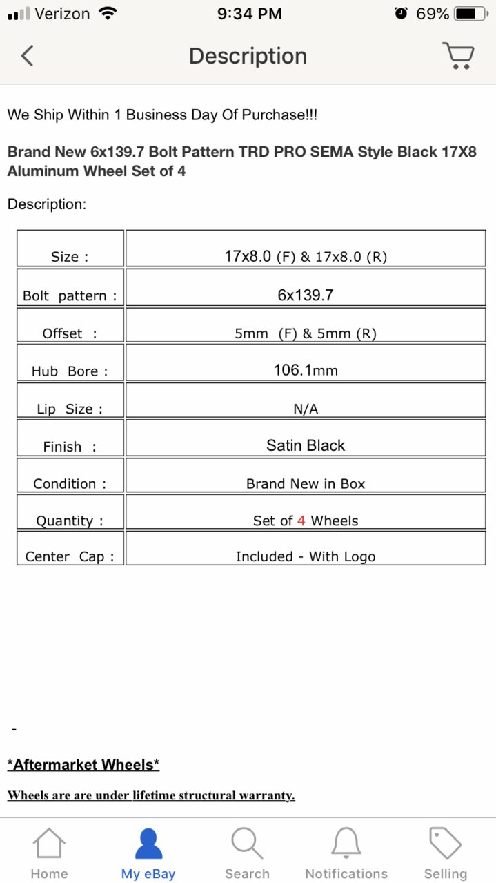

    I’m sorry if this is has already been discussed in this thread but I didn’t really see a specific answer...
    I’m trying to find out if these 17x8 SEMA TRD pro wheels with a 5mm offset will rub on my 2006 stock suspension non lifted prerunner.
    I see a lot of people have these on their taco, but I also know they come in a varying number of offsets...can anyone give me any idea if these will work or not? And any idea about how much they’ll stick out??
    Any info is greatly appreciated, thanks in advance.

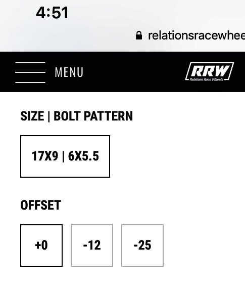

    Can I get some quick help. I’m
    Ordering wheels for my 2012 it has 5100’s all around with OME 884’s for about 2.5” of lift on my access cab. I have the stock UCA’s and it drives great and no rub with 265/75/16 that I have ran a couple years now. The lift was just put on this spring.
    I want to go to 285/70/17 tires with offsets to pick from below which is best suited for my rig? I would like to stay even with the fender flairs or just a slight poke. I’m on gravel a lot and don’t want to beat up the side of the truck.
    Thanks!!
