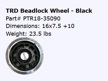

    ok here is an issue I am having.
    the wheels I have-
    the problem I have- rubbingon tire off of new lower control arm dual shock mount with 1.5 spacer
    would this wheel move the rim edge out so no contact would be made at full lock?
    any thoughts would be appreciated
