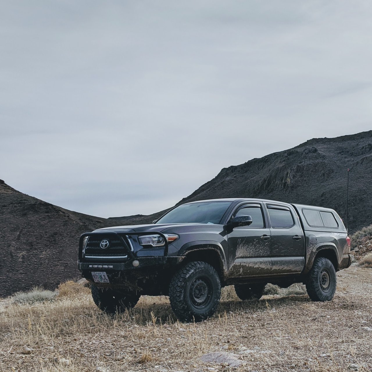

  8. Mar 2, 2021 at 11:48 PM
    #1048
    Logisticz
    Logisticz Well-Known Member
    Feb 19, 2020
    #319782
    90
    Tustin, CA
    2016 TRD Sport 4x4 Blazing Blue Pearl
    17x8.5 -12 offset. 265/70/17 wildpeaks

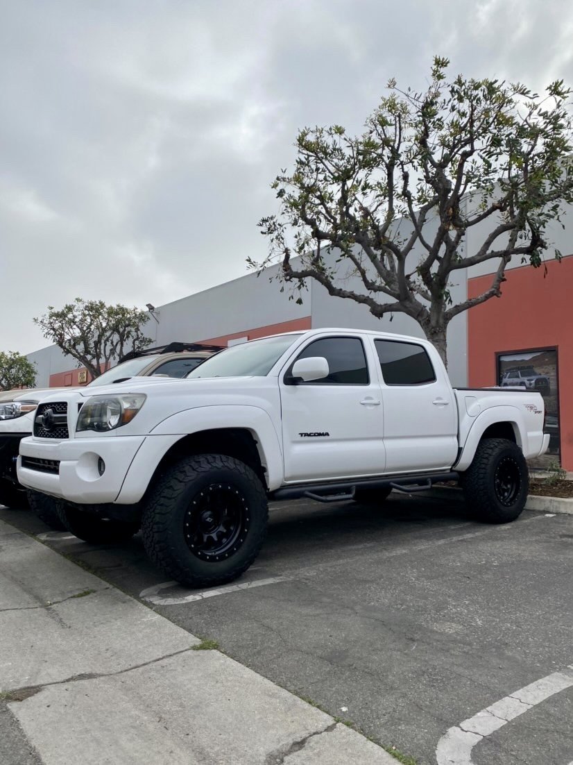

  14. Dec 4, 2021 at 1:15 PM
    #1054
    Tac11
    Tac11 Well-Known Member
    Mar 15, 2016
    #181370
    301
    Luis
    2011 white Tacoma sport TRD
    3" Front lift OME/5100 set at 0, 1/4 spacer on driver side CMC, BFG 285's, SCS ray 10’s -38 offset 1 inch rear block N-Fab steps Bumper Cali Raised LED light bar Cali Raised LED fog lights After market exhaust, and muffler tip Redline hood struts Tacoma Bed-liner mat Tailgate lock Tinted windows 20% HID headlights Short antenna Clazzio Seat covers Joying head unit
    285/70/17 ko2s on -38 offset
    IvanhoeTaco likes this.
