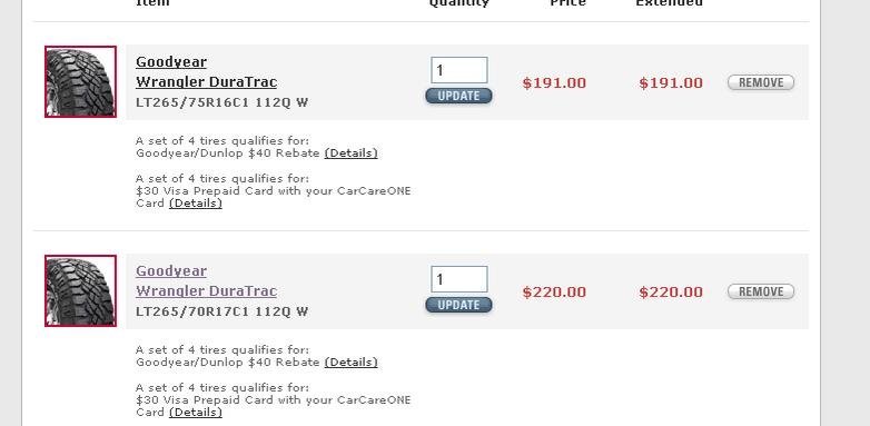

    16" s are just personal preference and yes solely because of price and selection. Granted i think the 17" selection is beginning to increase now. Attached are prices of the exact same tires except rim size. It boggles me to understand how a tire with less material costs more.
    A 265/70-17 is 99% the same size as a 265/75-16. It's your truck so by all means select what's right for you.
