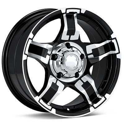

    Bob, you seem to be a good source for this...Please take a look:
    Lift + Wheels/Tire Combination right?
    Getting ready to put on Toytec Ultimate Lift Kit with UCA's and AAL's for 3 " lift on '05 Tacoma TRD Sport 4DLB 4WD.
    Heres the Wheel/Tire Combo I'm looking at now:
    • 16 X 8 Ultra Drifters with 4.88" Backspacing and 10mm offset
    • BF Goodrich Rugged Terrain 285/75/16
    Will this work without cutting wheel wells, mudflaps, or any need for additional spacers???
  14. Nov 26, 2011 at 10:23 AM
    #134
    CrisDe
    CrisDe Member
    Nov 20, 2011
    #67403
    19
    Saratoga Springs, Utah
    4x4 TRD Off-Road
    Old Man Emu 2.5" Suspension Lift,V-Tec Wheels, BF Goodrich A/T KO 285/75/16, Demello Offroad Sliders,Line-X,Nokya HyperYellow Fog Lights, Anytime Fog Mod,Interior LEDs,K&N Airfilter, WeatherTech All-Weather Floor Mats
    i am running 16x8 V-Tec Raptors on my truck but i tried 3 other sets of wheels that, according to the fitment guide should have fit, but didn't. you can't judge the fitment solely on the backspace and offset - it's more a function of the design of the wheel: the the depth of the mounting pad in relation to the angle created by the arms/spoke/plate and where it joins the actual rim. the center line of the wheel can remain the same in terms of offset but the arms/spokes/plate of different wheel models can vary in shape and where they intersect the outer rim. i called Pro-Comp and they said their wheels wouldn't fit my application - yet - i saw a late model taco with 17" Pro-Comps and they fit ( i actually looked at them and examined the clearance).
    some folks will run spacers, some states make that illegal, some will shave down there calipers a couple of millimeters. in the end, the only definitive answer is to fit check the wheels before you mount tires on them.
  15. Nov 27, 2011 at 5:33 PM
    #135
    Irish020
    Irish020 Well-Known Member
    Aug 19, 2010
    #41947
    705
    Phil
    Pennsylvania
    '05 Tacoma TRD Sport 4 Door Longbed
    ARE Hard Tonneau Cover Flowmaster American Thunder Super 50 Series Stainless Dual Exhaust Toytec Ultimate 3" w/ UCA's
    I ordered the wheels. They were on sale for $117/each and should fit from all my investigation....Of course I could be like you and find out otherwise after they are fit on the truck.
  16. Nov 27, 2011 at 5:48 PM
    #136
    Irish020
    Aug 19, 2010
    #41947
    705
    Phil
    Pennsylvania
    Here's a picture of a Tacoma with another Ultra Wheel with the same Backspace and Offset.....so should fit....

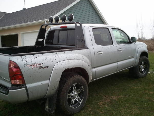

    Found another Tacoma on here with the Ultra Drifter Wheels!....
