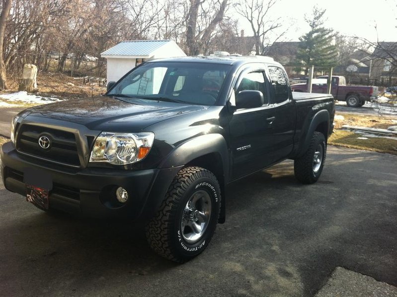

    Another new guy here but I have already put my wheels on. I had read about fit issues and did my homework so I thought I picked up a set of AR Ventura 16x8 0 offset and 4.5 BS I believe. They had used bfg ko 265/75/16's on them no rub issues but no off-road tried. I put new rubber on (the same tires). I have a stock base 08 4x4 the caliper clearance seems pretty slim not at hub but by the spokes I was going to make some .06 shim to space them out we have a water jet at work but have already widened stance considerably looks awesome but am I hurting my front end doing this she is still my daily drive.
    I will have to put up some pics nothing fancy.
    Thanks
